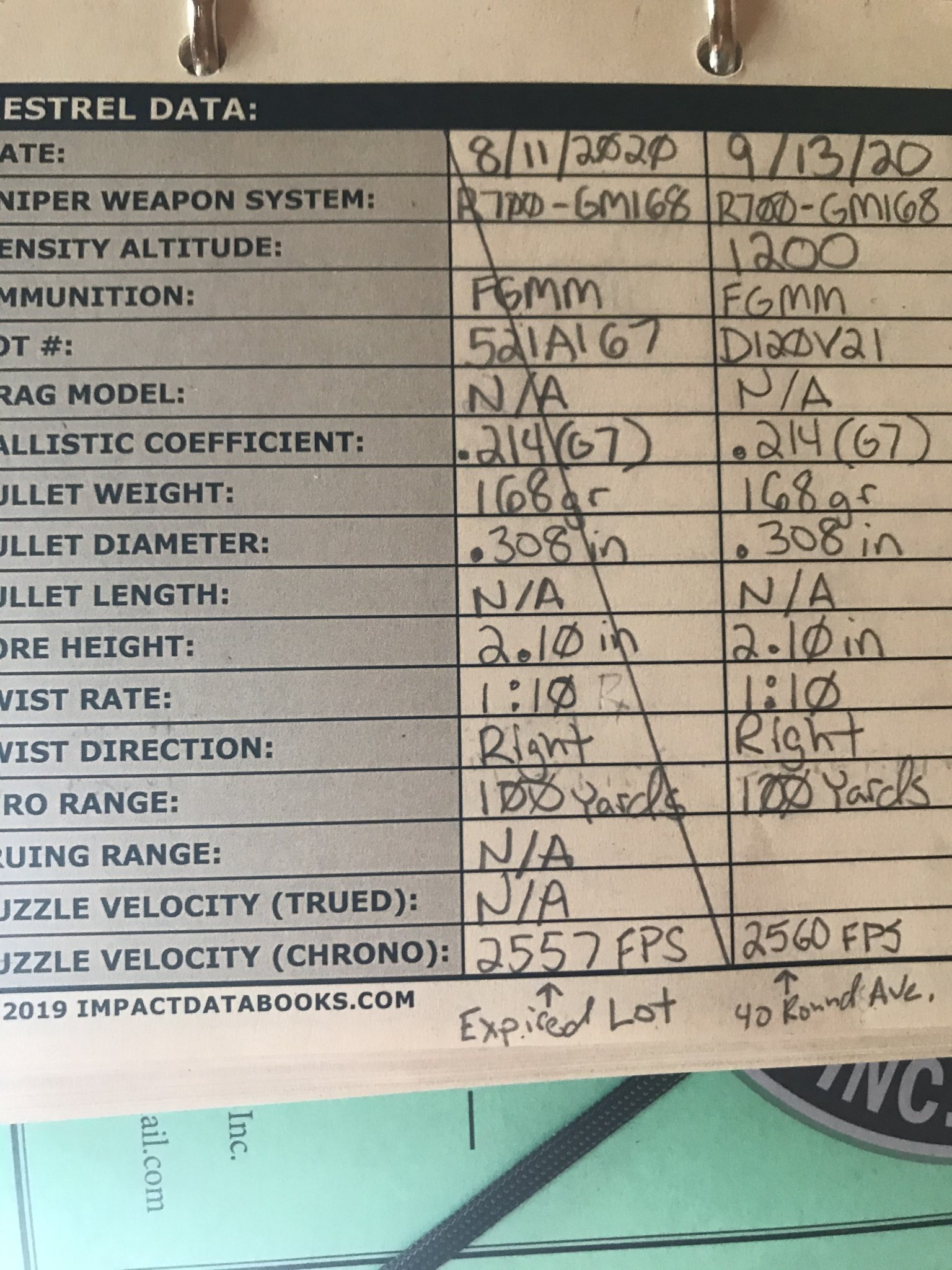

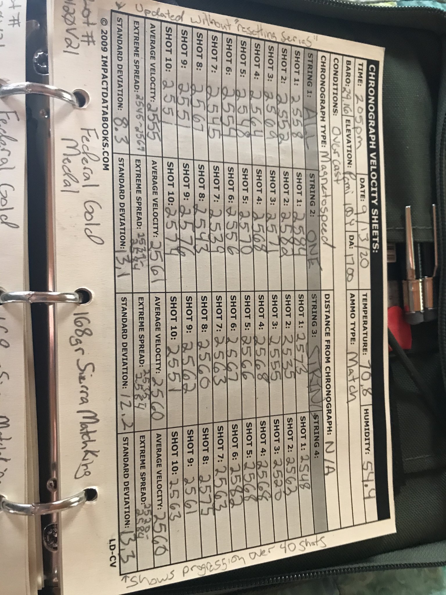

The Kestrel Page is LD-KDS... the other page I’ve found useful if the chrono ones
