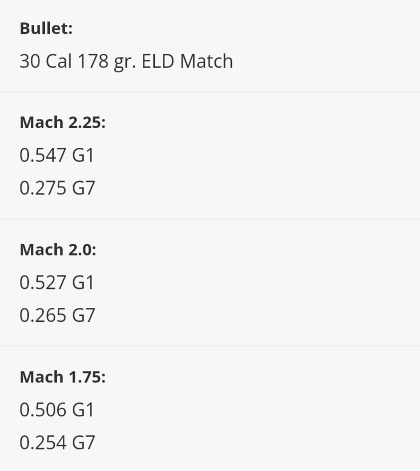

Yesterday I was at the 1K Range with a proven Rifle/Ammo Combo, and was using the Kestrel Elite als Solver instead of Strelok Pro.
But I was way off target at 1K, with the Solution of the Ketsrel. So I started calibrating (more accurate: Bending) the Data, until I started to hit again.
Today at Home i started to compare, and realized that the Data in the Applied Ballistics Database for the
.30 Hornady ELD Match 178grs is wrong. Even the G7 BC is over Hornadys Claim.... I cannot look into the custom drag curve, but the solution compared to a stepped G7 Solution in Strelok Pro is way off.
This is already the second time, because I´ve had the same issue with Hornady´s ELD X Bullet in AB´sr Database, which was corrected.
Long Range Shooting possibilities are rare in germany, and it´s a real PITA, when you realize, you´ve wasted a day of precious range time, and a lot of ammo. All because the "Most Advanced/Accurate ballistic solver on the market. Trusted by Professionals" gives you wrong data.....
Please take care of that.

They might be using box numbers instead of Hornandy’s listed lower Mach numbers which are closer to actual BC’s at long distance.

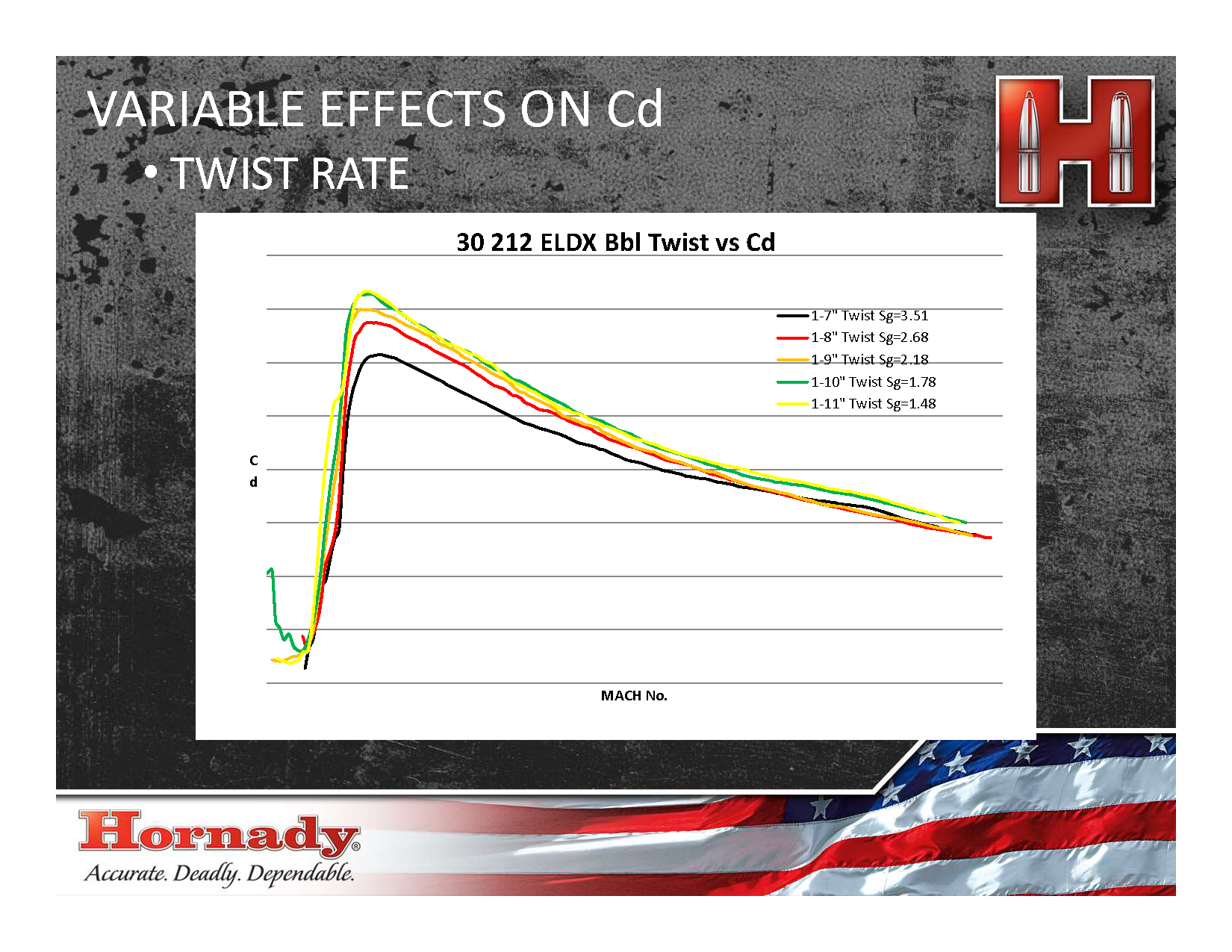

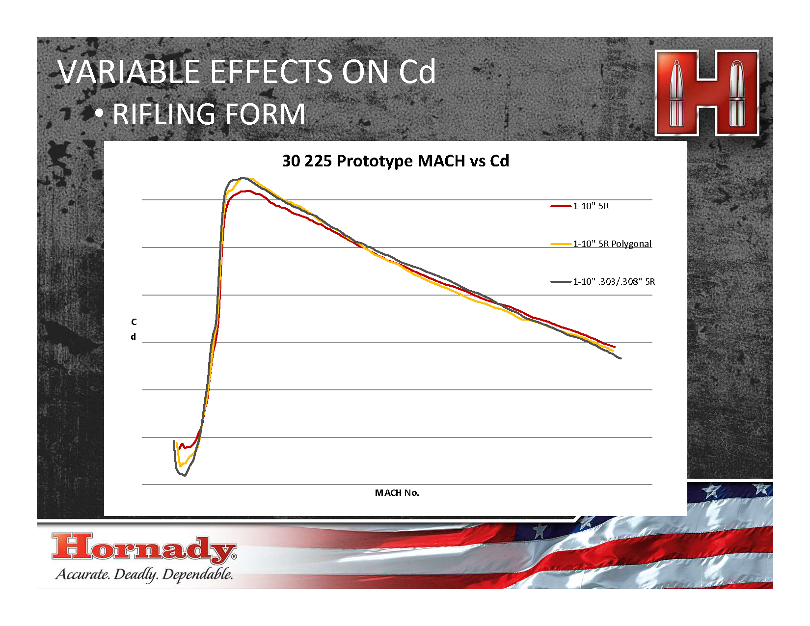

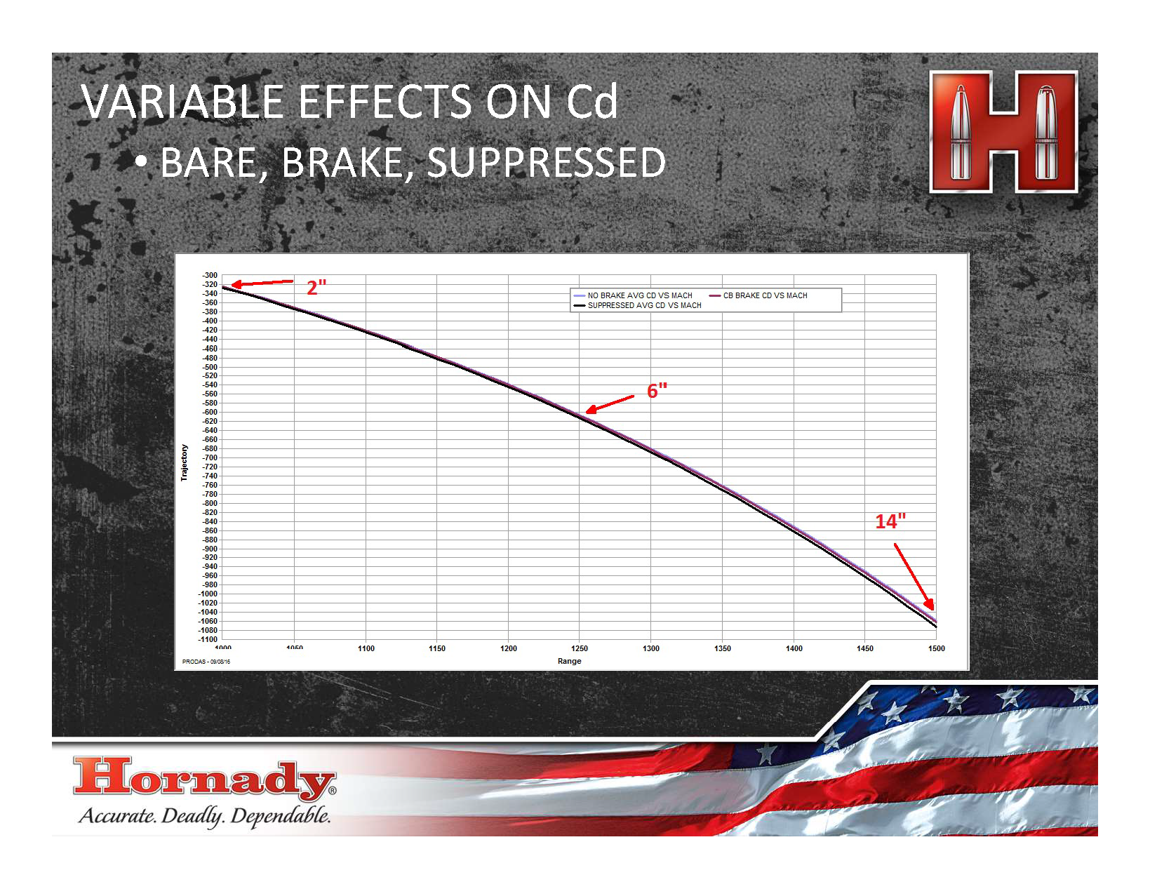

"Even BC reduction because of understabilisation is a result of Velocity, Spin Rate and of Course Bullet Form/Shape/Weight.... "
Internal Ballistics do matter and Hornady has been putting out data demonstrating the downrange changes they see via Doppler Radar
7120239
7120241
7120243
Other elements also have a factor
7120252
7120255
There is more but I believe this makes the point. it even shows powder difference and it's effect downrange.

Hello! I have the same issue with .30 cal 178 ELD Match bullet. MV is 836 mps, twist rate 1:12
Sight height 6.8 cm
I've bought several CDMs 178 ELD Match included. I've bought Kestrel 5700 Elitewith AB, but my dope donot match neither CDM , nor G7 BC 0.276
Rem 700 .308
MV is 836 mps,
twist rate 1:12
sight height 6.8 cm
temp +18
Rh 77%
St pressure 986 hPa
wind speed 2.0 mps
wind angle 8 clock
my real dope is
500 m 3.3 mil Kestrel 3.20
575 m 4.0 mil Kestrel 4.06
640 m 4.9 mil Kestrel 4.86
730 m 6.0 mil Kestrel 6.08
800 m 7.1 mil Kestrel 7.12
837 m 7.7 mil Kestrel 7.71
930 m 9.6 mil Kestrel 9.31 don't match
If I try to true MV to 825 mps this dope (930 m) match, but all above don't.
How can I fix it ?
Sorry for my English
You have to adjust the MV as they said above,
A CDM is still based on "their" rifle, and how it shot that ammo, this is not tuned to you, or your system, it's still an average.
A CDM is not a magic fix, you true with the MV if it does not line up. BCs are fluid, they are not a set in stone number, neither is a CDM. Your system is still your system and is not what they used, nor do you shoot like them, which software does not account for the biggest variable we have, US ... the shooter.
Ya, it won't match until you true it...
maybe it's the language barrier, but you have to adjust it to match, nothing is going to match out of the box
The software only has the ability to adjust it via the MV, so you have to change that to line up.
It always requires an adjustment, when it doesn't consider yourself lucky, but 90% of the time you are adjusting the variables to match even if that variables are no longer in line with what you recorded.
If you adjust your MV down 75fps (or in your case m) the 930m will likely be close to matching
Create 2 profiles? One for short range one for long range?
sorry for my English
I did not know it
825 mps (2706.7 fps) in my case
If you just used the BC instead of the CDM you could balance the curve and adjust both, which makes life easier.
You adjust the MV at 600 to line up those numbers then if you still need a tweak for the further ranges you adjust the BC number. MV changes the short ranges, BC helps adjust the long-range numbers without corrupting the short-range data.
So MV at 600 and BC at 800, this adjustment usually keeps things tuned, even when traveling beyond 4000ft DA.
thanks. I'll try it.
Hornady ELD Match 178 gr from Applied Ballistics library
CDM and 0.275 G7 BC are wrong.
{PDM} Hornady ELD Match(237) and 0.262 G7 BC are correct
Multiple BC is correct
