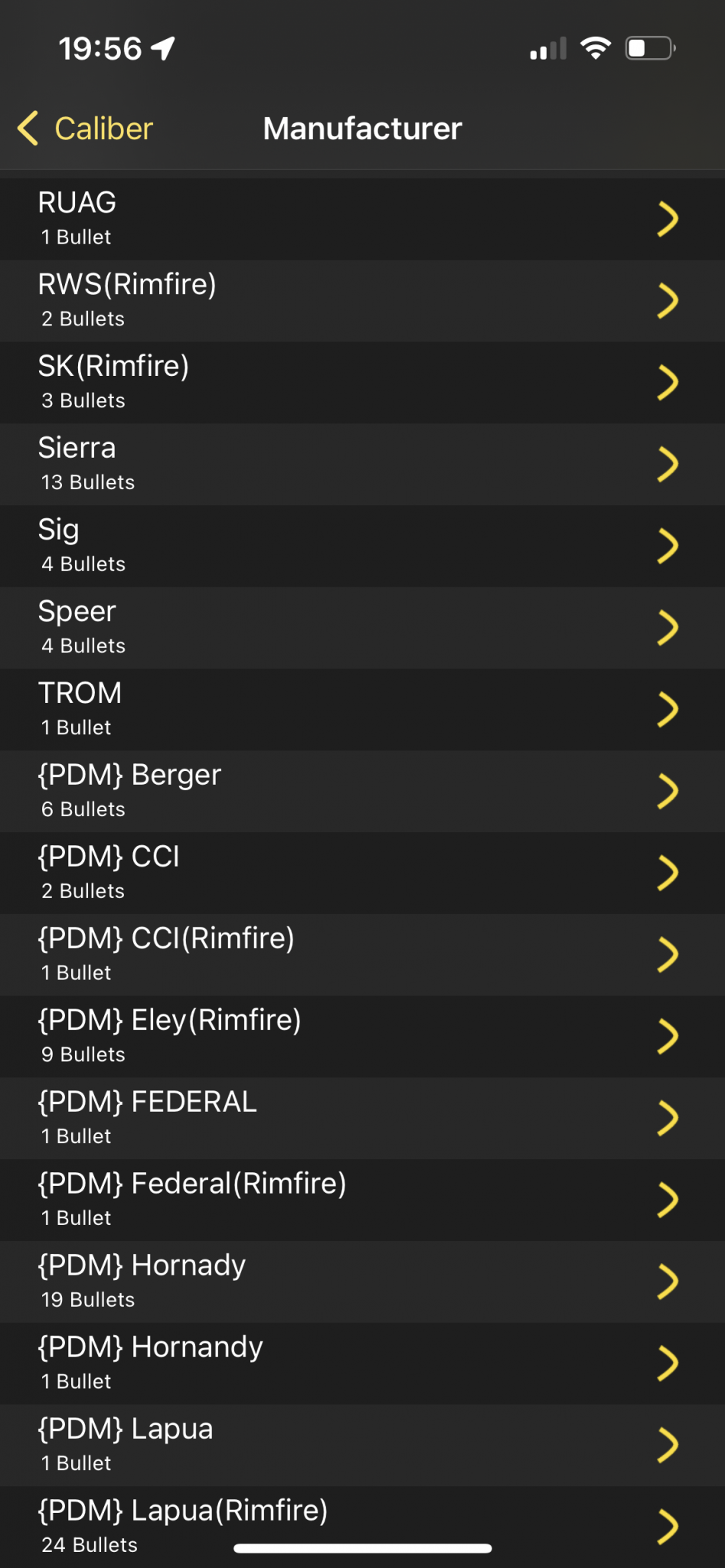

Does Applied Ballistics have any rimfire data or custom curves for rimfire?
I use a Garmin 701 and use Garmin Profile loader to load the 701, but can't find and rimfire bullets in the database?
Or am I missing something?
Cheers

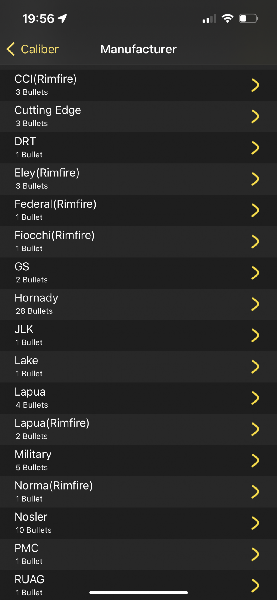

These are some of the 22 LR profiles listed in the Kestrel app for the 5700 Elite. I don’t have a 701 so no help there.
