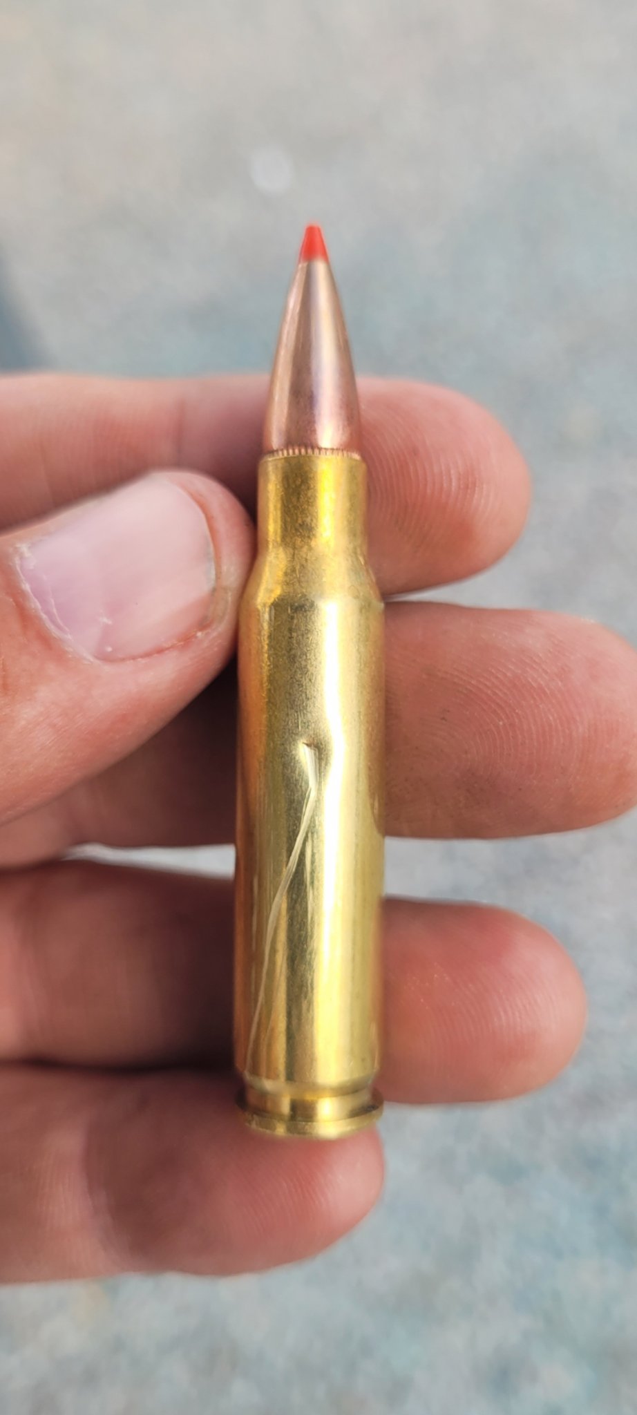

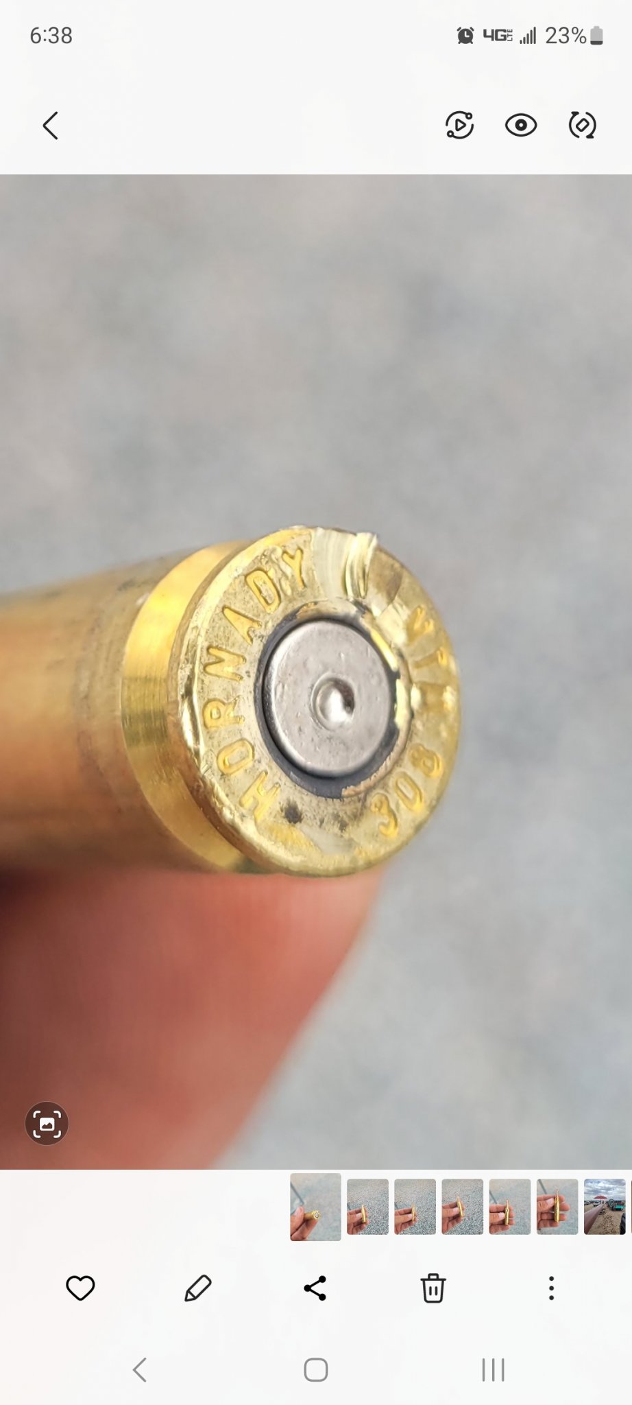

PSA model .308 will fire a few rounds without malfunction, then double feed, obviously damaging the rounds. Prior to malfunction, the brass is ejecting a considerable distance at approximately 1 to 2 o'clock. Also, there were brass shavings around the extractor where it has been ripping off a small piece of the cartridge base. Factory Hornady ammo, no gun show re-loads, mags appear to be ok....where should I start? Heavier buffer and new spring? AGB? Trying to hit the nail on the head the first try so I'm open to any and all advice. Photos of casing base as well as rounds damaged by double feed are attached. Thank you.

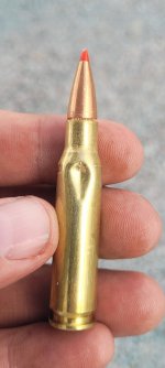

Pic or better description of exactly how the malfunction is when it stops? Is the empty case still in? Is the bolt riding on top of these damaged cases? Etc.
But if it is new, before I changed any parts, I would start with different mag and or different ammo.
What gas length? Shooting suppressed?
From you ejection description, it sounds severely over gassed. Your case heads also indicate early unlocking, usually due to too much gas.
AGB and heavy buffer would help.
If that is factory ammo something is very wrong the primers are leaking.
Is this a factory gun? barrel length ? gas system length? AGB?

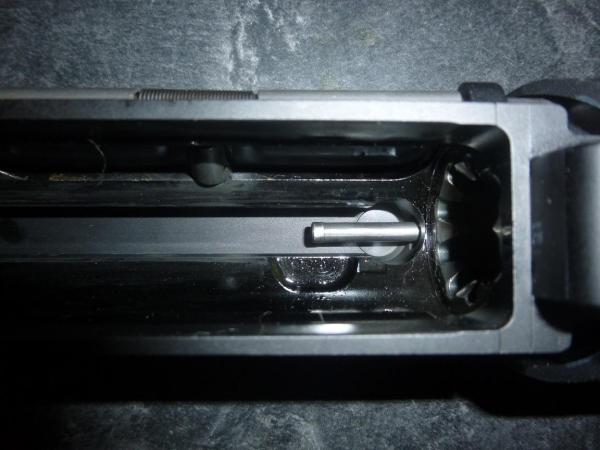

Also-unload the gun, lock the BCG to the rear, and turn it upside down. Looking through the magwell see where the end of the gas tube is. It should terminate at the halfway point of the cutout for the cam pin. If not, then this is also a problem. See attached pic.
If it still doesn't function AFTER ALL THIS IS CORRECTED, it's time to get an adjustable gas block. If you do the gas block first, it will tend to cover up all these underlying problems and you will likely have to continually adjust the gas block to keep the gun functioning between different ammo types. Your goal is total reliability at this point.

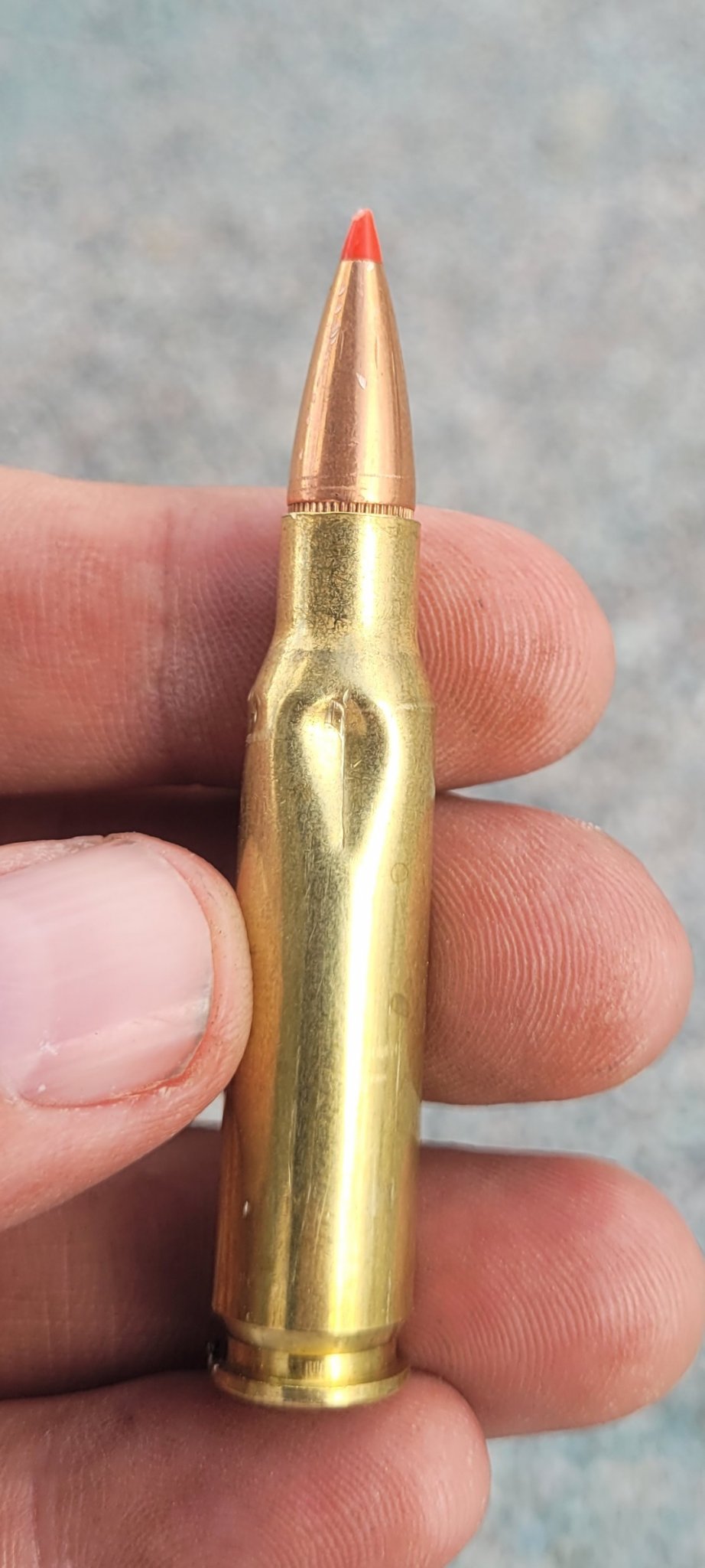

The dents on the cases being chambered. I can only imagine they are getting rocked on the center lug cut out at the 6 o'clock as they feed into the chamber. Sharpie color the entire case and see where all it is hitting on its trip from the mag.
Obvious it is over-gassed. You should install AGB. I would use a bleed off AGB like Superlative Arms. I've tried to tame down several over gassed, too large gas port diameter, with restrictive gas blocks, but to no avail. The bleed off SA have always worked better. If the bleed off style doesn't work then you are SOL. The gas port must be so large nothing can help.
I like to use a 5.3oz buffer, AGB, and tune it so it spits the casings straight out 90 degrees to the side. 3'Oclock. About 4-5ft.

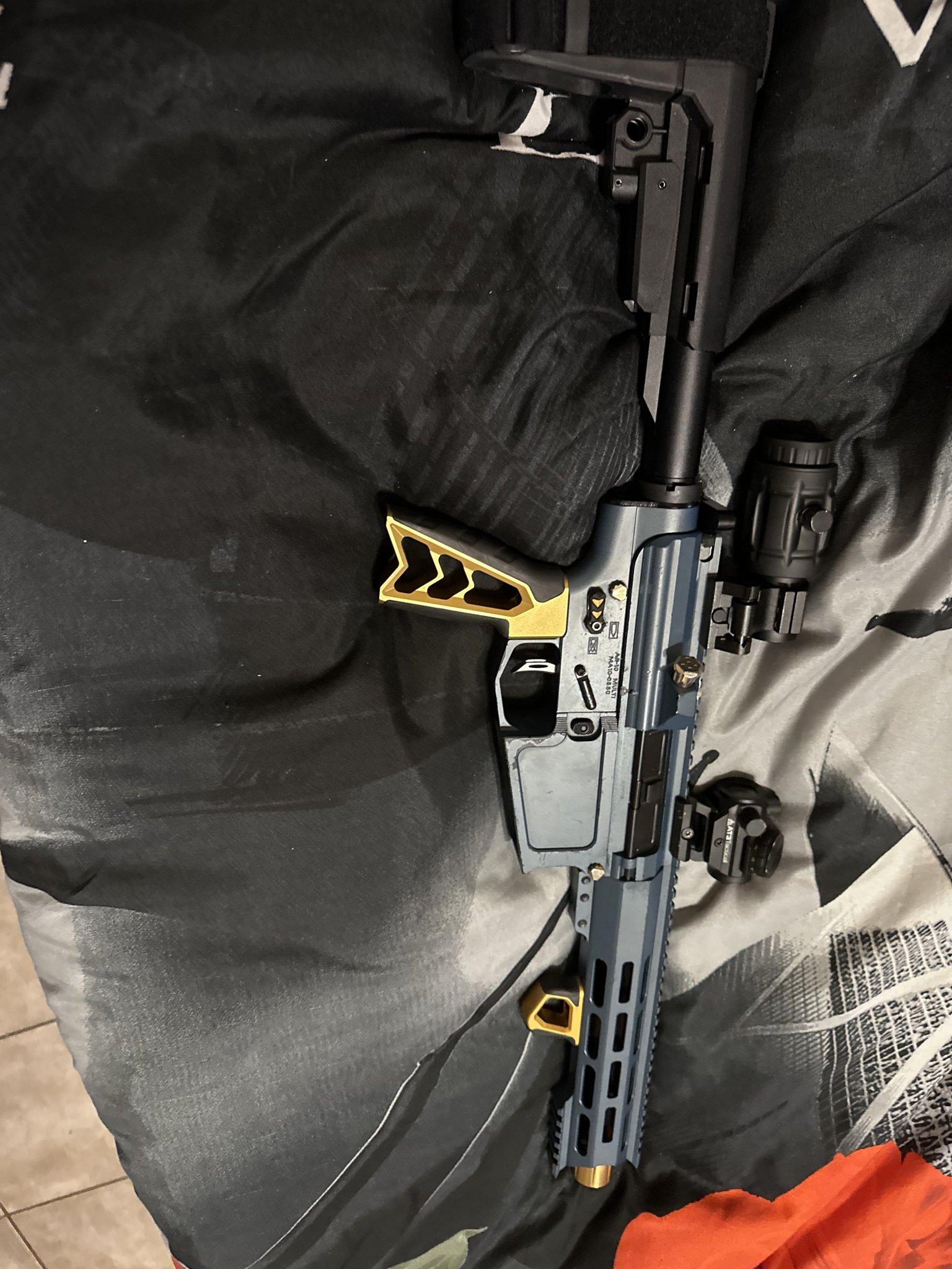

I need help!! First got the gun it was firing with no problem, the second time I hit the range every time I fired felt hot air hitting my hand, so checked it out and the gas block came loose like playing a trombone. Fix everything back everything went wrong from there! I am getting double feeds!! I shot the gun a coupoe
Weeks ago with no Mag and shell failed to extract like not enough pressure pushing back. I have ordered a superlative arms adjustable gas block, changed all the parts in BCG, Changed the buffer spring to armaspec stealth recoil spring idk which Gen, and a spikes tactical gas tube! Need some help or some tips...

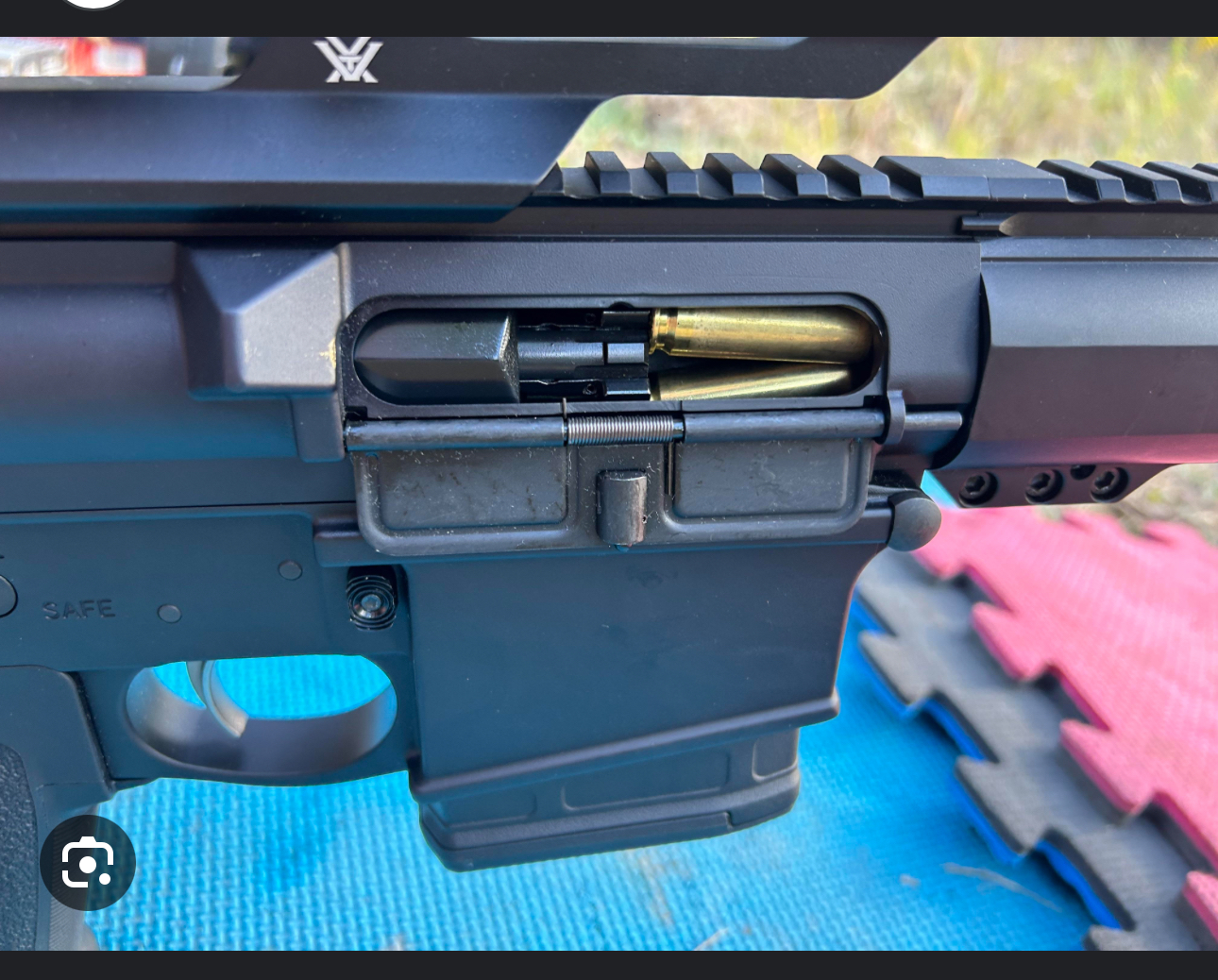

Wasn’t a good photo but as you fire shell fails to eject and loading live round aswell.

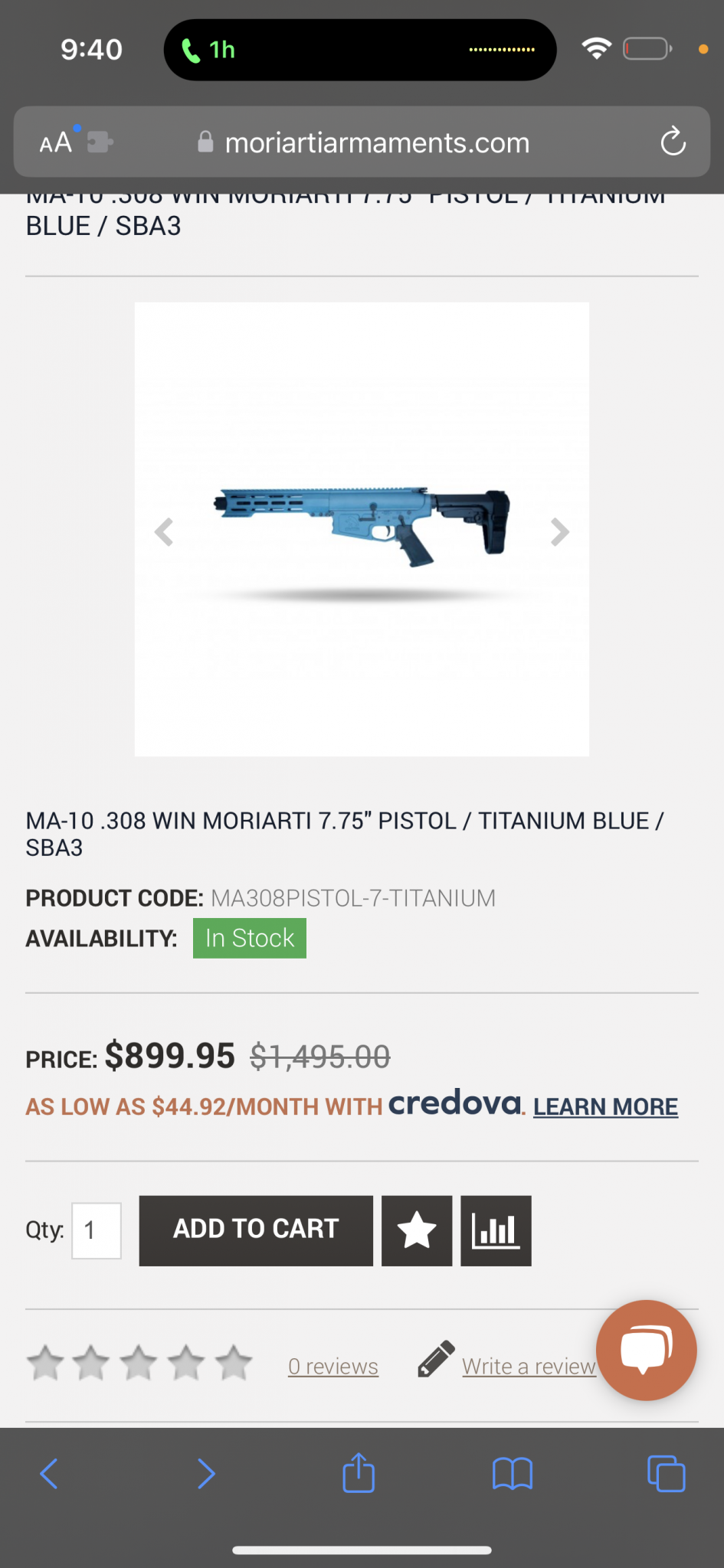

@Makinchips208
AR 10 DPMS .308
7.75 - Added inch barrel adapter to clear handguard
Gas tube Pistol length
Brass around 147 - 150 grain
Wolf steel Ammo 147 grain I think
I used Hornady Black unsure of grain- Ran 5 rounds perfect then jams started again
Did one specific type of work? Don't understand what you are asking!

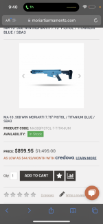

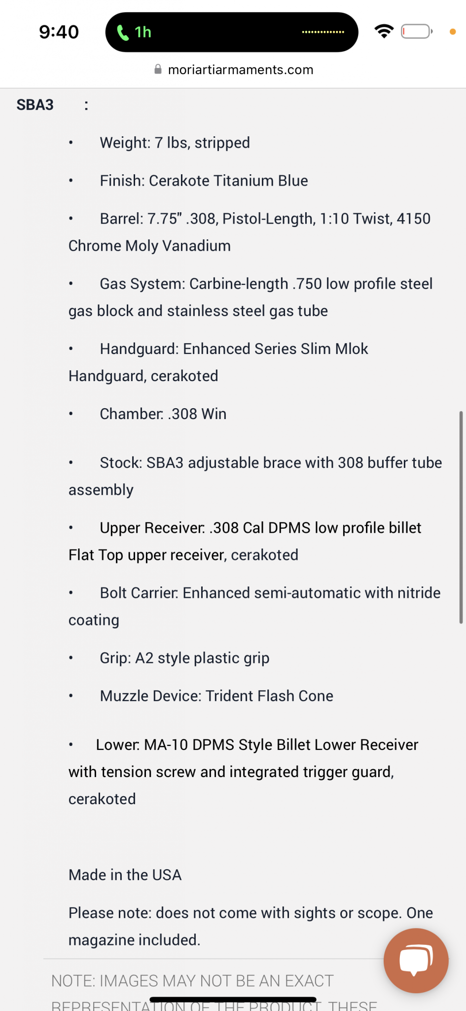

Company: MORIARTI ARMAMENTS
Didn't do research before i ordered, but it's damn shall not a good company. I thought it was a sweet deal at the time horrible customer service, gun was sent in bubble wrap to gun store smh!

AR 10 DPMS .308

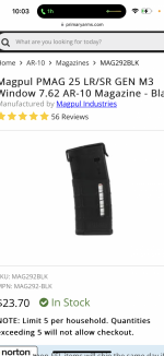

So, i had luck when I had around 5-7 rounds in the mag would fire them all without a jam sometimes pretty sure was brass. Full mag nothing but jams. Mag holds 25 rounds, but still would Jam with a low mag as well. So I'm going to order a new Mag shopping for one as I text this, I
Magpaul with the window that show rounds came with the gun! But I don't think that's the problem, so I bought an adjustable gas block I'm thinking that's the issue and changed Gas tube

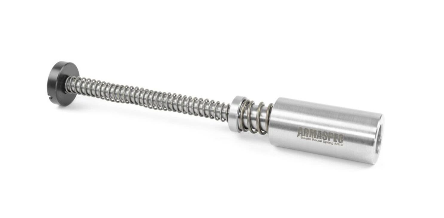

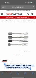

Oh yeah so when it started double feeding I changed to Buffer spring to
ARMASPEC STEALTH RECOIL SPRING BUFFER ASSEMBLY​
Same issues

Also, if you bought that Armaspec SRS that you attached a pic of, you bought the wrong one. You need the AR10 version. SKU for that is ARM253-AR10 and it looks like the pic below. Look at the left side black spacer, it's a thin one. If you got a thicker black spacer there, you definitely bought the AR15 version.

And you said double feed? Do you mean that the fired case is not ejected, and the bolt jams up on top of the next round in the mag?
And if you had a few rounds of success, and the new buffer didn’t fix it, then I would reinstall the original, so as to not introduce more complexity to the problem.
Added a photo and yes double feed Empty on top of live round and BCG trying to load both. I haven’t shot 50 rounds through it so didn’t think to check the Gas tube. All my guns are well lube soon as I make it home from range and ready to run my all My AR are a lil wet. But I have been reading up on it for a while and read a lot of ppl have problems with short AR 10’s.

It does appear the bolt is Behind the case of the new round, as it should be. Am I I correct on that observation?

Ok cool. Maybe the new buffer helps then.
Also, maybe there is possibility of the extractor spring being weak? It should have hung onto the fires case until the case started to swing out the ejection port.
No that's a double feed I found online but it looks exactly like that, I change all parts on BCG now haven't shot it yet, waiting on new Gas block and only hold up! You think the Adjustable gas block would help?
Yes once I changed to stealth spring it was firing well with low Mag, reinstalled the old spring, and never got more than one round to fire.
Aligning gas block I watch YouTube videos making sure I was doing it right, it's a dimple on the barrel I aligned correctly and screwed it back in I was gone locktite once it fired reliably, but never fixed the issue so didn't think to check the tube thought maybe it was the gas block! So I ordered a new tube and block in route as we speak!
Due to your barrel/gas system length, I would contact Armaspec just to verify that they don't see any problems with their SRS and your set-up. Can you measure the length and weight of the original buffer? I personally would be going with a conventional action system of extraordinary weight.
Since you have a Superlative on order, I would hold off on doing much until it's installed and tuned. Your window of proper function will be fairly small, so pick a specific ammo and stick with it through your tuning process. If you get a chance, measure the diameter of the gas port. If it happens to be under-gassed, which I doubt, an AGB cannot increase, only decrease gas flow.
What would you suggest when getting a new buffer tube spring on a pistol length system? I like the silent systems that doesn’t like a spring!

The gas port is on the barrel. Technically, you would measure it with pin gauges, but most people would not have those, so you use the shanks of a numbered drill set and measure the tightest fitting shank with a micrometer or caliper.
I was asking about the original buffer, not the spring. It might be 3.25" long, but most likely 2.5". Measuring the internal depth of the receiver extension (buffer tube) would also be helpful for reference and future suggestions.
