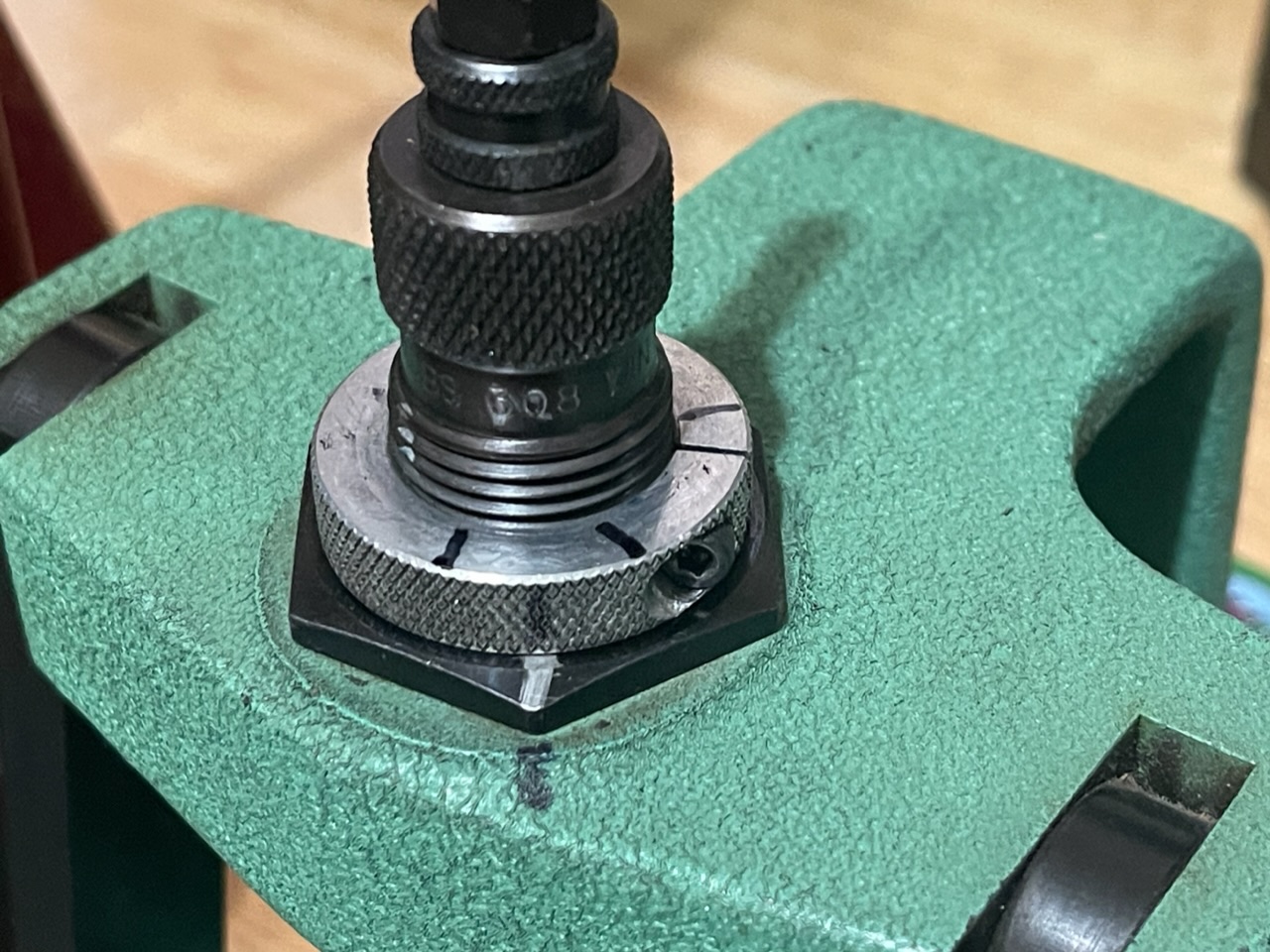

FML.. I'm fairly certain it was all just shoulder bump. Took a few minutes to reset my dies and set the shoulder bump to 0.005" and loaded up a few rounds of the offending Lake City brass cases. Loaded them up in a mag and they went in smooth as butter. I'm guessing my lock ring on the FL die wasn't tight enough and the die slowly backed out over time. I'll have to start checking headspace redundantly as part of the reloading process because I think that this has been an issue in my .308 loads for a while. The previous chamber on the last barrel likely had some room so I never noticed.

Simply index your dies so you know if/when they back out. Each hash mark represents roughly .002-.003 thou in bump:

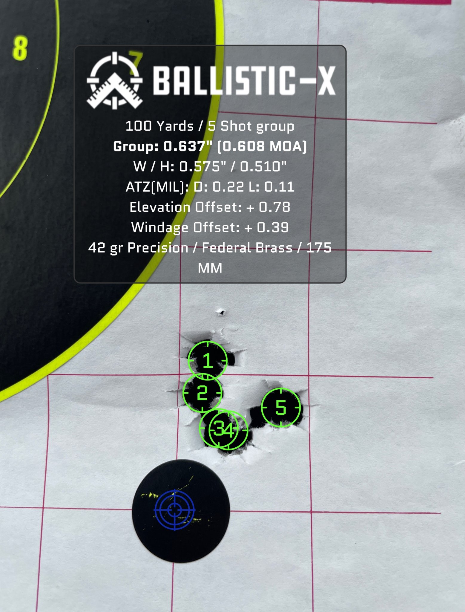

Reset my die to bump the headspace .003-.004” and ran 50 rounds. Ran all of them without a hiccup and printed a few decent groups with the new barrel. For an AR10 I’ll call this good given my ability
Out of curiosity - wondering what other guys are getting for muzzle velocity on 20-inch barrels or similar. The above group was the best group I shot so far, so I'm inclined to stick with it BUT velocity was 2,480 fps which seems a bit slow for a 20-inch barrel.
I'm wondering if I should explore AR Comp, 2000 MR, or maybe even 168 gr SMKs to try and pick up velocity. I know Shooter's World Precision tends to run slower than Varget, but I wasn't expecting to be below 2,500 fps. That said, this load performed very well at 400, 500, and 600 yards and I don't think I'll ever take this rifle beyond 1,000 yards.
