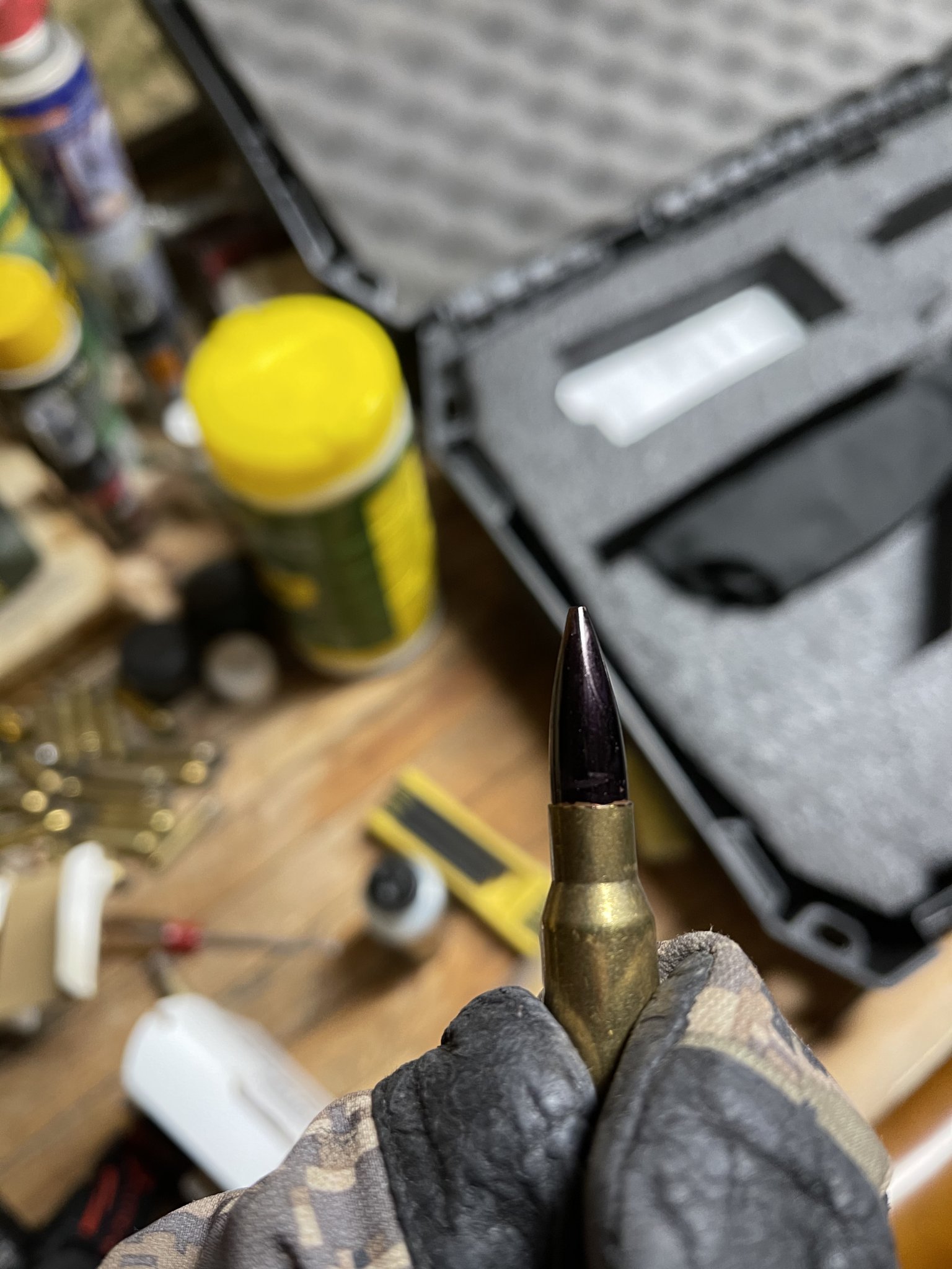

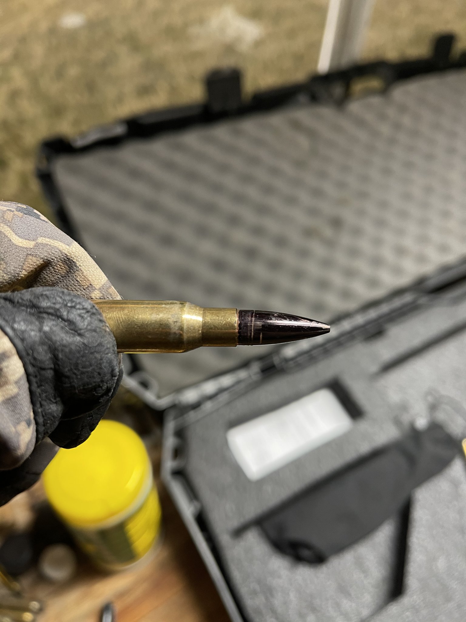

for some reason bullets are now getting stuck or fitting too tight in the chamber.
a couple things: when I first bought the gun, the bolt would engage and dissengage from battery incredibly easily. The smoothest I have ever felt. And now it isn’t nearly as smooth. Kinda hard to engage and dissengage it.
when I first got the gun, I ran it pretty wet with frog lube, but started running it dry after the frog lube Would get cold and gunk up.
but I have tried 5 different ammos with It:
2 types of trash factory bulk 168 7.62 and both run well and don’t stick in the chamber at all.
Sig Elite match 168 ammo, this ammo sticks in chamber worse than it should, but still able to eject.
168 hand loads. Stuck horribly, left a scuffing at the base of the bullet.
Federal Premium Gold Medal 168. Stuck so bad in chamber it literally unseated the bullet from the brass and got powder everywhere. This happens every time I try the ammo.

Your chamber pressure has to be pretty high if the bullets are engaging the rifling before firing. Good advice was previously given to send this back to your smith and resolve that issue.

In think that a chamber cast might show up a short throat.
If the round stuck, then the case came out, but the bullet stayed and spilled powder; it sound like the bullet is seated long enough to jam in the rifling, or that the throat is short enough to catch a factory length bullet's ogive.
We had very similar problems with Savage factory 308 chambers in the 1990's and learned to seat the bullets deeper. For starters try seating the bullet a bit deeper.
Have a good smith check the throat length, and maybe extend it a little, if it registers short.
The scuffing at the case wall bottom may be a second problem, and might respond to a small base F/L resizing die.
Check the first firing handloads as they come out of the die now. If it's there before chambering, it's likely normal. If it's there before the first firing case is resized, the small base die is likely the answer.

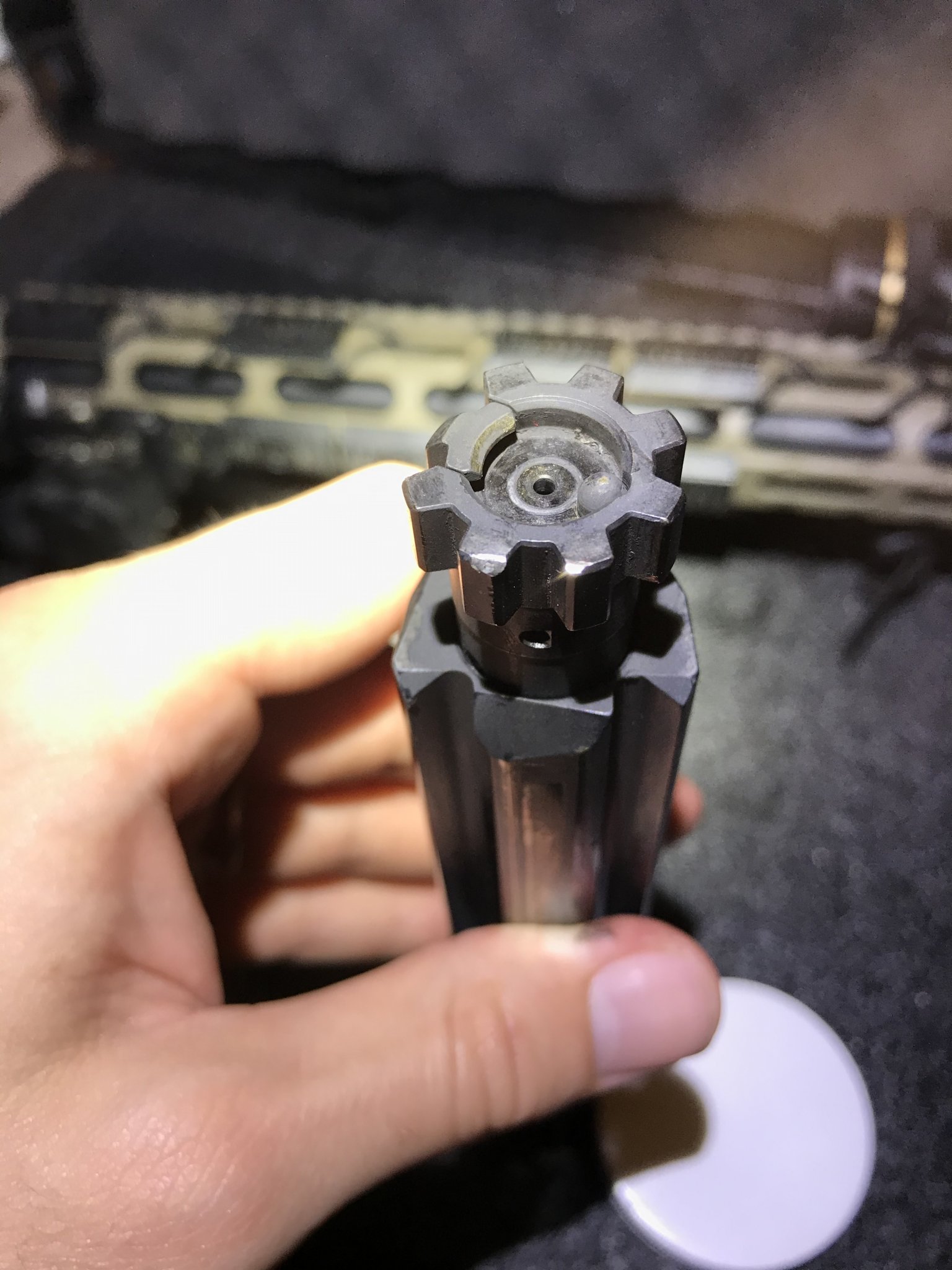

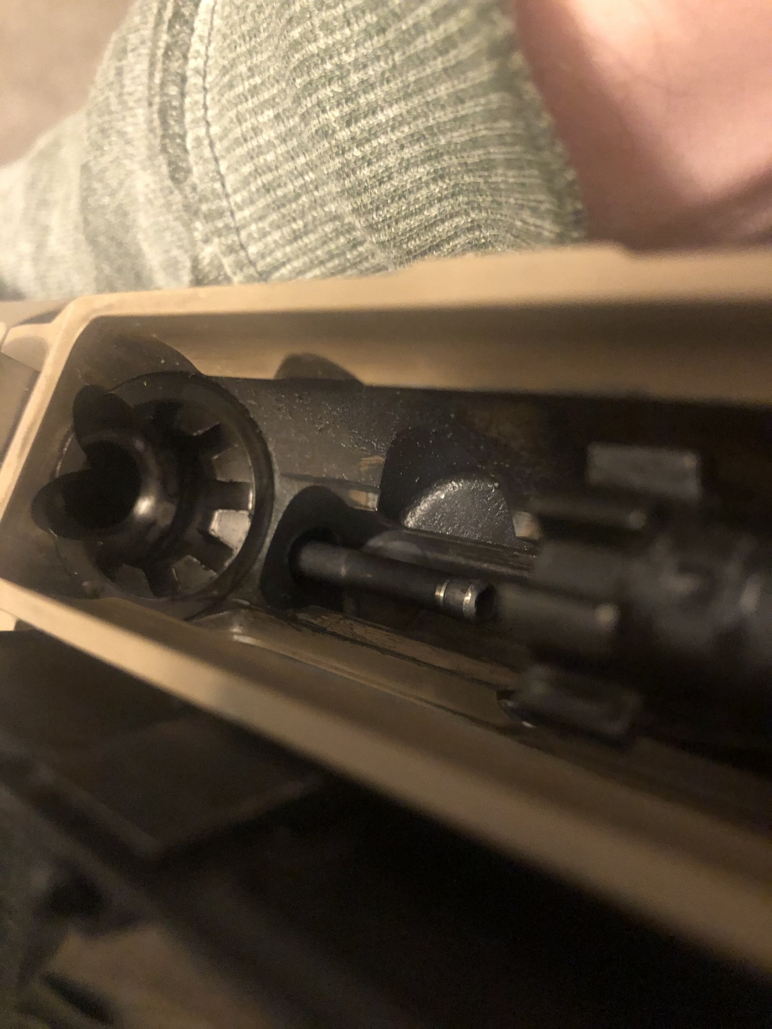

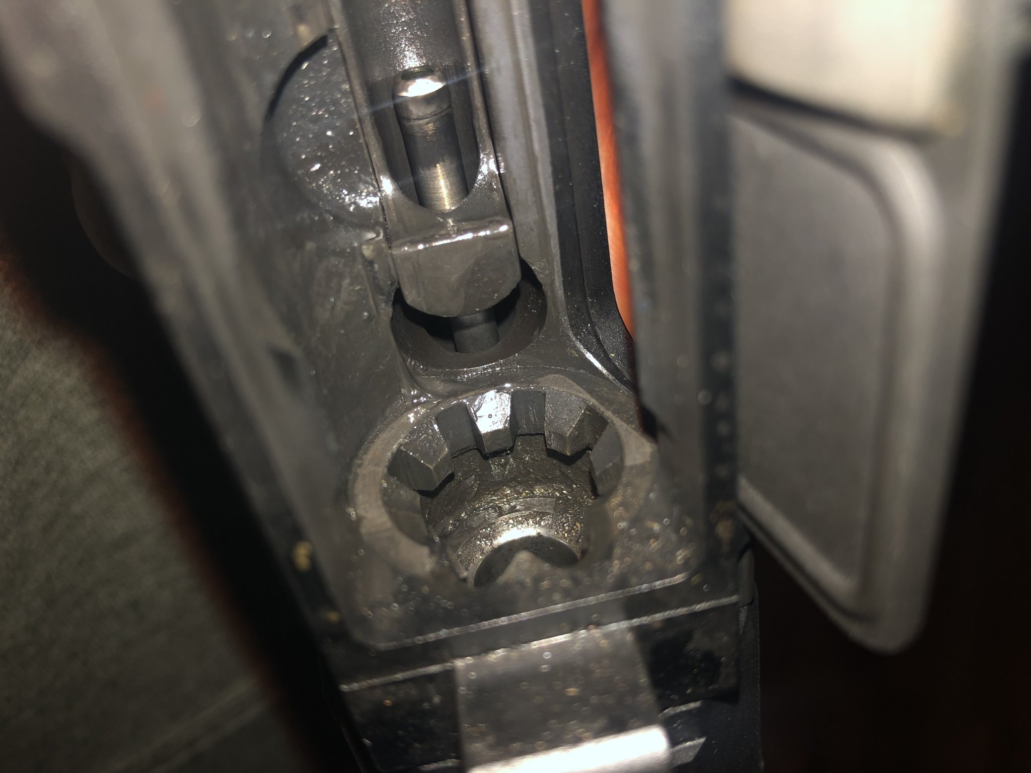

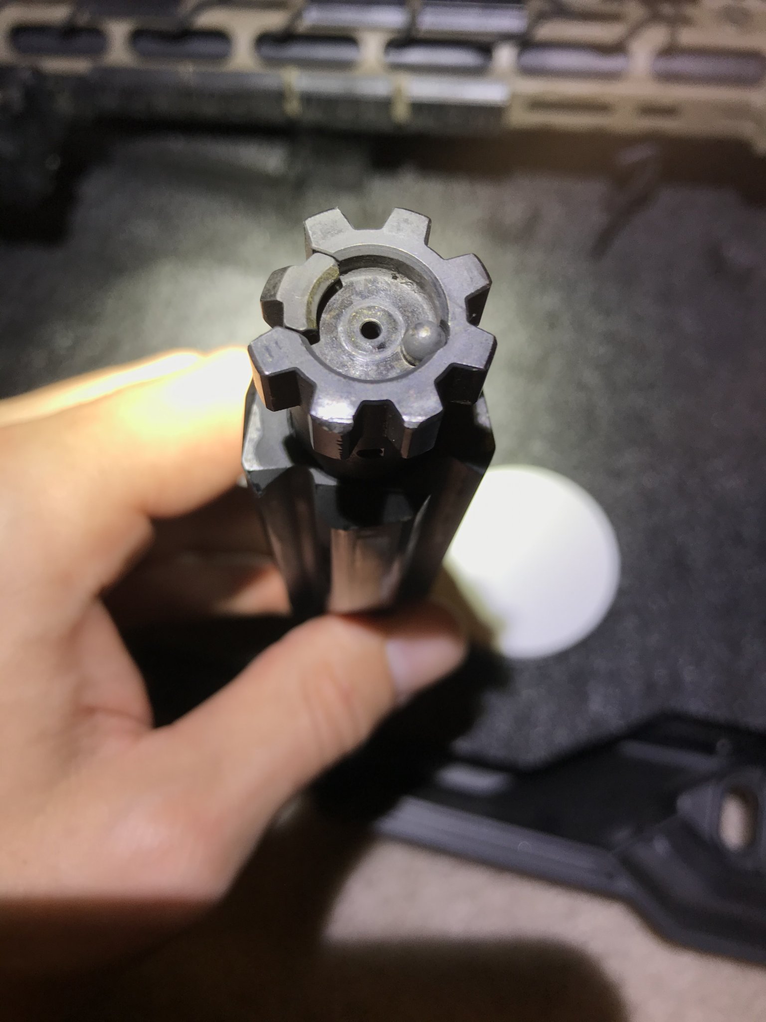

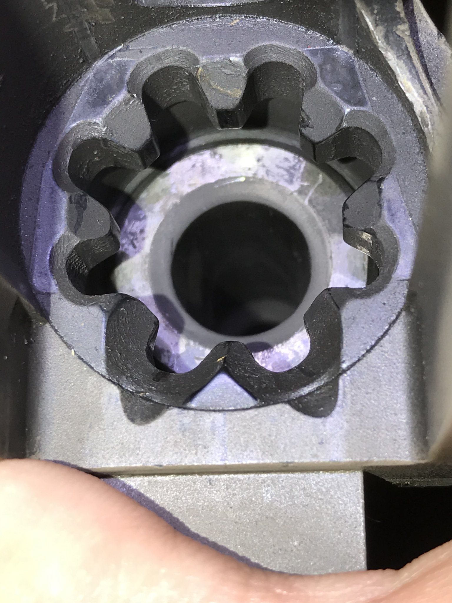

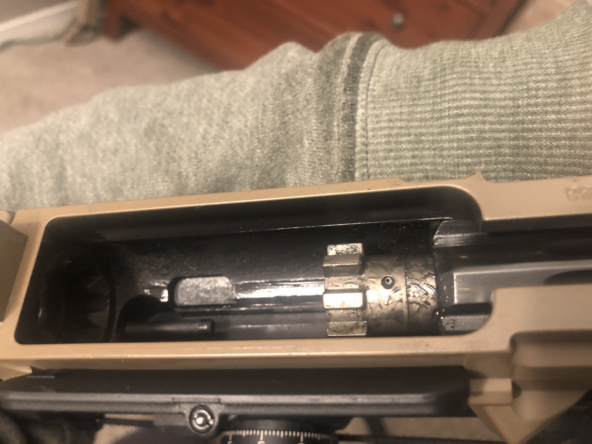

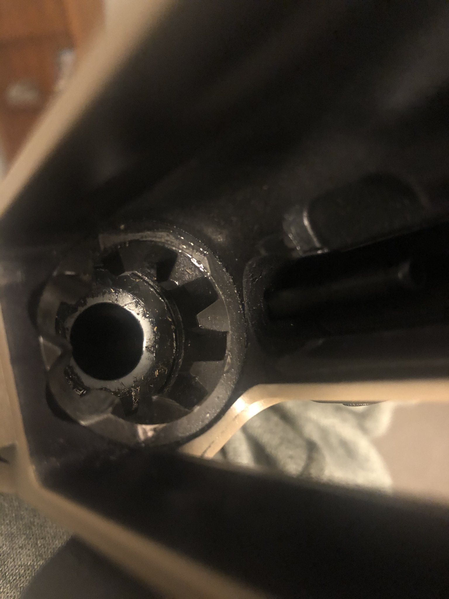

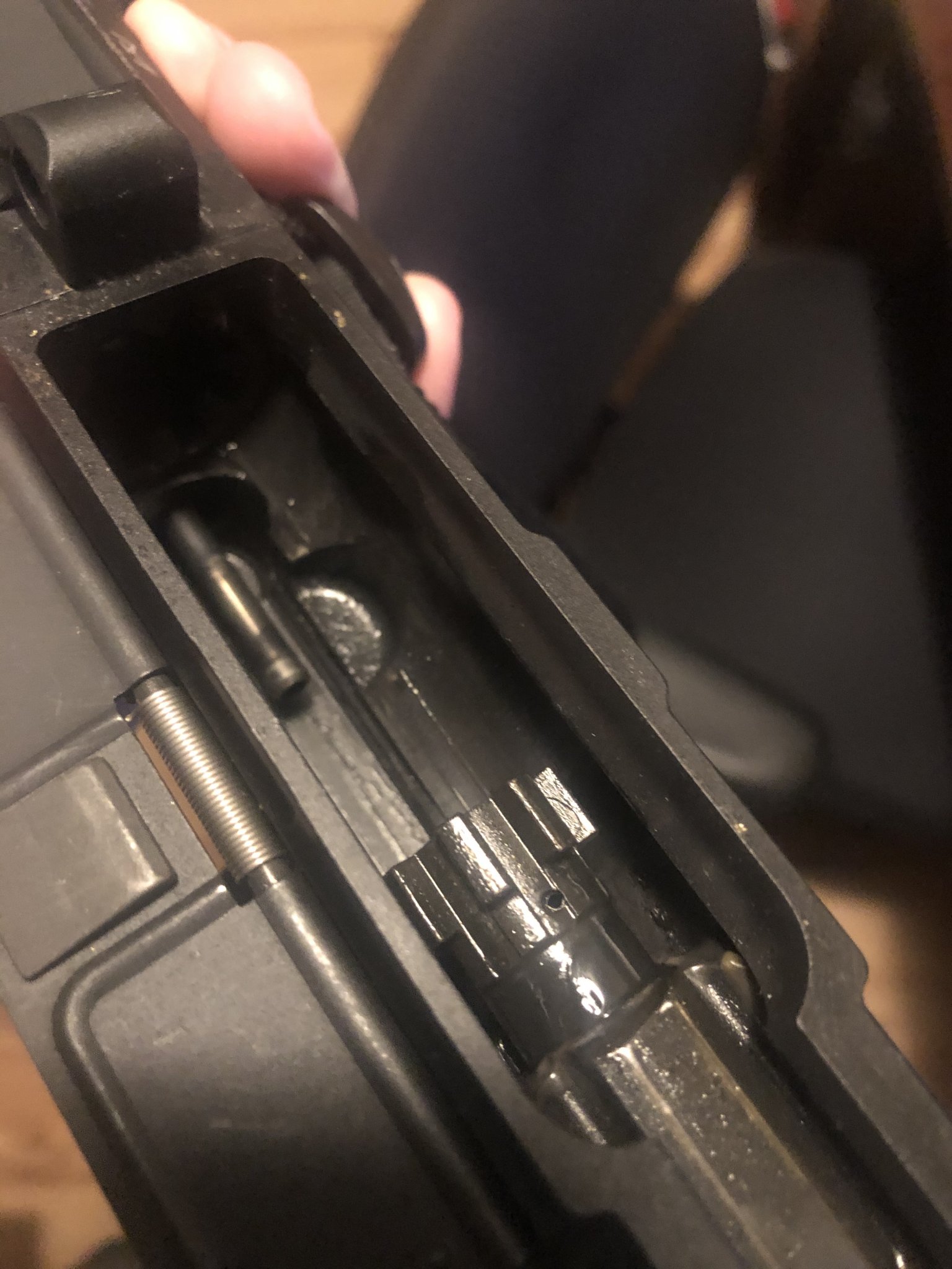

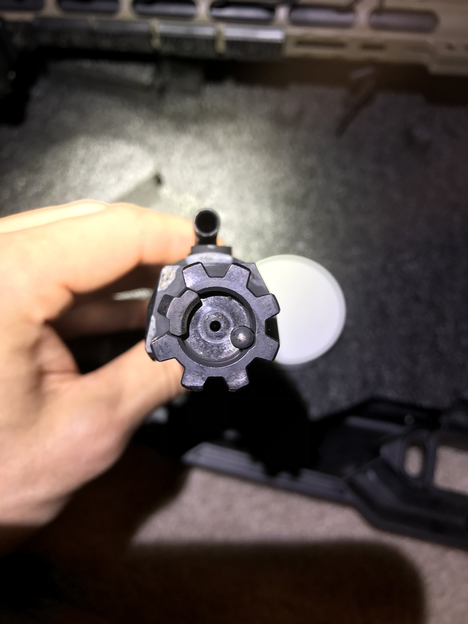

Did notice that two of the bottom bolt lugs have some wear and missing metal. This could be from forcing bend bullets into the pipe unknowingly or all the times I had to mortar/ force a live round out ?

Stupid question on my part but it has to do with the consistent issues with handloads vs factory ammo - how are you checking the dimensions on the resized cases?
It causes me physical pain to see a dry AR-10. Those guns need to be WET. I lube the shit out of all my AR’s and they run like butter.
Your bolt is messed up and you need to find out what’s up.
okay that is great to know!! As I mentioned I ran it soaking wet with frog lube when I first got it, it ran really well, but when I was hunting it got cold and turned into just a thick gunk. Any lube you reccomend?
do you think the bolt is messed up based on the images and the lugs being scuffed up or just in general because of how the rounds are sticking in the rifle?
I am thinking about ordering a JP BCG and throwing it in there, but that’s an expensive thing to do, if it’s really a problem with the chamber/ throat.
That rifle is filthy,clean it and get a good look at that bolt

Sounds like that bulk 147 has a shorter base to ogive measurement than the FGMM 168’s.
I know the smith said it headspaced properly, but that’s only measuring the cases...not the throat and what the throat was reamed for.
After cleaning to ensure there is no carbon ring, if you can run that cheap 147’s without issue, but have trouble with 168’s/175’s, it would appear your smith used the wrong reamer for the match bullets you want to use.

1: Your gun is *not* dirty, and you're going to cause way more harm than good by cleaning it all the time. Don't overclean guns. I have thousands of rounds through my AR's and I don't clean them. I lube them, and I get lube on my glasses and my face and weeping out between the receivers. Run them wet. There really isn't much to clean, as long as you're running them wet enough that carbon isn't baking onto surfaces, the carbon just discolors lube like oil in an engine. Run an engine after an oil change for 50 miles and it's still good oil but it's black as night. Same thing here. Just never run an AR dry. Vickers did a demo on overlubing by dunking an entire rifle in a bucket of motor oil and then ripping on it.
2: Yeah your bolt is jacked up, and might be part of the problem. I'm not sure what caused that but even after my AR-10 had issues running too fast and smashing into cases, it didn't do harm to the bolt.
3: That gun needs to be broken in. Grab some mil surp if you have it, and go shoot 300 rounds through it.
4: You need to confirm your throat dimension with your gunsmith. A chamber can headspace correctly, but the throat portion in the rifling can be cut for certain bullets. If the ogive, the fat part, of your bullet is longer than intended, it will engage the rifling when the bolt closes and you run into the issue you have here.
5: AR's do run fidgety when it gets really cold, especially with the grease I run. I just got some Cherrybalmz winter lube and some Breakthrough high purity oil to try out, both look like they're going to run well out hunting in the snow. I haven't tried either to have feedback on them.

At this point you have no idea why it does what it does. The smith is checking with headspace gauges which only measure from the datum line on the shoulder, not OAL. He's getting a number of 1.630 or slightly larger and happy with it.
If cases or reloaded cases are sticking near the head and not chambering they probably need to be run through a small base die. That said it seems unlikely since most factory stuff works.
You can simply seat factory ammo deeper, not crazy deep but sensibly enough to function in your rifle. Fire a shot and make sure you're not flattening primers or showing any other signs of pressure. If your dad or whoever wants to make up some reloads just make sure the OAL is short enough to have some jump to the lands with the bullet you're using and realize that you can't run max pressure loads at a shortened length.
You could try and find another smith familiar with lengthening the throat. Personally I'd just keep measuring the throat and shoot the piss out of it. That barrel ought to be around for 10k rounds.
I don't think you've ever stated, does this rifle have an AGB? If not, I'd get a Superlative Arms which vents off some of the excess gas which would help running it suppressed.
This is a headspace gauge.
If you will note, it does not include a neck portion. This gauge, and ones very much like it, is what gunsmiths use to check headspace.
What it does has nothing to do with the chamber neck or rifling throat. A rifle can pass the headspace test and still have issues with the throat/rifling entry. The headspace test does nothing to do with neck length or bullet seating/rifling entry.
My best guess is that the rifle's chamber/throat is not deep enough into the rifling to allow a standard dimension cartridge to chamber without the bullet engaging the rifling. If it is shorter enough, it will grip the bullet enough that extracting the unfired cartridge will generate enough force to retain the bullet as the case is extracted.
This is precisely the issue you are experiencing. This may also be related to the accuracy issue, it may not; but it is a definite problem and needs to be addressed.
As noted above; standard issue 147-150gr (M-80 Ball ammo equivalent) cartridges utilize bullets with an ogive that does not (usually) contact the rifling under any reasonable conditions. They will most likely not help disclose or diagnose this problem.

Sorry for just getting back, it’s been a crazy couple weeks but just got out to farm to shoot today. I got her working fairly reliably after messing with the gas a lot. But I sharpied some bullets to see what was going on and here are the photos of before and have chambering the round. What would this tell me?
May be worth trying the Hornady OAL guage. Sounds like a throat lands issue effecting different bullets. Some jam, some dont.
Whats the differemce between the Sig and GMM bullets?
Might try a lighter smaller bullet.
Sorry for just replying everyone!!
so the thing that makes this more difficult to figure out is that, for the first 6 months of owning the gun, I shot nothing but bulk ammo through it (as I mentioned about 200-300 rounds) dripping wet in frog lube. Ran like a sewing machine.
it wasn’t until I bought that box of Gold Medal 168 when I found out the bullet was getting stuck and unseated in the chamber. So then we made some hand loads and those got stuck in the chamber.
after those two events I sent it to the smith and he said headspacing looked fine on it, and re-sighted with the Sig elite ammo. Also polished the chamber and cleaned the gun thoroughly.
Of course 1st thing I do getting back was drop a live sig round in. Then extract. No problem. Then I dropped one of the live hand loads into it. Got stuck and had to mortar the gun to get it out. Tried a Gold Medal round and it got compelltey stuck.
so sounds like it could be the chamber?
