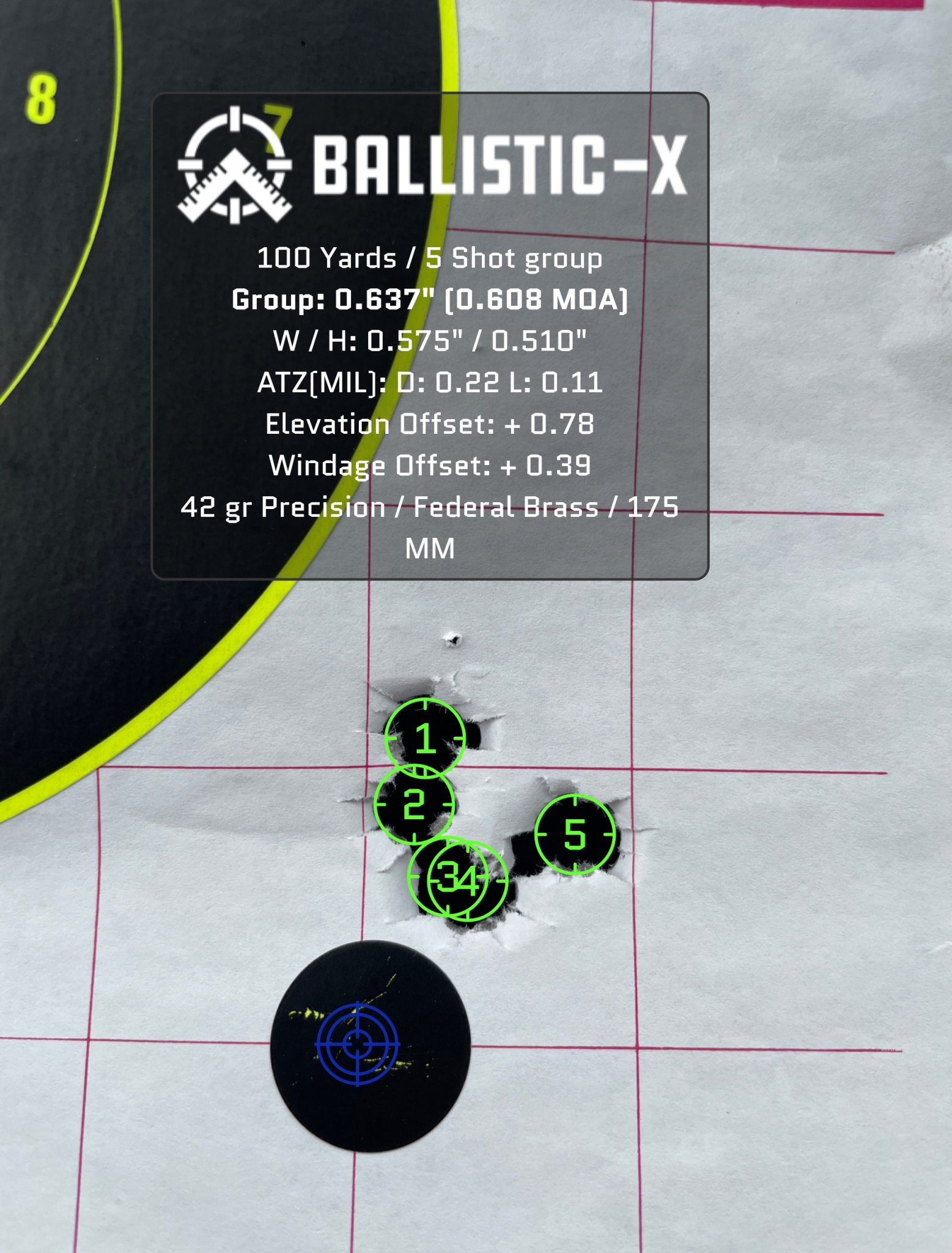

For my AR10 I have 2 uppers, 1 has a Proof 24” steel barrel in 6.5 Creedmoor and the other has a 308 Win Wilson Combat 20” super sniper barrel.
The Proof is an absolute hammer and prints 1/2 MOA groups one after another.
The WC is very new and only has 100 rounds down the tube but so far I’m shooting sub minute groups with it using reloads. Best group so far is 0.6 MOA and a bunch of .75s and .8s.

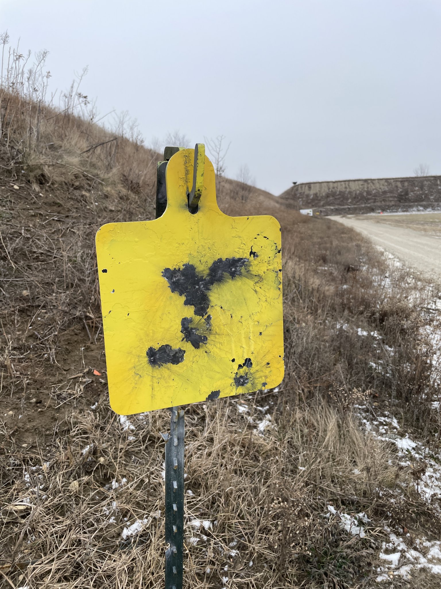

I picked up that 20” Fluted Wilson Combat Super Sniper from that sale and paired up with a Rubber City bcg. It seems like it’s a good shooter so far. I literally shot this group this morning while breaking the barrel in. My load is slow as hell - 42gr Shooter’s World Precision, Federal brass, 175gr Match Monster going 2,500 fps.
That steel is a 10-inch at 400 yards. The main cluster is 1 MOA, the 2 flyers were me figuring out the elevation/wind since I hadn’t chrono’d at that point then the next 8 shots were standing from a barricade off a game changer.
The Proof barrel I have was stupid accurate right out of the box. The Wilson definitely didn’t like a few loads and required some load development. There were a few 1.5-2 MOA groups in my ladder test 😂
