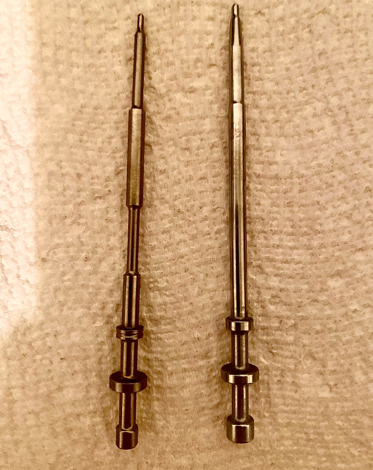

Both firing pins 6.5 on the left, 22CM on the right

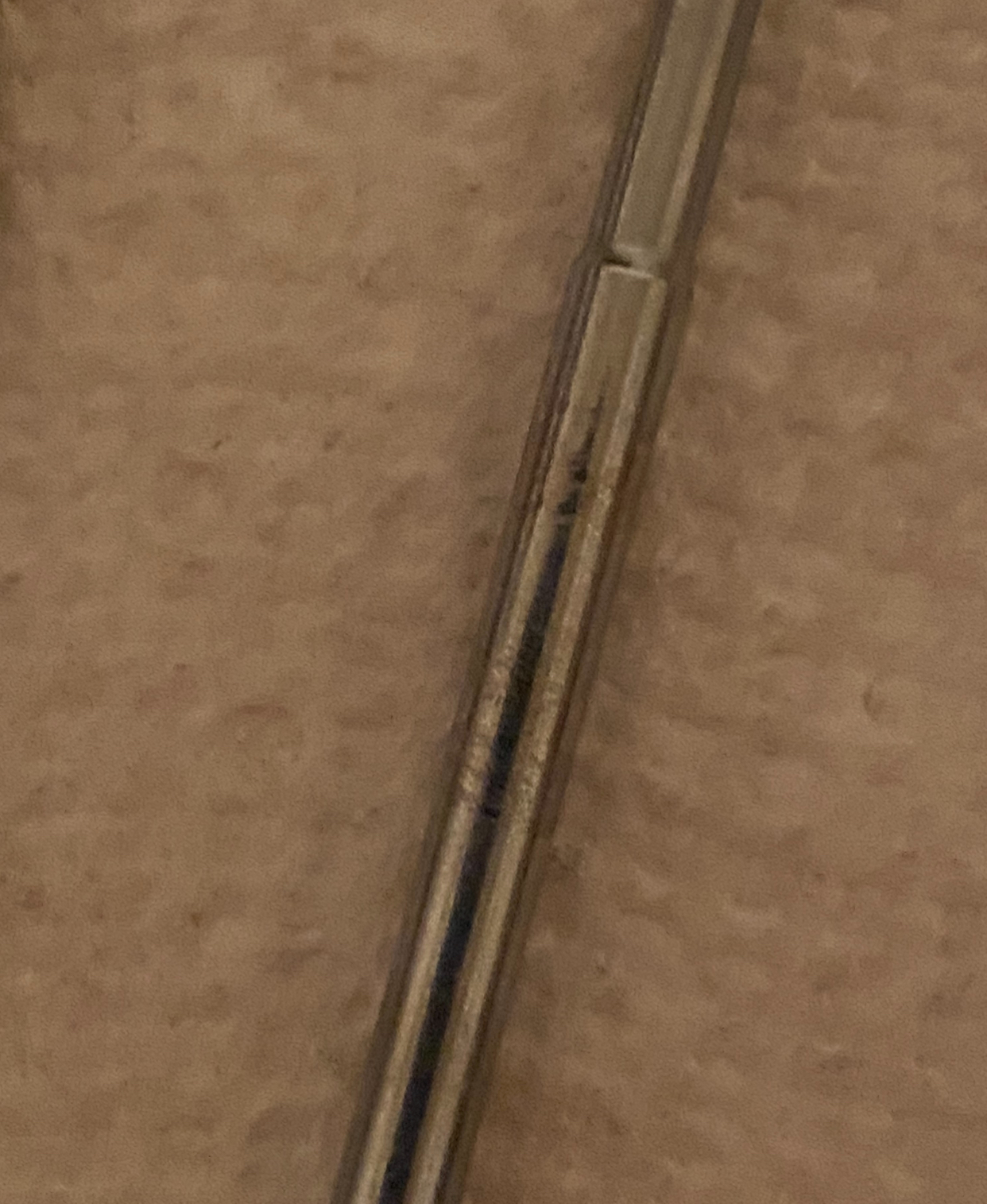

Close up of the scratches on the pin on the right
Assemble your BCG without the firing pin then line up the firing pin on the outside of the BCG right where it would naturally sit inside if it was assembled, this will give you a general idea going by the locations of the scratches on the firing pin where it's making contact.
You have four suspects, Bolt, Carrier, Cam Pin, Firing pin retainer.
If the "scratches" are located in the bolt remove the extractor and inspect for foreign material.
Seem to be either the cam pin or inside the bolt. But I didn’t see any burrs inside either.
I'd look for sharp edges at the firing pin hole through the cam pin.
That’s what I was figuring but I’m not seeing anything so far. I’ll try again tomorrow in the daylight if I get home in time.
