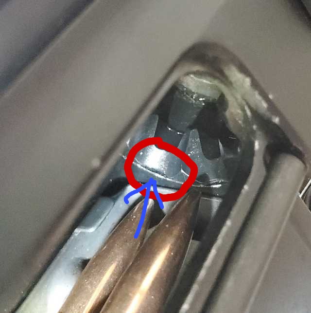

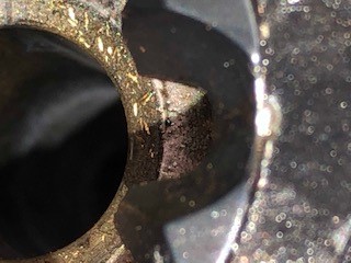

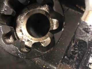

I have built a DPMS patern side charging AR-10 in 6.5 creedmoor with top quality parts and cannot get it to function correctly.... reaching out to the forum for advice. The build is on a matched Gibbz G10 side charging upper/lower receiver. Operating system and barrel are all JP Enterprises. Trigger is Geissle SD-E 2 stage trigger. DiamondHead Handguard. Luth-Ar stock. I have tried Magpul and Lancer magazines.
I have worked through all of the function issues... gas system, bolt hold back, barrel contact with handguard issues etc.
I continue to have a problem whereby rounds will not feed smoothly onto the feed ramps of the JP barrel extension. A few rounds will feed and then either one from the left or one from the right side will nose dive directly into the flat spot that is between the top of the magazine and the bottom edge of the feed ramps. Essentially the cartridge gets wedged between the bold face and the barrel extension. Like any AR platform the magazines wiggle a bit and move up a and down slightly..... this is just enough to cause the feeding issues.
I am not sure if the feed ramps milled into the barrel extension are machined incorrectly, or is the lower receiver out of spec and causing the magazines to sit too low, or is the upper receiver milled a bit off and not seating the barrel in the right location to allow the feed ramps to meet up with the magazine at the right height.
Check out the attached photos and let me know your thoughts on how to fix this issue. I have a couple of thousand $$ into this rifle and its driving me crazy getting it to function.
Thanks

We need to see some more pictures of the upper receiver with no mag inserted. It could just be a magazine compatibility issue, or your feed ramps may need to be worked on either way it should be a easy fix, you should try picking up a lancer Mag or another quality .308 AR Mag.

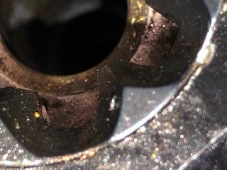

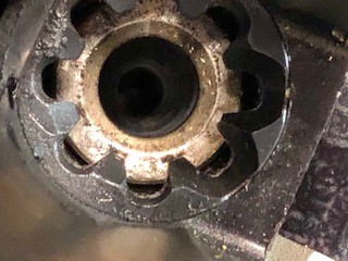

Here are some detail images of the barrel extension and feedramps.
I have also sent the details to Gibbz and JP.
Further advice is much appreciated.
I am using both lancer and magpul mags.... have tested 8 magazines and the
feeding issue occurs with all of them.

You can try using a metal magazine like an ASC and getting the Badger Ordnance feed lip tool to adjust the front of the mag to hold the cartridges at a more upward angle rather than as level as these look.
When you describe where the bullet is striking, do you mean the flat edge of the barrel extension between the ramps? After buying a used barrel that someone "worked on" the feedramps, don't. If it seems like that's the problem, send it back to JP.
If you make the opening any wider .26 caliber bullets will go right between them and hit the back of the barrel on the side of the chamber. The cartridge will not move up until the neck/shoulder junction of the case hits the ramp and then it's too late to feed into the chamber unless bullets are seated super short.
Ive built more custom 6.5cm AR's then I can count with custom barrels using JP barrel extensions. Never had an issue. Your barrel extension looks just fine. Run the bolt and when it fails/jams get us a picture of that jam.

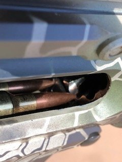

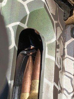

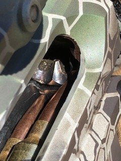

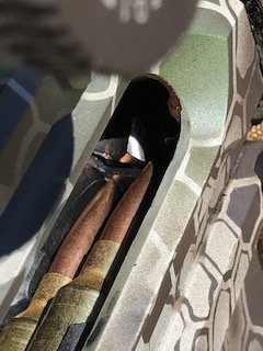

We need to see whats happening when you say it wont "function correctly." Pictures speak 1000 words. Lets see them. And please get us some real pictures inside that upper with the mag inserted with rounds in the mag and with rounds out of the mag. Those tiny, low quality pictures are hard to see whats going on.
Here's some pics of my 6.5cm gasser. MEGA Receiver set with JP barrel extension and KAC SR25 mags.
6.5cm rounds sitting in mag
Pulled the charging handle back to release the bolt stop and slowly starting to let it go forward

It's difficult to see because your chamber is so damn dirty (that in itself is not helping as well) and your pictures are small but it appears your upper receiver has no feed ramps, in the picture below I have indicated from Padoms pics where you need to blend your upper receiver feed ramps with the feed ramps of the barrel extension. It is extremely easy to do with the right bits in a Dremel.
Again also order some quality mags from the ones that have been mentioned above by other members.

If it was mine...I would dremel polish the feed ramps down into the RE. Done prudently it should greatly help feeding.
Judging from your pics... it shouldn't take much.
Also, what bullets are those? I've had issues with long secant hybrids, especially the 140g Berger.
But yeah, clean it first, then blend the feedramp, then try using a non-hybrid.
I agree that the ramps should be blended into the lower receiver. It looks like there is an actual step between the barrel extension and the receiver that is catching the nose of the cartridge.
I dislike this approach because aluminum is far less tough than aluminum with anodizing...but you could use a cratex wheel on that junction there to blend the interface with the upper. Then clean it like crazy. Also, can you please post a picture of your magazine catch on the non-ejection port side of your lower?

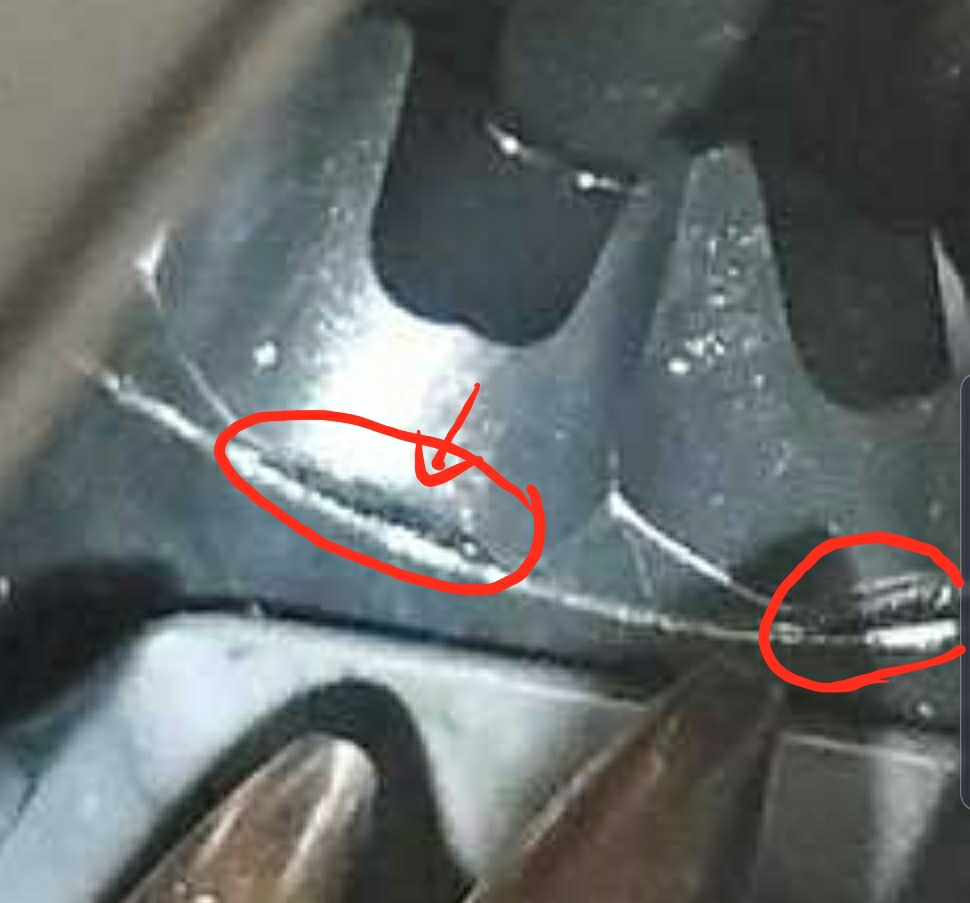

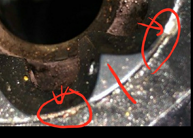

It looks like your barrel extension protrudes out past the edge of your upper creating a lip for bullets to hang up on? It doesnt take much to cause an issue.
How comfortable are you with a dremmel? It's a 5 minute fix.

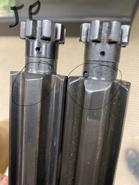

Look at the pictures below. One is Padoms. You notice his feed ramps have a slight curve back from the edge of the upper. And yours clearly hang over with copper evidence that a bullet tip is catching.
I personally take my feed ramps into the reciever more like M4 style.
Blaming the JP BCG sounds like a cop out. And while a different one may function better it doesnt address the root issue. Same with different ammo. I would bet money the upper is short by a couple thousand where the barrel extension sits. If Gibbz couldn't figure this out it would be the end of our relationship.

Blaming the JP BCG, one of the best out there is funny to say the least. I cant tell you how many large from 6.5cm gassers Ive built with both Aero M5 and MEGA receiver sets with JP and RCA complete BCG's. Never a single issue with any of them. Just putting that out there.
I can already see this thread having people question using JP BCG's. They shouldnt.
Yeah, I call BS. I have Aero M5 with JP and they works flawless. I'm about to do another. Then again the Aero recievers have M4 feed ramps built in so...
PSA, If anyone wants to dump their JP BCG for something more reliable let me know.

I finally got my rifle back from JP in February. They machined a small feed ramp into my upper and polished the underside of the BCG. I have now begun to load test. This rifle does not like longer bullets. 130 Berger’s and 123 Scenars feed perfectly as long as they are seated below 2.80. Also discovers that ASC metal mags and Pmags work the best.... Lancers still have intermittent issues. Just tested Berger 130 with Varget in Hornady brass and seeing groups of .75 with 37.9-38.2gr.... velocity is 2671-2693. Also had tested the 130 with H4350 going 2750-2800.... but groups and SD were terrible.
