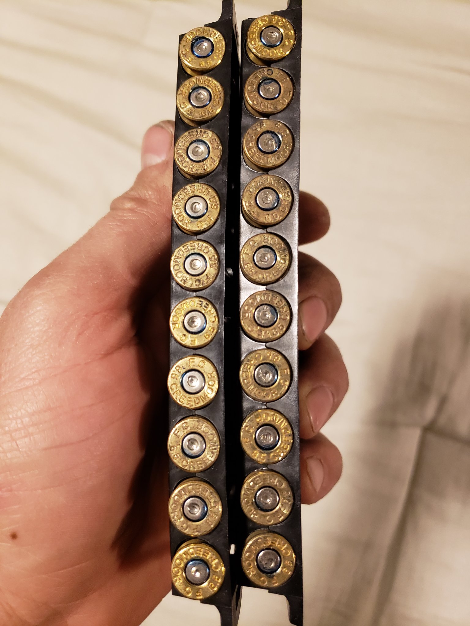

I went back and looked at the cases i shot of factor federal ammo. it is showing ejector marks on all of the brass. some bad enough i can fill it with my fingernail. I'm starting to think something else is causing this and i need to resolve this issue before reloading. I'm thinking about a JP SCS to add weight and a stiffer spring.

attached is a pic of the factory ammo i shot out of this gun the other day.

I looked at your photo it didn't look like you have much cratering of the primers. I believe Federal 210m primers are softer right.........
I wouldn't worry about the ejector swipes that can be dependent on the bolt and have little to do with pressure signs, not all the time but its not a reliable indicator in my experience, but primer crater is a good indicator.
