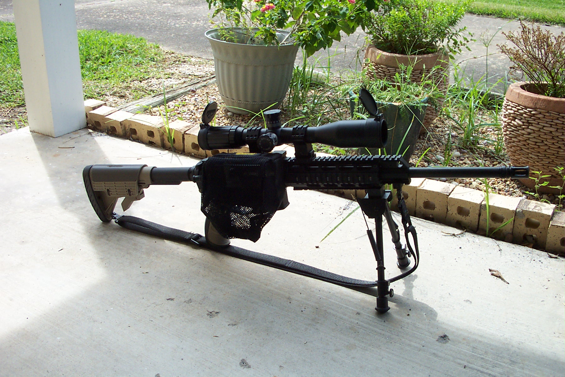

    I have an AR-15 and I used to use a ADM Recon mount where it'd extend the scope forward a few inches. I noticed that I was always a little low when having a proper cheek weld so I switched over and ordered the ADM Recon-SL mount which is .3 inches lower but no longer extends out. Now with a good cheek weld I see right directly out the center of my scope, but I have the mount the scope past the upper.
    My handguard has a full top picatinny rail and I was wondering is it bad to have the scope mount half cover the upper and half onto the handguard? I read on some threads where having the scope on the handguard could affect your shot as the handguard heated up it could flex causing new torque onto the scope mount.
    Thanks for any feedback.
    It may affect your accuracy, it may not. I prefer to play it safe and not bridge the gap between my receiver and handguard.

    My suggestion would be to move the scope mount back onto the flattop and increase the LOP in order to restore the proper eye relief.

    A couple of reasons not to bridge the gap... Almost never are the rail section on the hand guard timed perfectly (rotation) with the one on the receiver... The mount could be distorted by the misalignment. Almost never are the slots on both receiver and hand guard timed correctly (front to back)... You may end up with only one slot preventing fore and aft movement under recoil.

    I have a free float forearm on my 300blackout and my scope is extended out. NO PROBLEMS WHAT SO EVER. Thanks for the god a grip link.
    You can get some poi wandering and weird fliers if you bridge the gap and put a heavy load on the bipod. Some people do it and never notice. It's simple not best practice, but it's not end of the world either.
