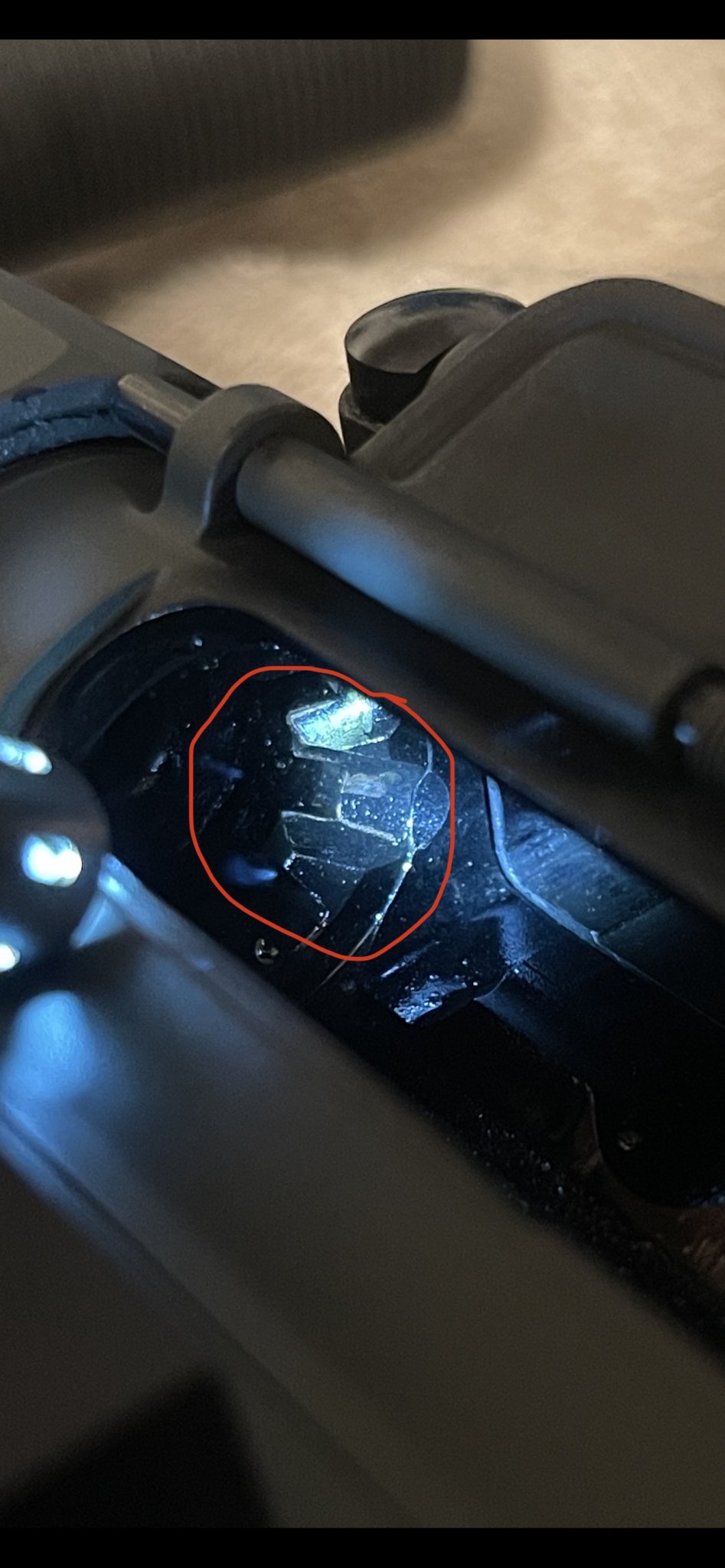

Do you have a picture of the feed ramp barrel extension area.
This is where I would look. I have a AR upper that will move the 55 fmj Fiocchi factory ammo back each time it hits the feed ramp. Need to polish it up. If I load the same round 5-6 times it will push it back into the case completely

Any chance bullet is hitting breech end of barrel because entry cone in barrel is too small, or an issue with feed ramps in barrel extension? Or chance there is not a smooth transition between extension ramps and receiver?
See how your bullet reacts when it hits the feed ramp. The ramp in this pic will catch the round. If I move the bolt slowly it will actually hold it from going forward. Pinching the bullet in between the sharp edges. Needs to be polished down. Moves factory Fiocchi 55 fmj each time it’s chambered. Eventually knocking the bullet out of the case neck completely

Any luck figuring it out yet?
I've got a chambering issue cause it's also scratching the bullet. But I did take the expander mandrel out of the die and sitted a couple and they didn't move when chambered. I'm gonna have the barrel worked on to fix the chambering issue still.
