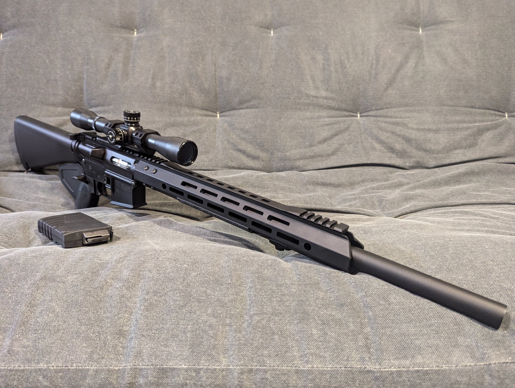

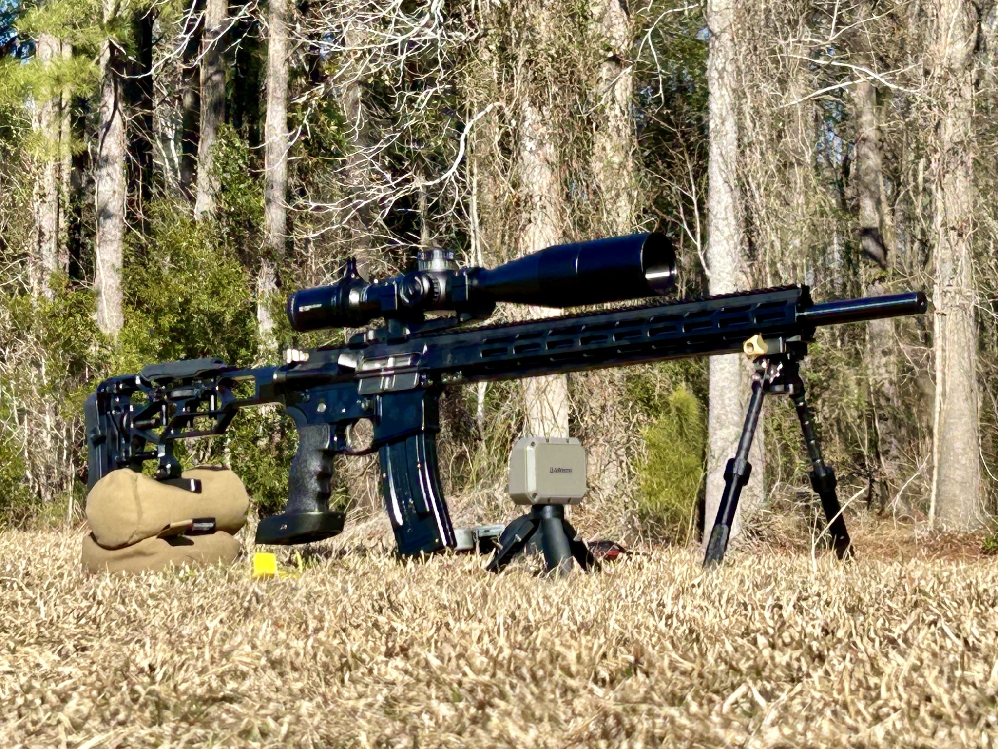

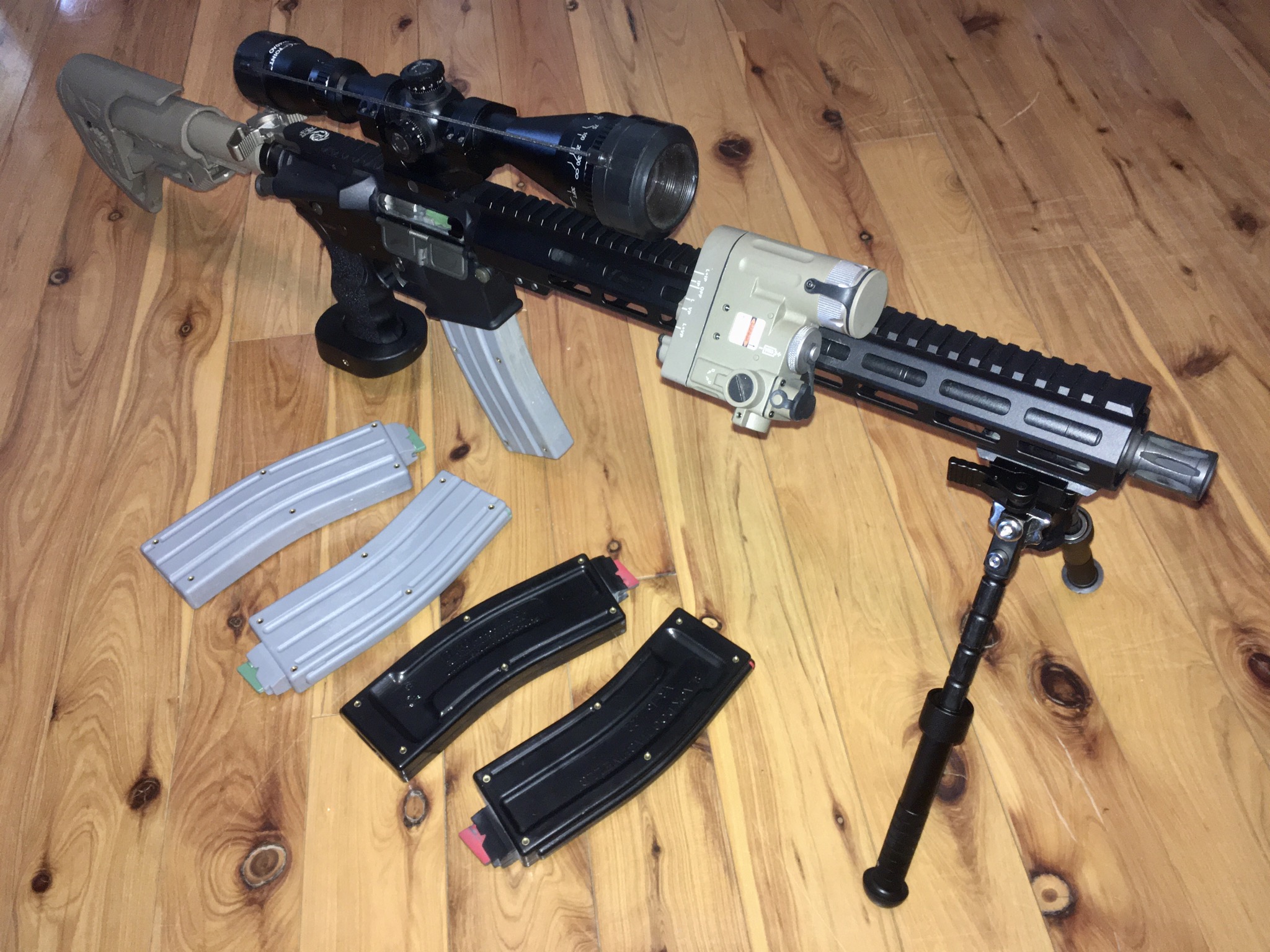

I shoot NRL22 events at a local club. This is my YEET cannon/mall ninja build, I hope to turn this TacSol .22LR upper into a match capable winner. It’s more reliable than any autoloader I’ve ever fired, but accuracy is severely lacking. Thoughts on a winning barrel/chamber choice?
It’s not a question of ammo quality, but to answer your question:
GECO bolt rifle
GECO semi auto
CMP Eley bulk
CCI SV target
Wolf MT (NAMMO made)
Federal AutoMatch
Federal 711,714,719,510,AE5022,790
Fiocchi 22FHPSUB, 22HVCRN
Aguila SV
Winchester Dynapoints, 333
Lapua Center-X, Sk Jagd Standard Plus
My custom build 10/22 clone is about 1.25” @ 100m with some of the above, but I feel the potential is better with the AR design. To date zero function issues with any ammo, the accuracy just isn’t there.

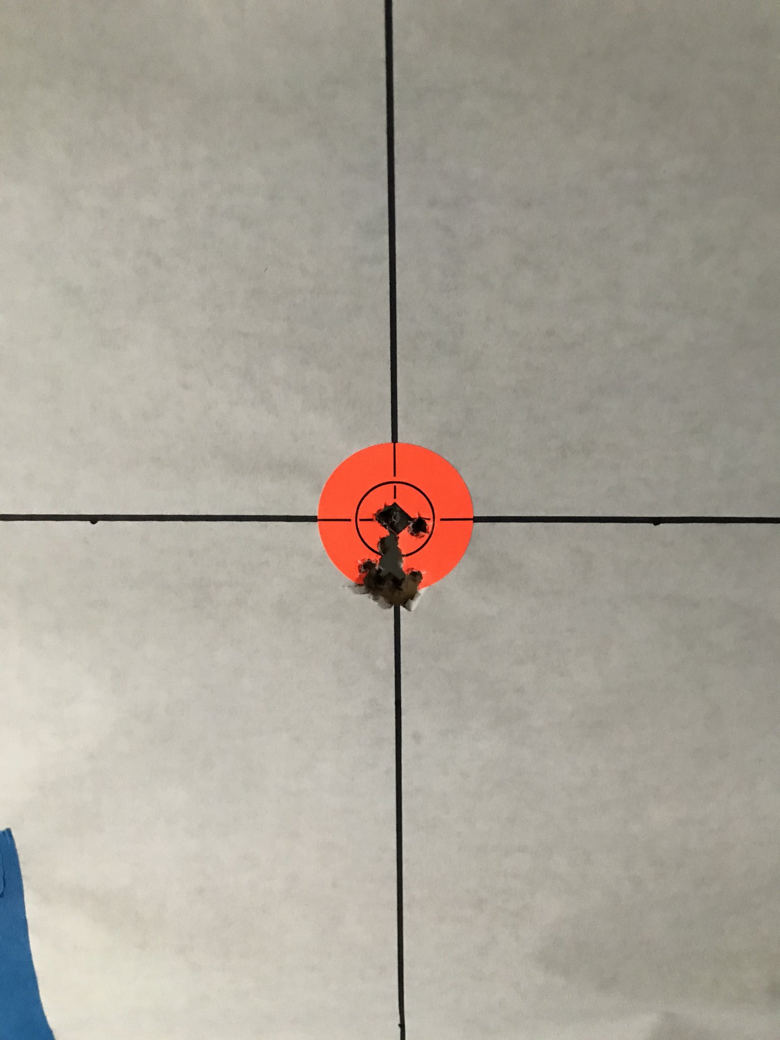

FWIW, this is a target using the above JP-22 Barrel and Bolt Kit. 50 Yards, 15 Rounds of SK Yellow Box, Bipod and rear bag.

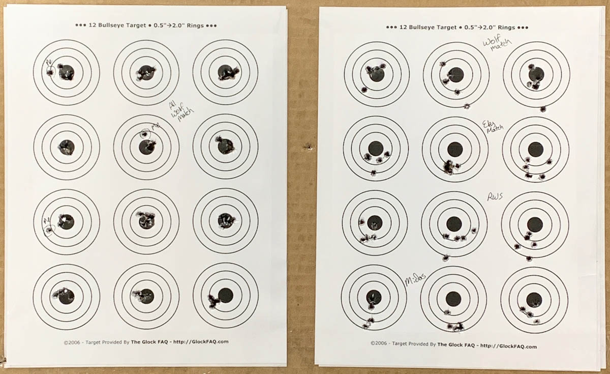

This was the original test target (right target) I sent JP, (left is wolf match groups from my Volquartsen which I included in my correspondence to JP just so there was no question it's the monkey) It was odd the JP would frequently put 2-3 rounds together and then have huge flyers even on shots that felt great when they broke. Originally I built it on a Mega smooth side billet upper/lower with Seekins handguard, Trigger tech trigger, and used a proven optic/mount, so anything but cheap parts. I had JP rebuild it on their upper and handguard while it was in for eval, but have not had a chance to test it since it was returned. So it might very well shoot amazing once they worked their magic on it.
If I were doing it over, I'd have one of the well known rimfire upper builders do a full upper build with a custom barrel. Compass Lake, Keystone, etc. By the time you do a JP kit with a quality upper and handguard it approaches the same price anyway. JP however definitely went the extra mile and was great to work with, nothing but praise for them.

To be fair JP doesn't really market it as a tack driver. The instructions that come with the JP Supermatch 22 barrel kit state: "From most high‐velocity ammunition, you can expect 2‐3 MOA and 1.5‐2 MOA out of less expensive target‐ or match‐grade loads at 50 yards. However, the higher quality match loads may deliver MOA performance at 50 yards." So they seem to prepare the end user that the only way you might expect 1/2" 50yd groups is with top end match ammo. Which echo's what JP got when they tested it, their groups with PMC Moderator ($8 a box) were around 0.8" and Eley Tenex ($20 a box) were just under 0.5".
I'd bet in my target above if you averaged all those groups they'd be around 2MOA, Eley Match and Midas shot probably closer to 1.5 MOA, and the cheaper wolf match and RWS were a bit over 2 MOA. I wish I'd have had a crono with that day because one thing I noticed was that the rim strikes looked a bit weak on some of the brass, and most of the big flyers are all low. The vertical spread appears much worse than the horizontal. There definitely was some left to right breeze that day, you can see some left/right stringing in the Volquartsen groups as well and our range uses conveyor belt for a target attachment so it sways a bit in the breeze.

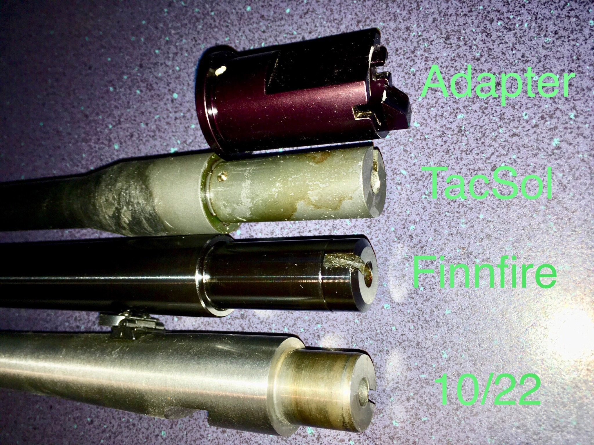

I plan to rebarrel using the TacSol factory barrel collar/feed ramp.
It is a very easy pattern to copy, thus I’ll likely be doing that part myself.

I have a Bentz reamer, and was pondering repurposing another barrel anyway.....

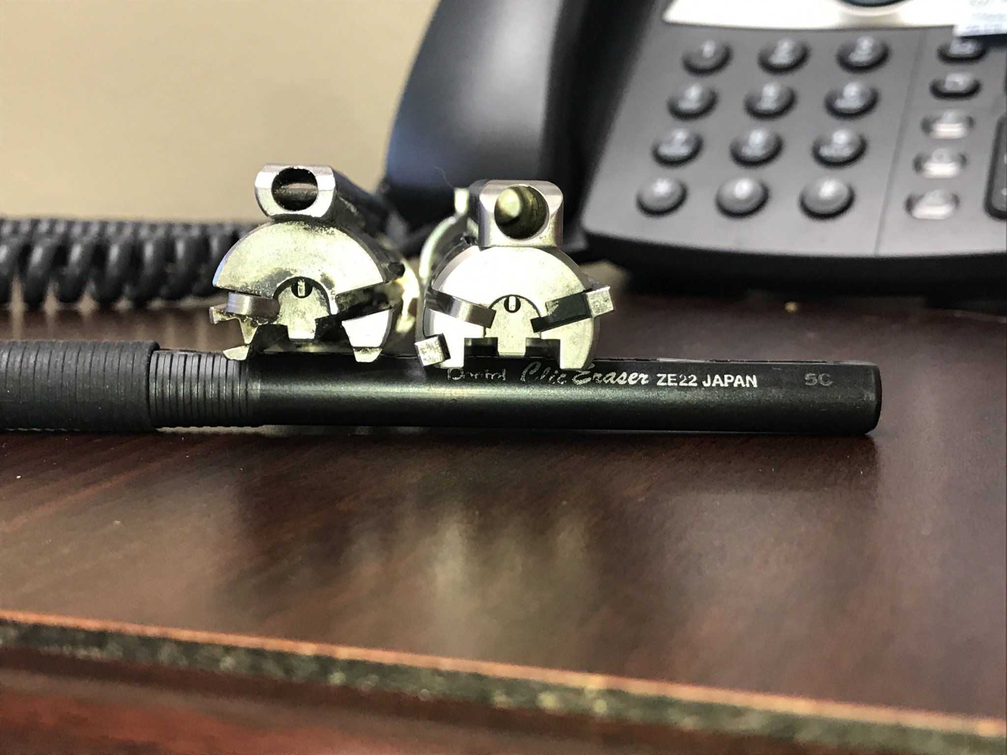

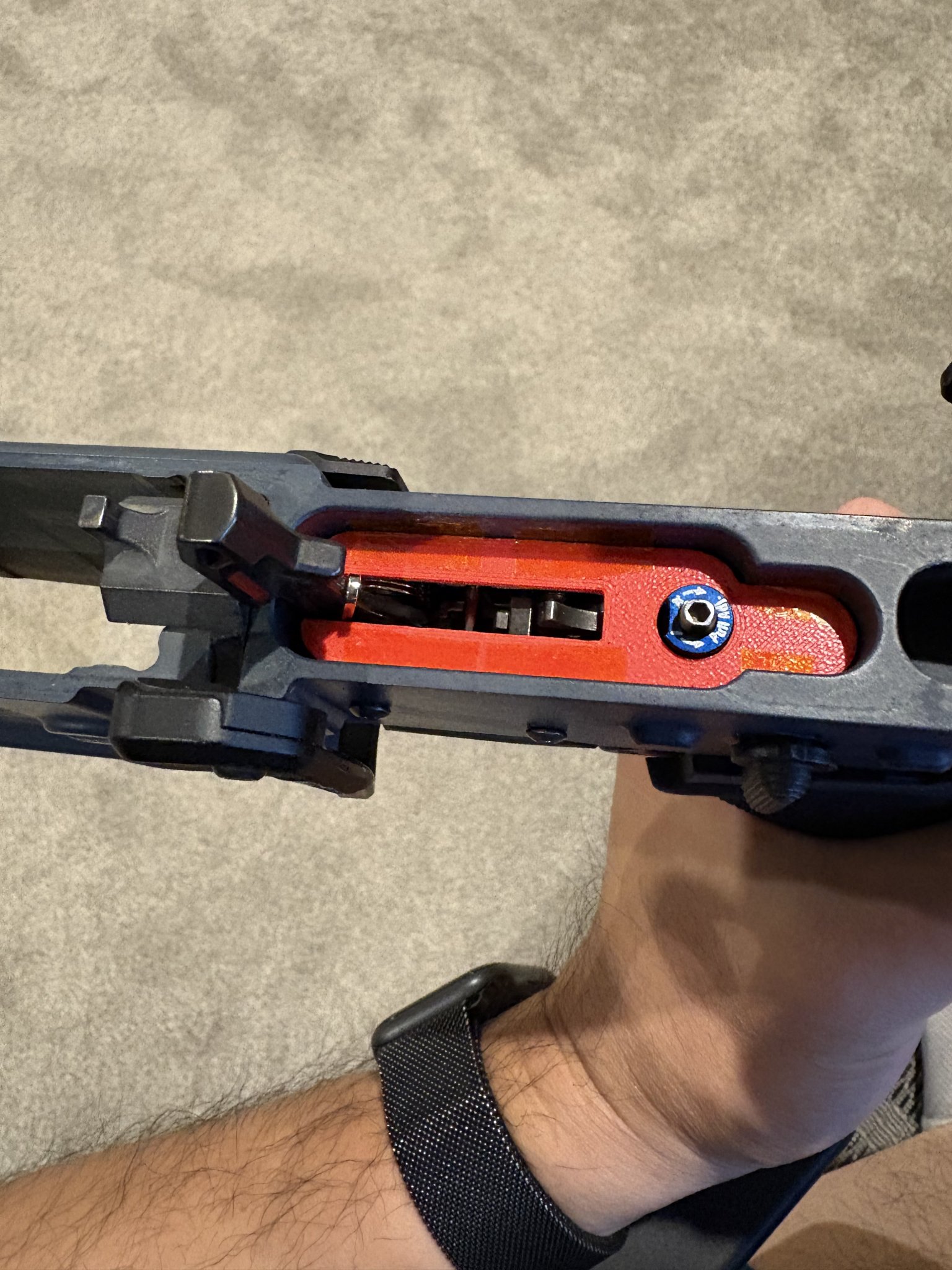

The one on the right is the TS bolt. You're right! The bolt face is nearly identical but I placed the CMMG bolt up to the TS barrel and the ejector is oh so slightly clocked a little higher. You can see in the pic that the left that the ejector on the CMMG bolt, call it 9 o'clock; the ejector on the TS bolt is just a little higher. The TS bolt is built extremely well. I wish I had another. I was thinking about opening up the extractor cut on the TS collar so I could use a CMMG bolt; I'd just have to figure out how to keep the bolt from flying off the end of the guide rails.

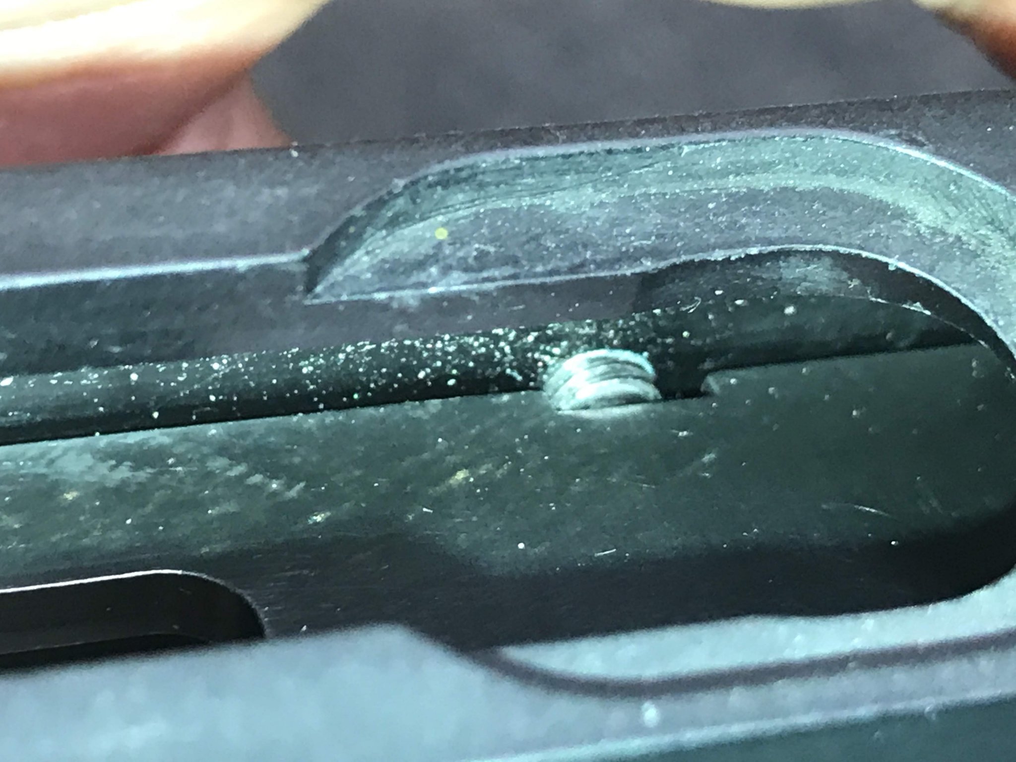

I have a Keystone Accuracy build and he just cut the end of the rails off a CMMG bolt assembly leaving only enough to engage a relief cut in the barrel but the bolt can come right off the end. He drilled and tapped a hole in the side of the receiver which corresponds to a notch in the rail so it's retained upon disassembly. But if you were to take the bolt out and reassemble, you need three hands to wrestle it all back in the receiver (pic below) It's very clever and simple but I still think there's a good way to capture the bolt with the spring guide rod somehow. I remove the retaining screw to shoot it. It's only installed to disassemble.
