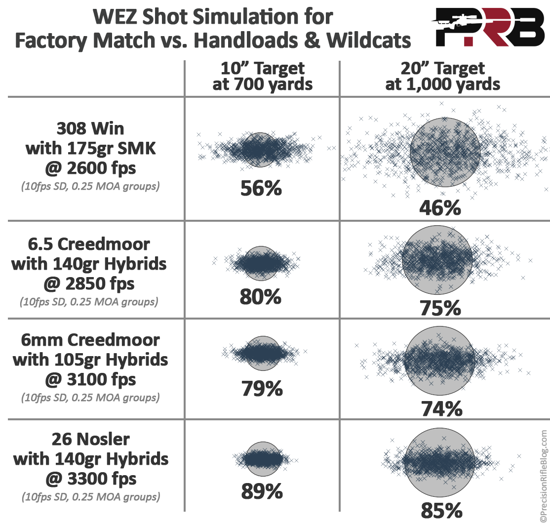

Remember to account for wind drift for your caliber choice as well as velocity....
There are some really interesting modeling articles out there as well.
A lot of reading... but something to keep in the back of your mind.
Search Google for ... Long range Hit probability, look at some of the images on Goggle.
https://precisionrifleblog.com/2015/06/09/how-much-does-it-matter-overall-summary/
And....
https://precisionrifleblog.com/2015/04/25/how-much-does-cartridge-matter/
