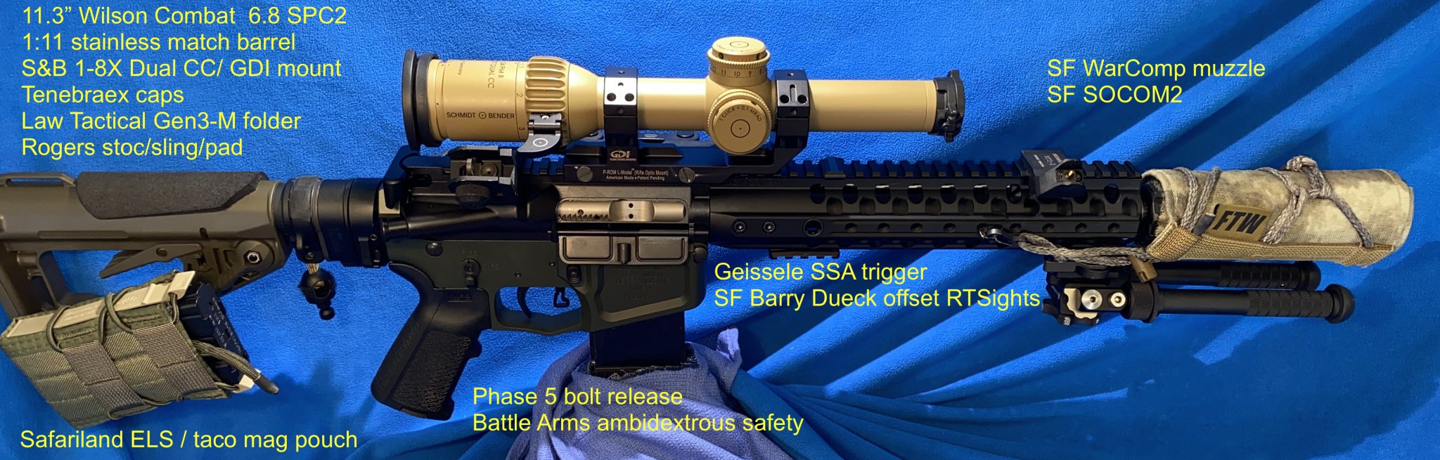

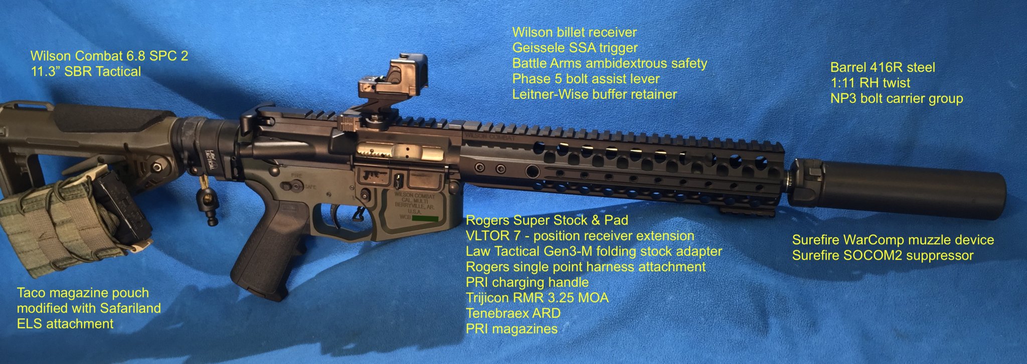

    I paused about building a short 7.62 project......then moved on to this 6.8 SPC II. I believe the over all terminal performance is better without the in-your-face drama. Setup for either red dot optic or real scope for dedicated business.
    Reactions: Mwalex
