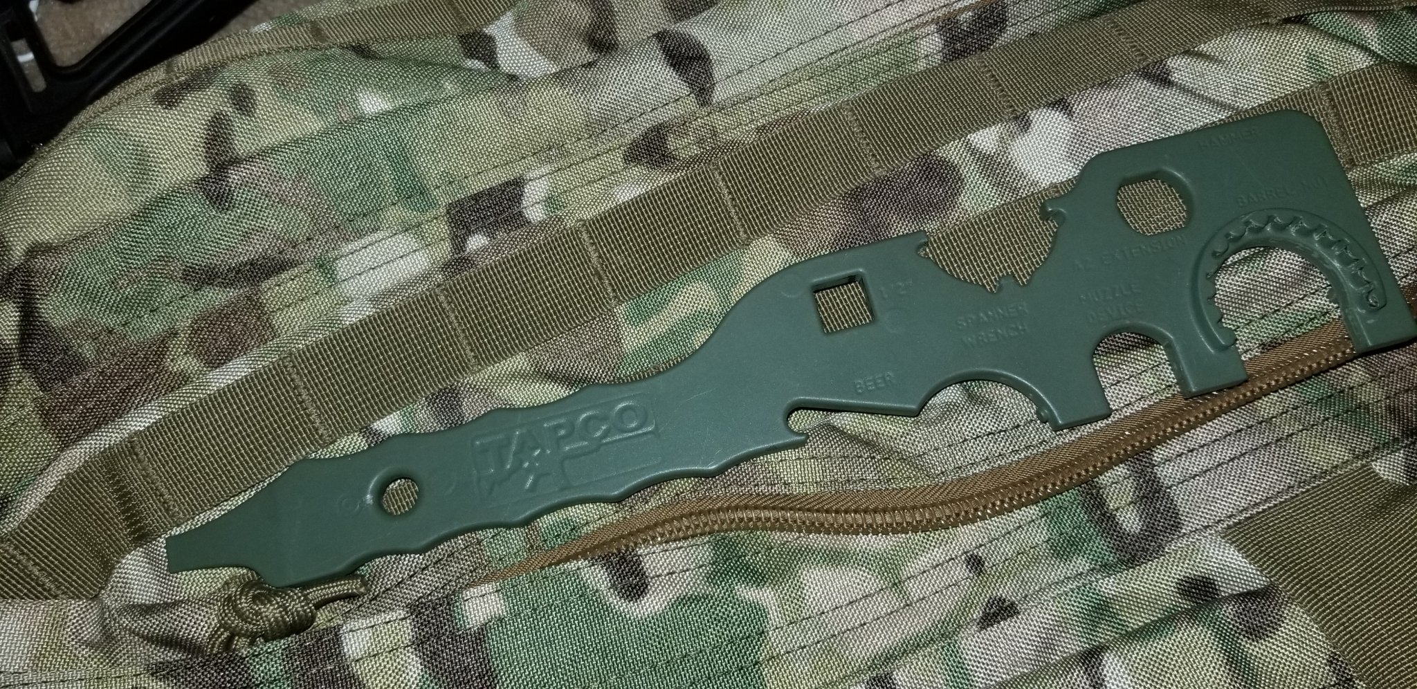

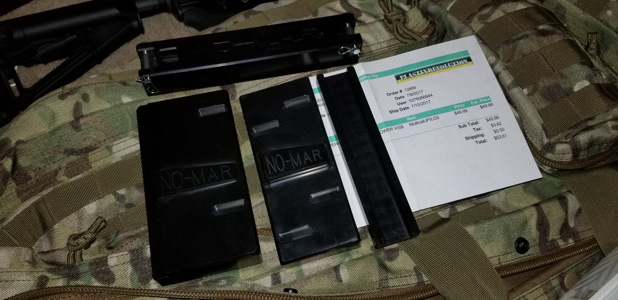

Other than torquing a barrel, i love my No-Mar set of blocks, for 15's and 308's, from Plastixrevolution. And my favorite wrench to date, is the Tapco.

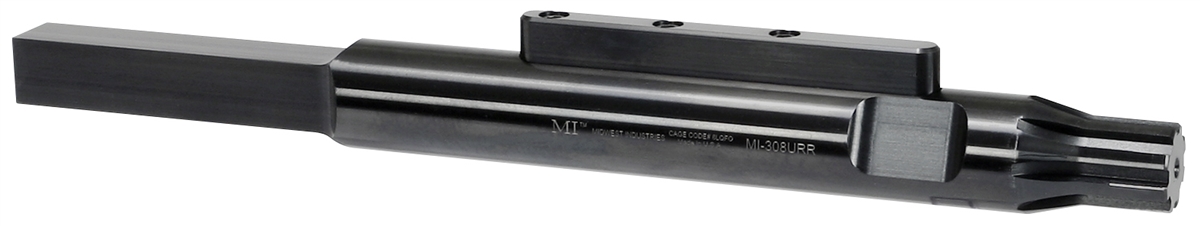

I have actually moved over to the Midwest Industries version of the reaction rod, the MI version has a additional part that runs the length of the Charging handle valley...
I still have the Geissele... but I prefer the MI version now a days.
Just letting everyone know there are options out there.
https://www.midwestindustriesinc.com/MI-Upper-Receiver-Rod-308-p/mi-308urr.htm
I have been reading a good bit about guys using geissele style to install barrels and actually shear their index pin off under the upper receiver slot. Im thinking the one above nay be better for barrel installs as it will hold the receiver, but the geissele style is better for rotating faster for everything else.
