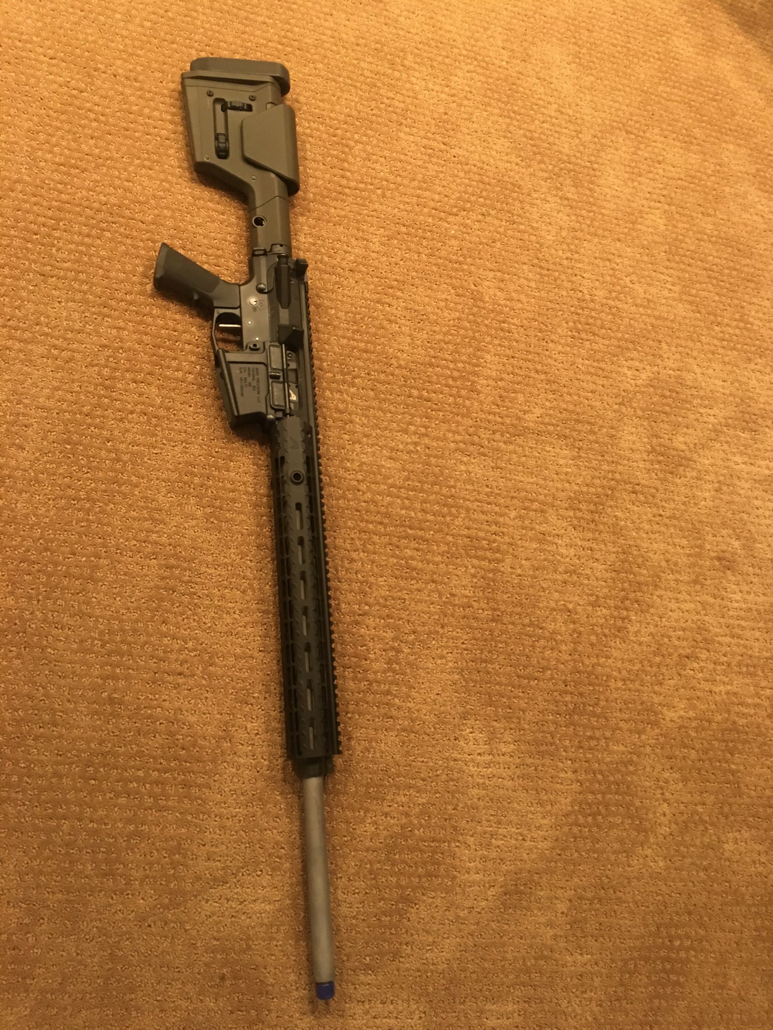

It all sounds quite familiar, since my build was:
- Mega Maten MKM extra-length receiver set
- Geissele HS NM trigger
- JP VMOS Heavy bcg
- Magpul PRS Gen 3 buttstock
- Rifle-length receiver extension (buffer tube)
- JP SCS heavy buffer
- Geissele ACH
- Magpul MOE+ grip
- JP 22" +2 gas barrel
- SLR Sentry 9 gas block
- Area 419 Hellfire brake & adapter
- Geissele 05-424 20moa, 30mm mount
- Vortex Razor HD AMG scope
It shoots sub-1/2moa with Hornady Match 140ELDM ammo (The rifle does, I wish I did consistently). It chrono'd that ammo at 2660fps, but I still only have about 150rds thru it.

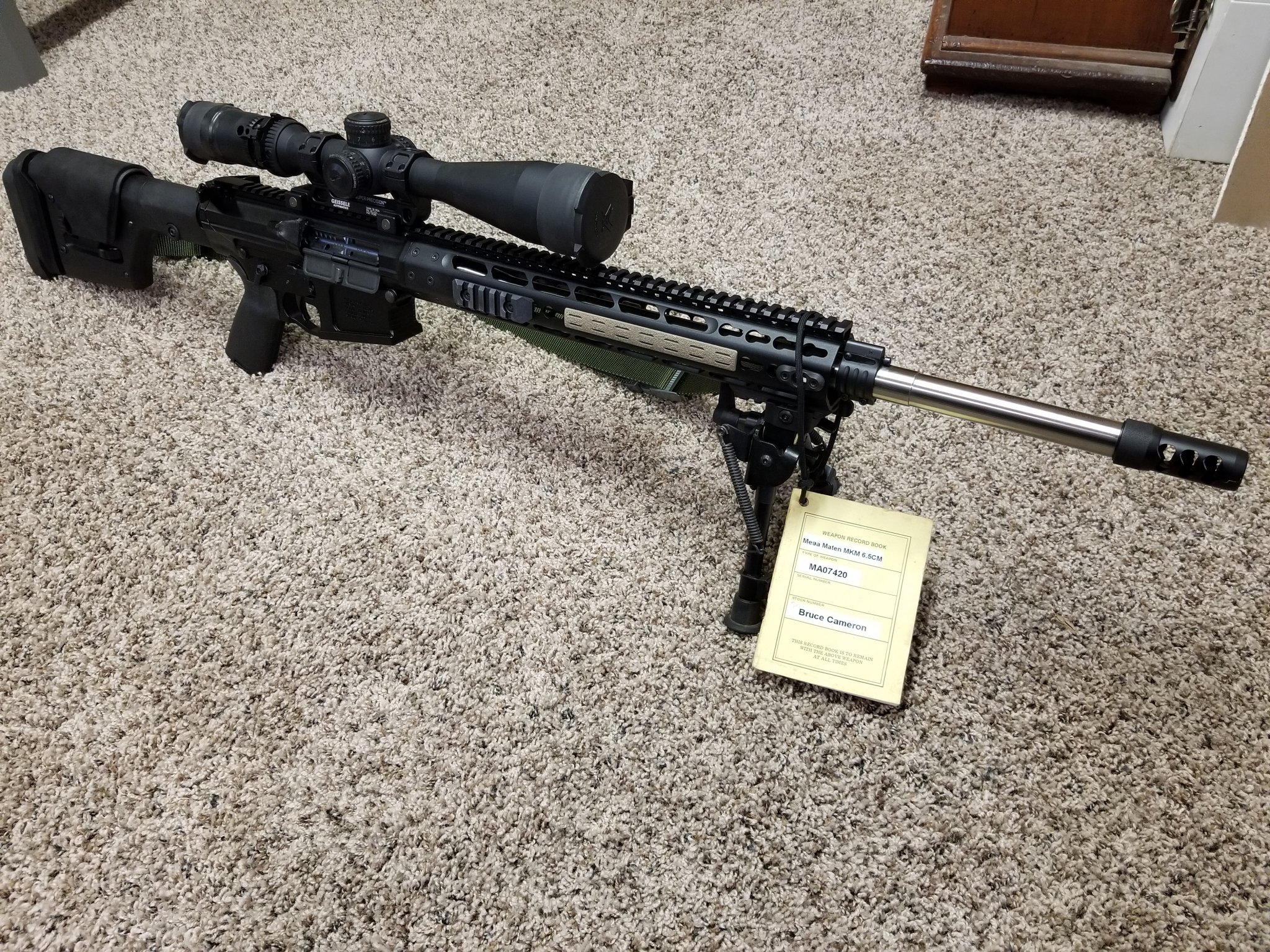

So, not to hijack this thread; but can anybody name a good maker using Bartlein OTHER than Craddock for a "10" platform?
Possibly Keystone Accuracy, if he can secure the barrel stock. He did me a 20” Krieger 1:7 +2 gas 6.5CM that is very accurate, but would be certain to specify a JP barrel extension for the build.
I got my Bartlein 6.5CM Barrel in from Craddock yesterday l. I assembled the Upper last night and took her out today for barrel break in and gas block adjustment. I only had 3 different types of 6.5CM Ammo Hornady 147 ELD, 140 ELD and 140 American Gunner. I shot one 5rd Group of each to just get a idea of how she's going to perform with handloads. Surprisingly out of this small sample the American Gunner shot the best.
You have a Craddock Barrel that doesn't shoot?
For me, it did not; for others I had shoot it, it did not. Now, I'm not the best shooter in the world; but no other gun I own has shot as poorly for me. I'll leave it at that for now.
At this moment I don't want to elaborate too much; but, a side-by-side comparison with a fellow shooter at the range with his Savage AR-10 in 6.5 was significantly more accurate with same ammo (147, 140 and some 130 Bergers - all factory). By side-by-side, I'm talking same bench, within 3 minutes of each other, no wind, same target, 100 yards.
Unless my lower (also Aero Precision) and same as the upper assembled by Craddock, is FUBAR, then I'm struggling to figure out what the deal is. 250+ rounds and I'm done with experimenting at the ammo price point of today. It's not my intention trash anybody; so if yours works I'm happy for you. I'll chalk it up as a "lesson" and move on with life.
And yes...I changed scopes (3x) with 3 separate mounts to rule out scope shifting.
Yes we have communicated regarding this issue.
Mentally I’ve written this off, but financially it’s a hard pill to swallow. Lesson learned. Cheaper than most college classes so I guess that’s the silver lining.

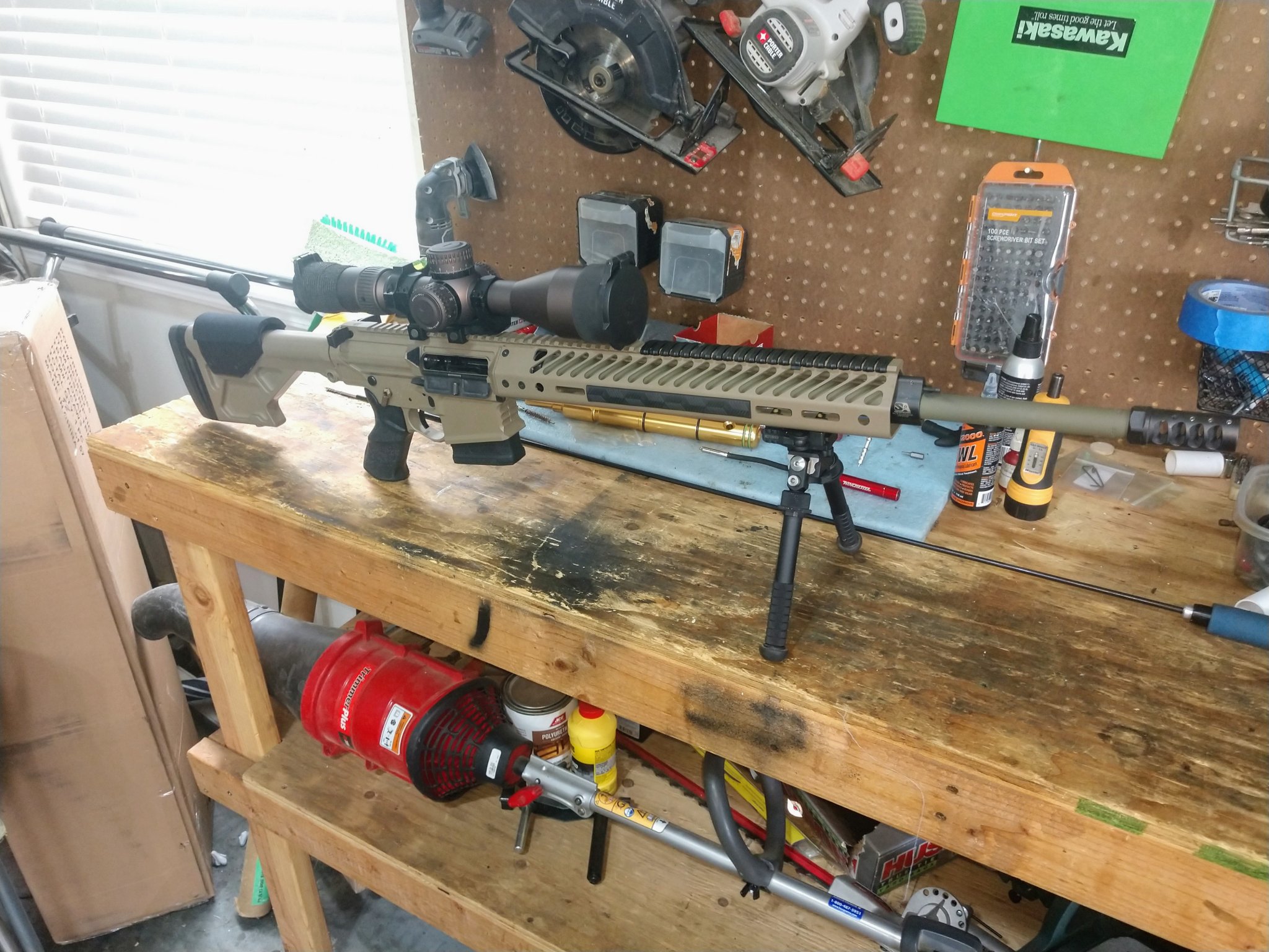

Good barrel makes all the difference. I would have had my 6.5 replacement barrel up and going today,,, but the manufacture can't seem to
get the extension pin in straight!... This is the 2nd barrel out of 5 that had a PIN NOT IN STRAIGHT!....
I believe in there barrels, at least the ar15 barrel shot clovers when I did my job.
.... 22 creedmoor ar10 barrel going out for testing today.... hope I was not wrong.
I would not glue in the barrel, or loctite 638 retaining compound.. True it up and you can't get any better IMHO. All my barrels fit Very tight, not worried about movement.
More worried if I my reloads are repeatable.
830$ for the build minus barrel and tank of a stock magpul prs gen 2. Cant wait till light weight versoin gets released..1
450$ for the barrel with a Guarantee that it will group well. (usually less than 1/2 moa is norm) by Rainier arms
For 1200$ You have a kick ars. sub MOA 6.5 cm gas gun!.. had extra triggers ect.. I have not been held back by a milspec trigger that has been cleaned up a bit... so why change.
Not sure how it gets any better than that.. well perhaps if The forward assist was deleted. No need for that in my world and only adds weight to an already heavy gun

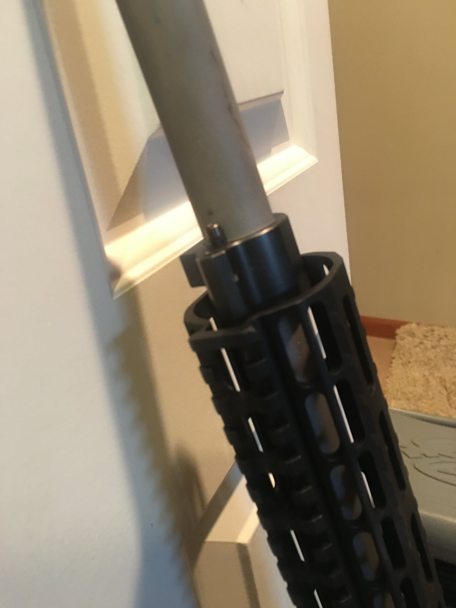

The picture below is of the 22 Creedmoor just wanted to show how the gas block is past the forearm
and yes the trigger is not milspec . I was testing if it made any difference on paper
