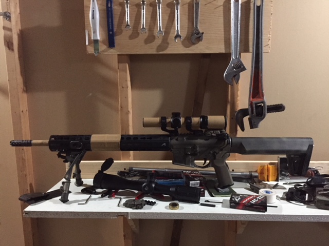

Here is the offending rifle. Should anyone be interest, the Aero Precision rail that I purchased on sale is okay. However the magpul mbus will not deploy with the rail attachment that is supplied with the rail. I'll be replacing the whole hand guard with something better made soon. The Nikon P mounts will be gone too.
