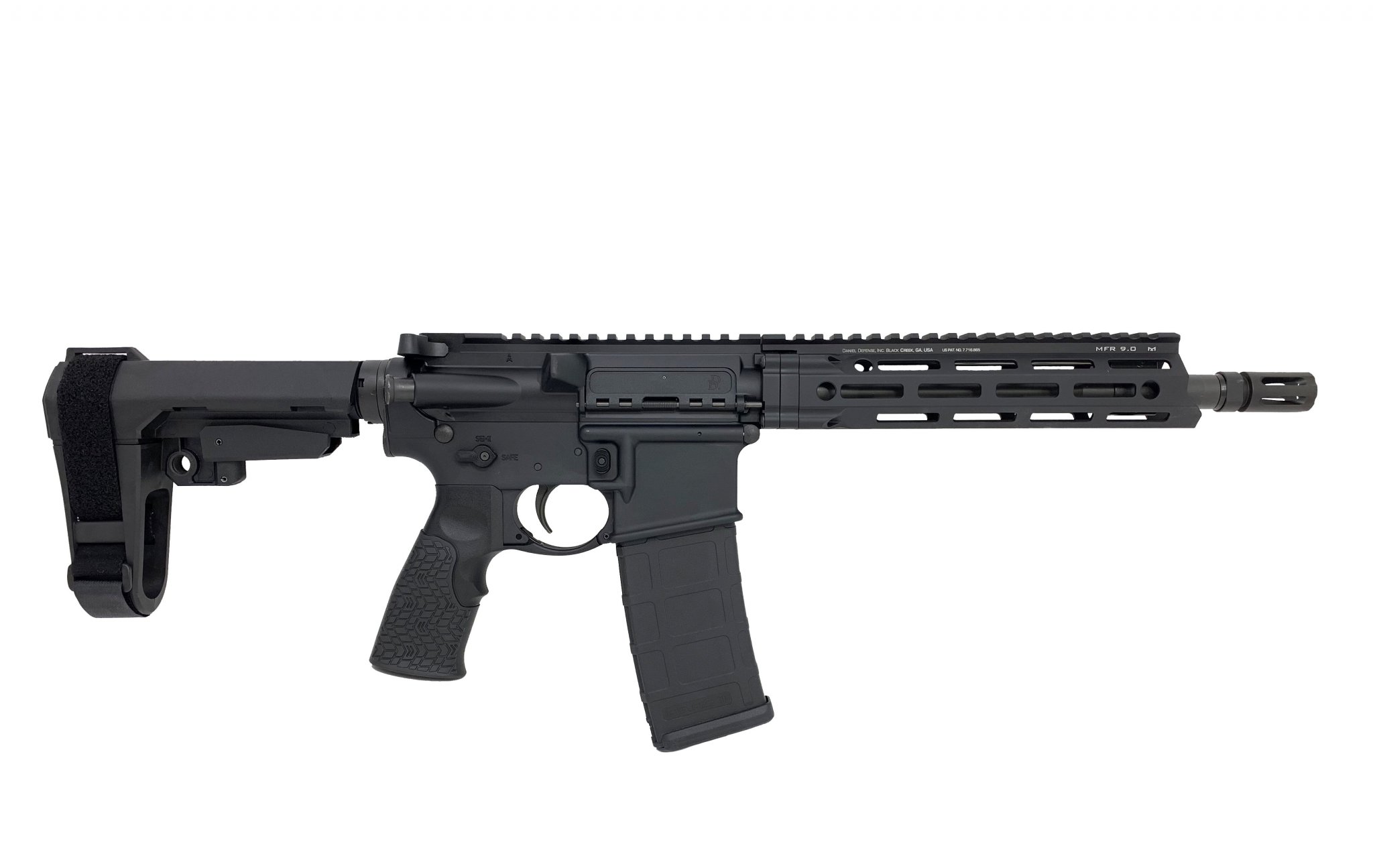

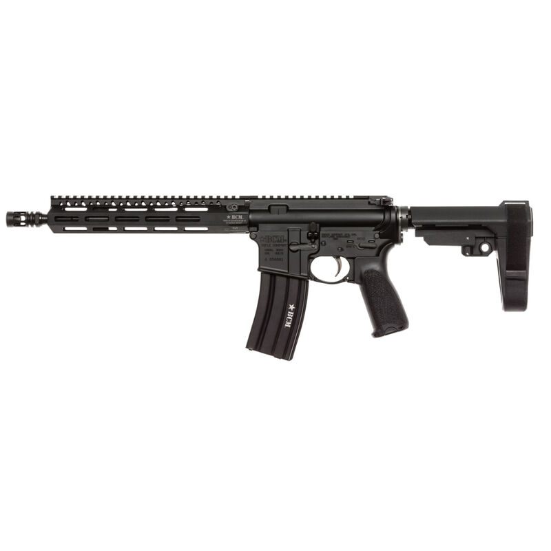

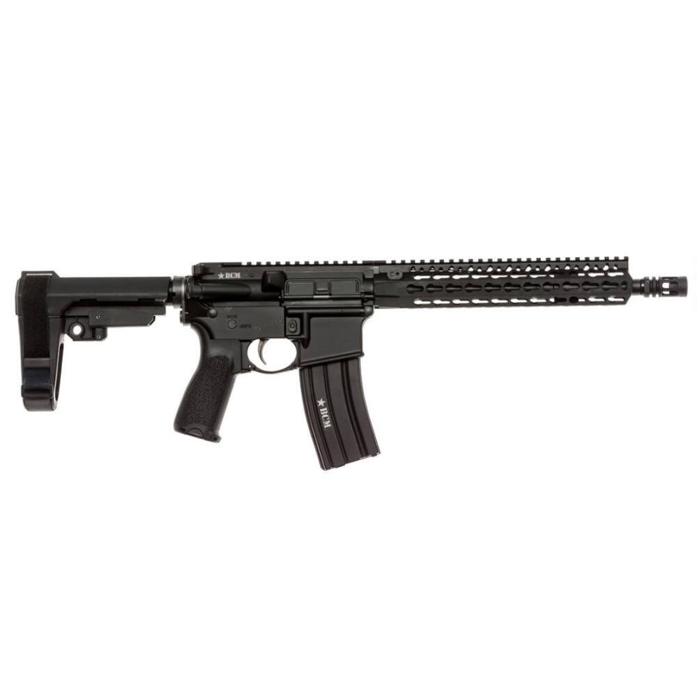

    So I'm in the market now for a AR pistol and I've got it down to two options and I'm hoping that some of you guys can give me some insight on these two choices, I know many of you probably used these in the similar SBR package as well.
    (1)
    BCM recce - 11 kmr-a AR15 5.56 NATO semi-auto pistol 11.5 Barrel sba3 brace. $1260
    (2)
    DANIEL DEFENSE V7P PISTOL DDM4V7P $1380
    Besides the obvious difference of 1" in barrel length, does the Daniel defense really have anything over the BCM to justify the increase in price??
    They both seem to have solid reputations as reliable and accurate pistols, solid free floating handguards, multiple QD sling locations. The BCM I believe is a bit lighter and also has a lighter Barrel option. but other than what I've already stated above I can't really see much of a difference between the two.
    I found a few places that have them at a decent sale price that puts them about $100 between each other.
    Here are my thoughts, both seem to be extremely reliable and accurate, I actually prefer the 11.5" barrel to mitigate the muzzle blast a bit over the 10.5.
    Both come with the sba3 brace, lower receivers seem to be pretty much identical, if one of them has a tensioning screw please let me know I can't seem to find any information online to show that there are any differences other than the DD now comes with the Ambi safety.
    Triggers seem to be a wash it's another thing I can't seem to find much of a difference between the two. (Doesn't much matter whichever one I get is going to get a Geissele upgrade anyway)
    I actually don't care for the fact that the DD now has a plastic dust cover.
    Right now I'm leaning towards the BCM I like the different Barrel options and 11.5 Barrel length, has a hybrid muzzle brake comp. Price-wise looks like it's going to save me a couple hundred bucks maybe even more if I can get it lower than I've already found for the 4th of July sales.
    No matter which one I buy it's going to get an ambidextrous charging handle, ambi safety, law Tactical folding stock adapter and Geissele trigger, topped off with a Trijicon mro patrol. I also read somewhere that the BCM receiver extensions are A5 length and I've sent BCM a email for clarification on that as well.
    Thank you for reading and any possible help is appreciated.

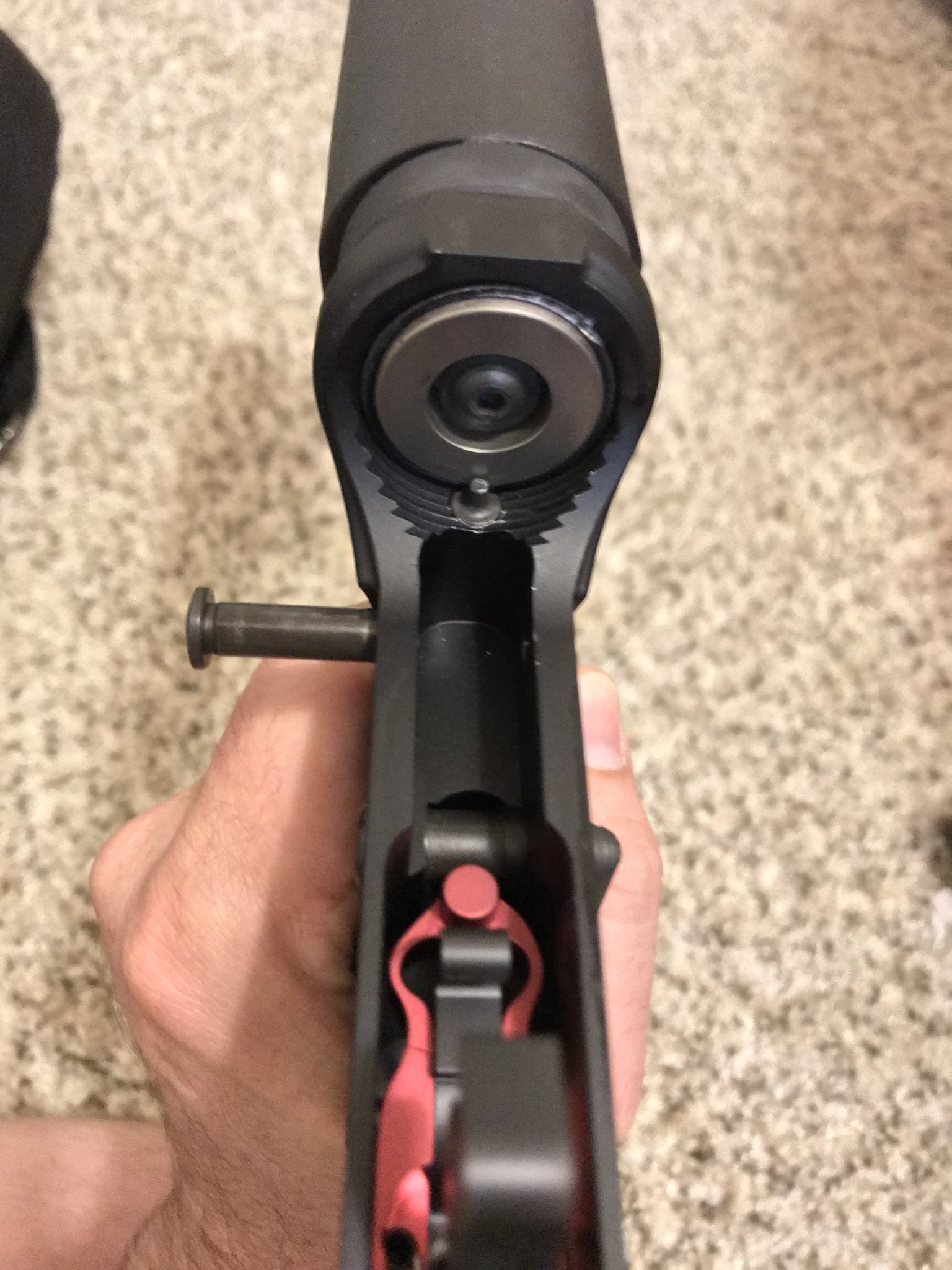

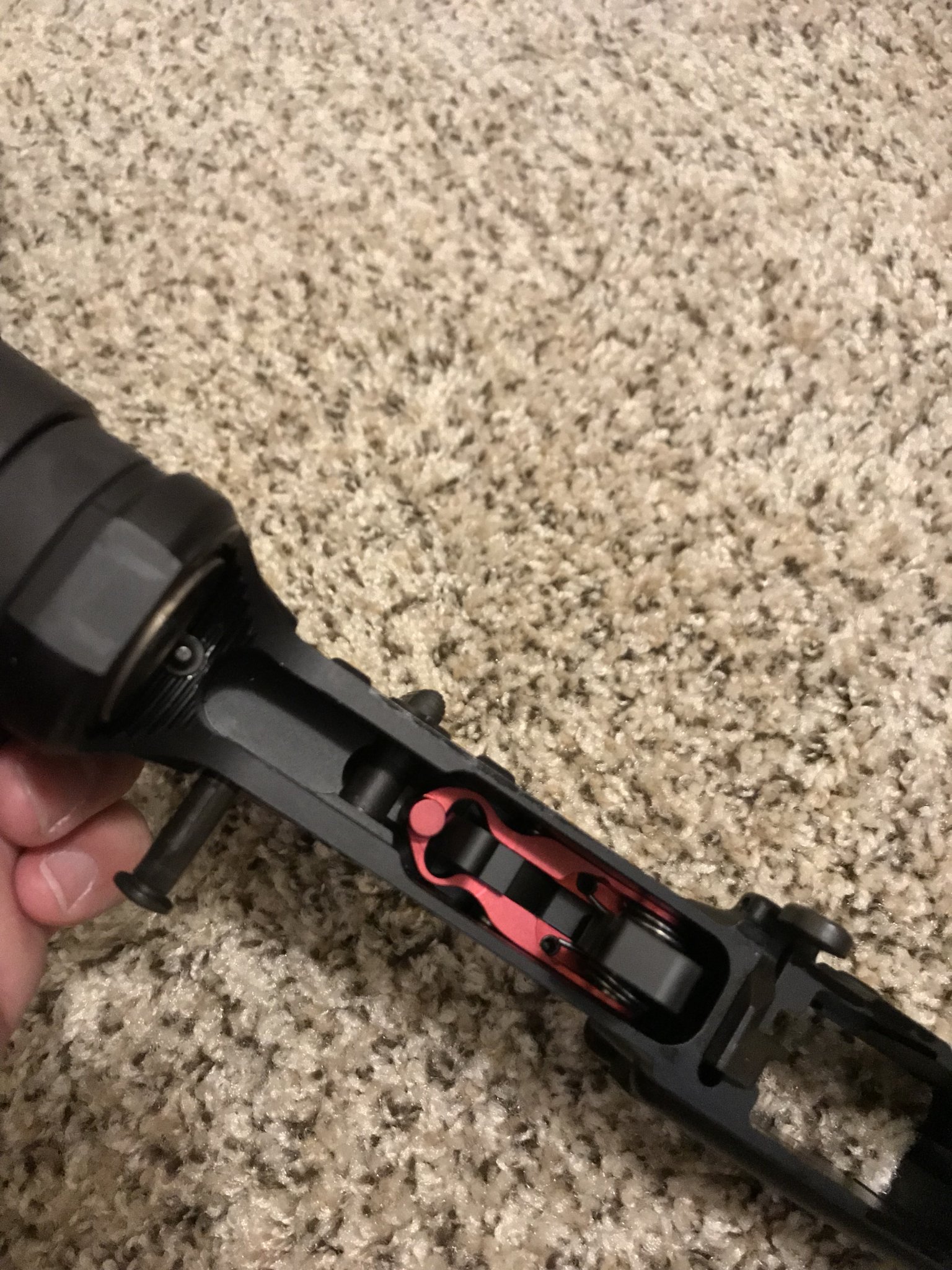

    I don’t believe that BCM uses tensioning screws in their lowers. I’ve taken a picture of the inside of my lower as an example (again, being new to AR’s, if I’ve gotten a picture of the wrong place in the lower, let me know and I’ll send a mew one.
    Reactions: bigjake83
    View attachment 7104857View attachment 7104858
    That's the correct area, and thank you for taking time to snap a few photos for me.

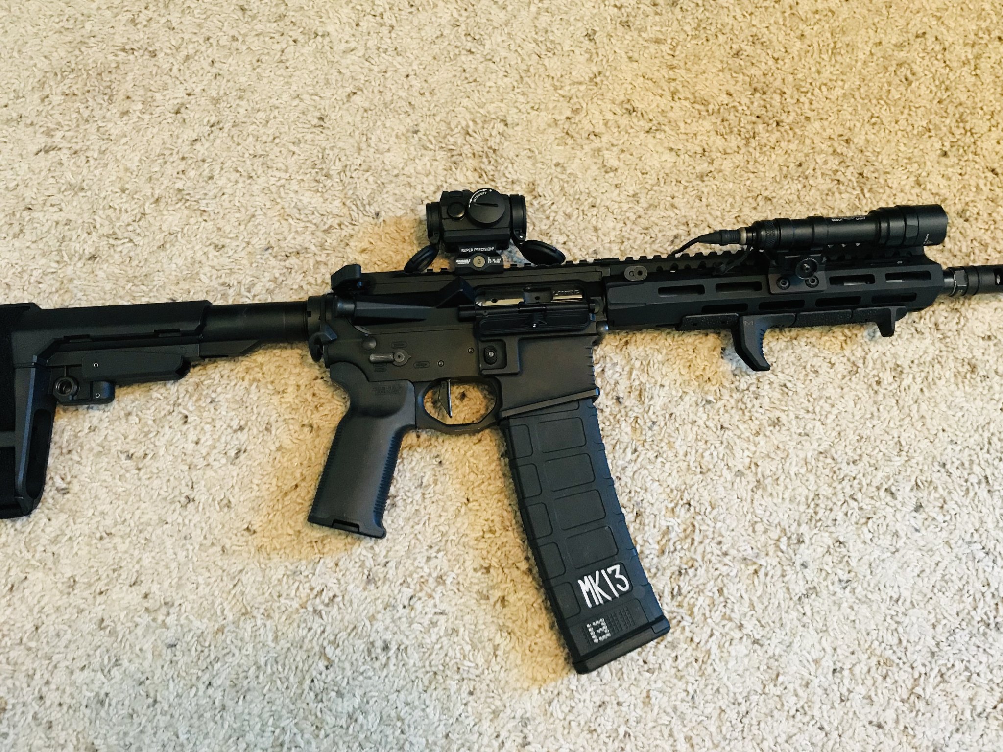

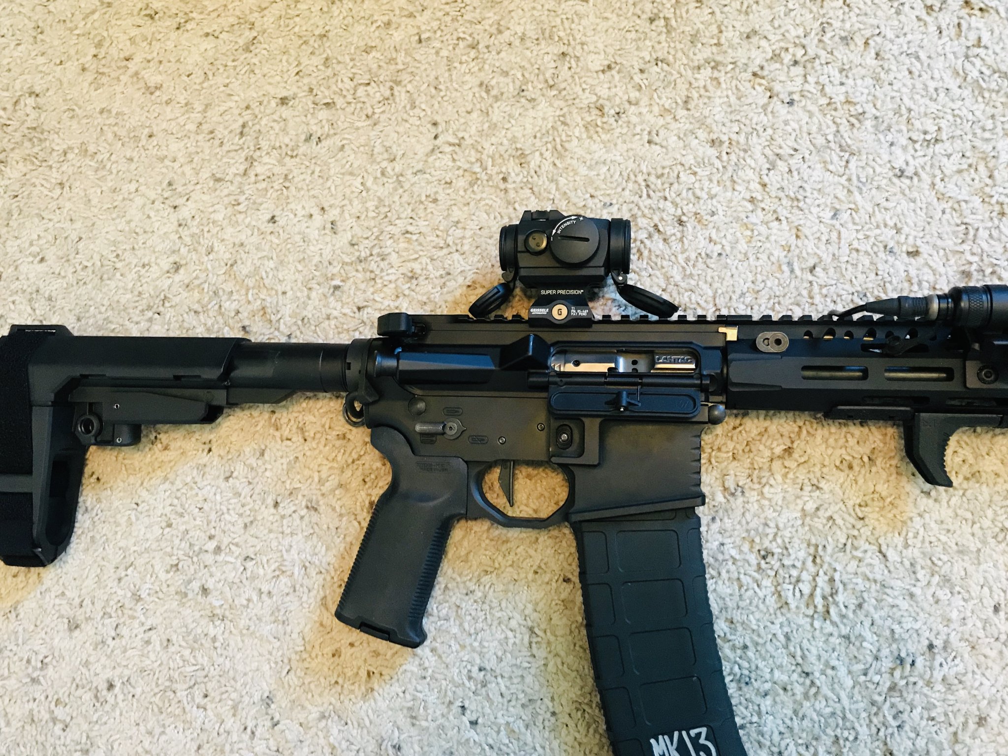

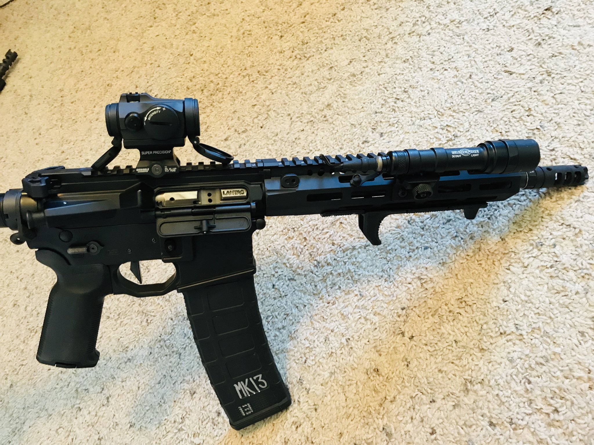

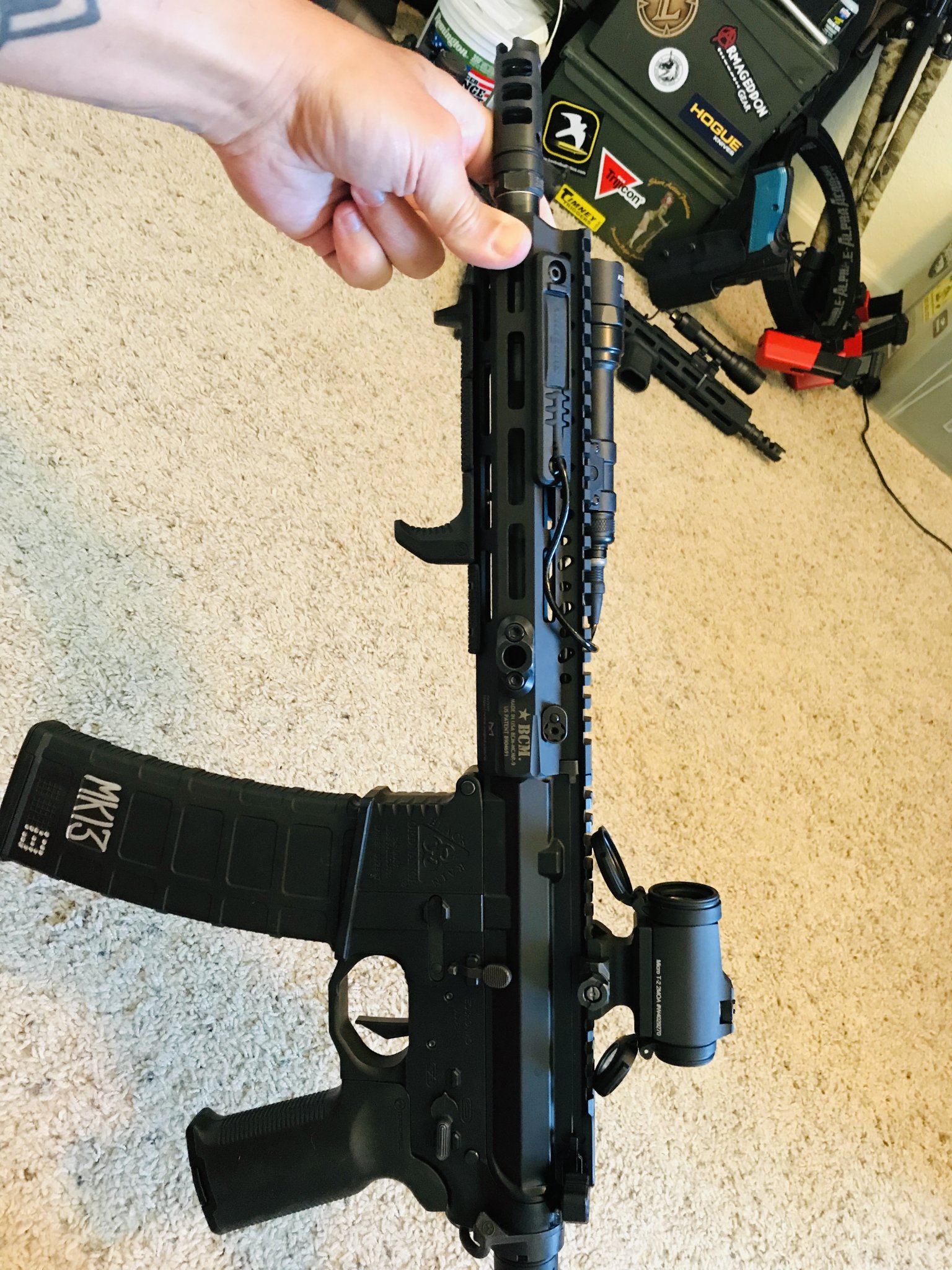

    I just recently bought a 10.5” AR15 Upper from another Hide member, and it’s my first AR pistol. Like you, I’m not new to gas guns, but this was my first with an AR pistol just cuz of the legal “do’s & dont’s” with them. Anyways, my upper consists of:
    -10.5” Ballistic Advantage Hanson profile barrel, 1-7” twist
    -Lantac Dragon brake
    -Seekins AGB
    -BCM Mlok handguard
    -Aero Precision upper
    -Aimpoint T2 on Geissele mount
    -Surefire M600 Scout w/ pressure pad
    -Magpul hand stop
    -Ambi Raptor charging handle
    -Lantac E-BCG
    Lower is:
    -Black Rain Ordnance billet lower
    -Magpul K2+ grip
    -Ambi Safety
    -SBA3 pistol brace
    -Geissele SD-3G
    -JP SCS
    -Magpul ASAP sling mount
    So far so good, and it’s just a blast to shoot! So much so that I’m already buying parts for another AR pistol build (12” barrel this time on another BCM4 upper).
    Anyways, I have zero experience with DD, but I can say that BCM makes very quality gear (uppers, barrels, handguards, etc), but I’ve never had one of their complete rifles.
    The adjustable gas block combined with the JP SCS made this a breeze to get it shooting super soft with perfect 3:00-3:30 brass ejection, and zero twang.
