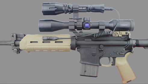

I have and H&K MR 762 which is my most accurate 308 gasser and is capable of 0.5-0.6 moa when I do my part with my match hand loads. I just put a Bushnell Elite FFP 3.5-21X50 in an ADM QD Recon mount and haven't had any problems with it.
