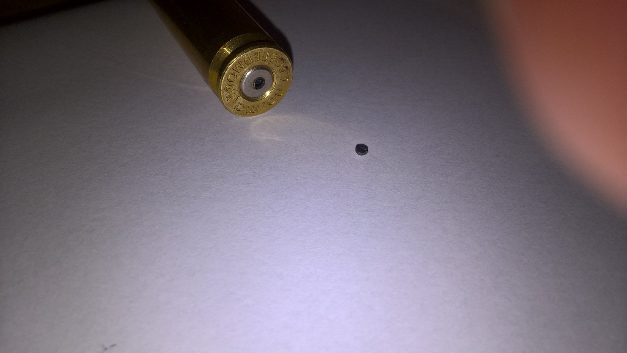

I`ve just had a look at the fired cases , very odd , blown primer, in the pic you can see a piece protruding from the primer and when I removed it theres a hole in the primer ...
This is most bizarre. To me it looks like the rifle fired without the firing pin striking the primer (so no trigger malfunction). The pressure from the shot caused the primer to flow into the firing pin hole in the bolt face. This hole is unsupported because there is no extended firing pin to stop the material flow.

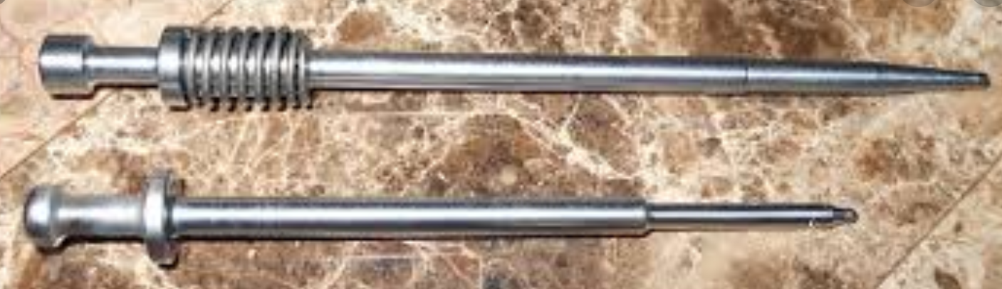

FWIW my GAP10 does have a firing pin return spring to prevent just this. The AR10 firing pin has more mass. I'm not sure if this is standard across all AR10 rifles. I would disassemble the bolt carrier assembly to check this.

You may just want to spend the $2 to do this right :) https://www.wolverinesupplies.com/productdetail/amlea1011_armalite-ar10-firing-pin-spring.....Or contact whoever manufactured this and have them correct it.

After noticing this topic I'm going to speculate something. The hole in the primer is from over pressure. (don't ask how I know) the primer does not get flat because the hole vents the pressure.
I'm willing to bet the op has the flat disks in the bolt and they are getting stuck against the firing pin causing it to strike primers. Or the hole blew alot of debris and that is causing the fireing pin to remain forward enough.

Yep, if the rifle has pierced any primers completely strip the BCG and bolt head and look for little pieces of primer cups trapped anywhere. Also make sure the firing pin didn't get torched and sticks in the bolt.

This, you may have had a pierced primer "disc" kicking around in the FP channel on the bolt... or possibly in the Timney Trigger works.
And a PP disc( or even multibule ) can lodge against a FP causing an issue. Or down in the trigger works...

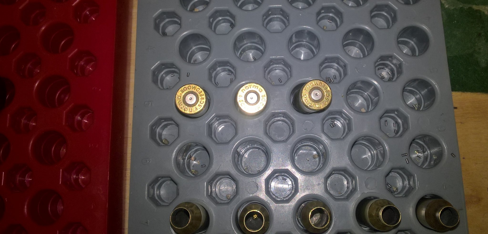

After a bit of thinking about it I decided to run some primed cases through (no powder , no bullet) I just released the bolt on all three of these and did not pull the trigger (the trigger did not fire on its own accord either ) You can clearly see on the pic that the firing pin is indenting the primers purely from inertia , these primers didnt fire and are still live so if I`d not fully seated a primer it would fire and maybe even with a fully seated primer , next step is to change the buffer spring and try some more primed cases .

Dimpling of the primer is normal since the firing pin is floating. However the amount of dimpling you’re showing is significantly more than anything I’ve ever seen. Usually it’s just a tiny spot that’s hard to see.
Reducing spring weight and firing pin weight may help here.
Lennyo beat me to it. Dimpling of the primer is normal in a large frame gasser but they shouldnt be igniting..
