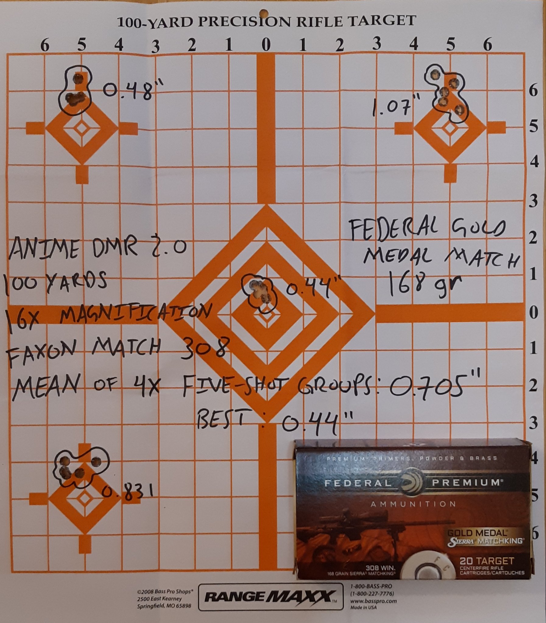

Planning a 16 inch "Heavy DMR / Light SASS" .308 AR10 build. I had a couple of questions about barrel and bolt considerations. I'm hoping to build a rifle that consistently does 0.5"-0.75" five shot groups at 100 yards with some flavor of factory match ammo.
First, what sort of accuracy gains are to be had by buying a "matched" headspaced bolt and barrel set from someone like Faxon or JP? Is it fine to save money by buying an "unmatched" set from the same manufacturer? What about mixing manufacturers, say a Toolcraft BCG and a Faxon barrel?
Also does anyone have range reports or accuracy reports for the Faxon Match Fluted .308 AR10 barrels?
I had one of their "gunner/intermediate" profile .308 barrels in an older build and it was an honest 0.9" five shoot group barrel at 100 yards with 168 grain FGMM.

Turns out the thing shoots pretty well!
Reactions: Mike_in_FL
