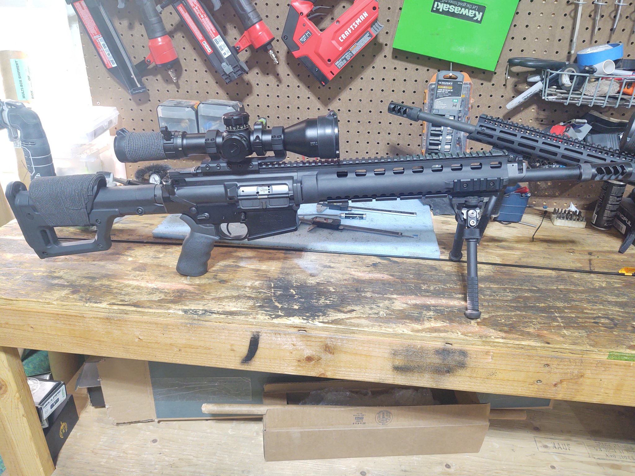

3.8oz is way too light, you should be running a H2 4.65oz at a minimum. I run H2 on all my rifles and I don't use suppressors.
This is what you need..
This rifle is a 18" 6.5CM with rifle length gas..
View attachment 8094888View attachment 8094889
