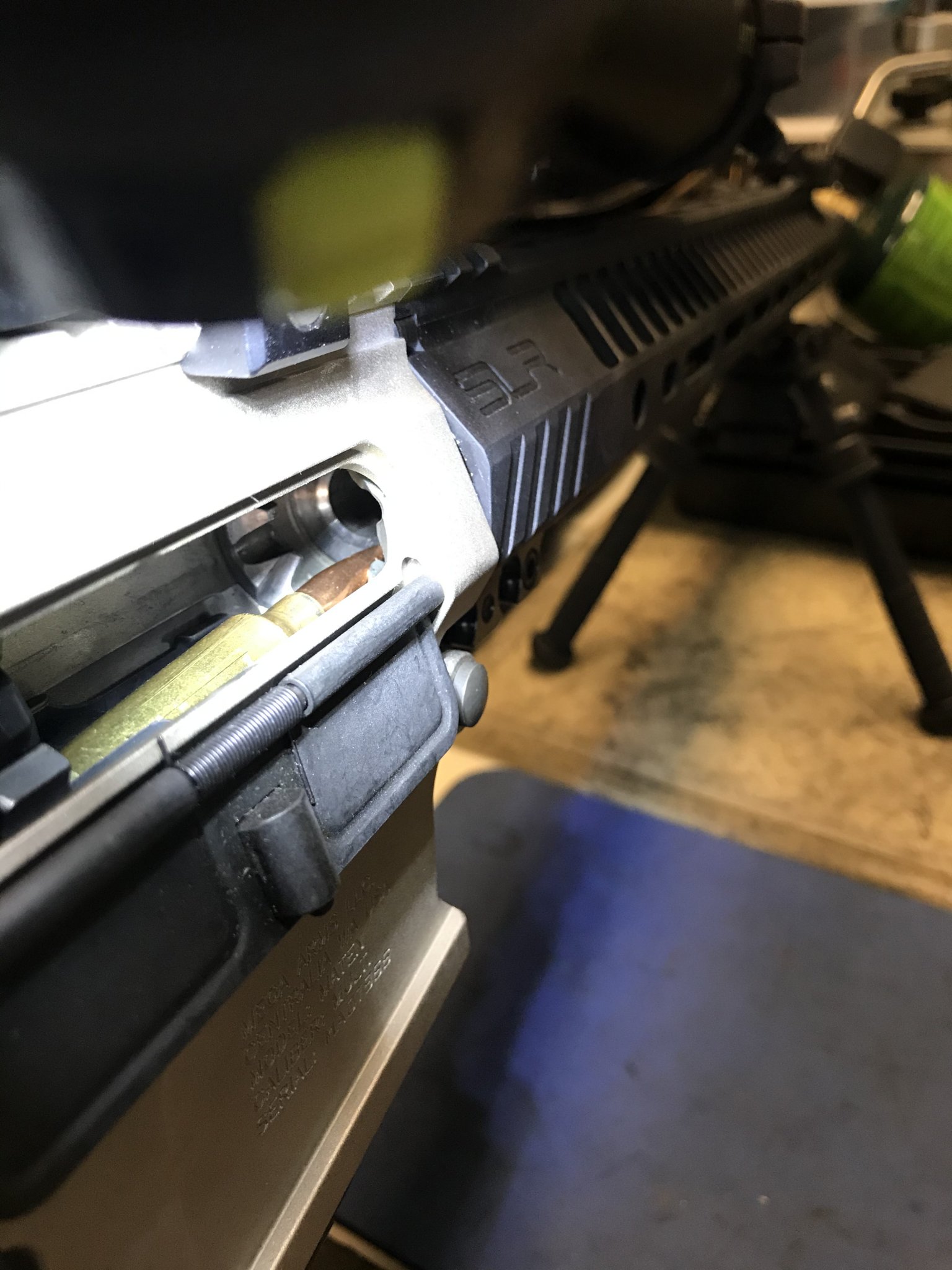

    Have a recently chambered Krieger 6.5CM that is having familiar issue of secant shape bullets ie. 123/136/139 Scenars, Sierra MK’s, BTHP’s of a variety bumping into breech end of barrel. Did not spec the JP extension as I now know I should have, and not having asked which extension would be used and what configuration of chamfer or cone would be, made an incorrect assumption this would be addressed by smith. Cone is 30 degrees, and not broad enough to lift secant shapes up to chamber-which am aware is really the job of the extension and not the cone, though a correct JP would likely function with the narrower cone. The secant shapes bump into backside of barrel, either mashing nose, pushing bullets another .050-.100 further into case or both. Nosler CC’s and 120 Scenar L’s appear they will feed, but also require short loaded OAL, not really offering optimal performance of the longer, more efficient shapes of other Lapuas, which I have accumulated enough of to go well past this new barrel’s lifetime.
    All that said, what options do I realistically have to work with? The Krieger shoots single fed really well, but that’s neither the design or option. Can a JP be refitted without misalignment of gas port and extension pin and still headspace correctly, or not a possibility? I can send back to have a broader and shallower chamfer be machined-which seems logical-but without his guarantee rounds will chamber correctly. Is there a spec for proper cone dimensions that do allow for correct feeding, absent the proper extension? Or should I just resolve to shoot the lower BC Nosler CC’s or 120 Scenars and call it a day? Am only about 55 rounds down range to date, and TX weather has kept me off range, but is now warming up again.

    Need to work with various mags, but in trying my ASC and Magpuls, same issue. Understand your suggestion, and might play with feed lips on an ASC and see if an improvement. I need about 3-4 meplat diameters to get up on the existing 30d cone. Appreciate your response.
    Do not know-appears well made, smooth, but absent the proper dimensions in ramps to mitigate issue noted. Almost surely meant for a 308 application, and in combination with narrow cone, limits my options of bullets to those with more tangent ogive. Barrel is extremely well executed with this exception, and my oversight not to have specified a JP extension. Do know Krieger make one specifically for 6 and 6.5 mm LR/AR large frame, but is proprietary and not available for sale. Options at this point are seeming pretty limited.

    Yes, I have. No 100% certain option to refit an extension, can modify cone, but need a known spec that works and does not leave case head unsupported. Or shoot what does work. Should be out to range in next day or two, but TX weather has been uncooperative of late.
    Pictures would help.... proper feed cone is your answer. I've seen this plenty of times.

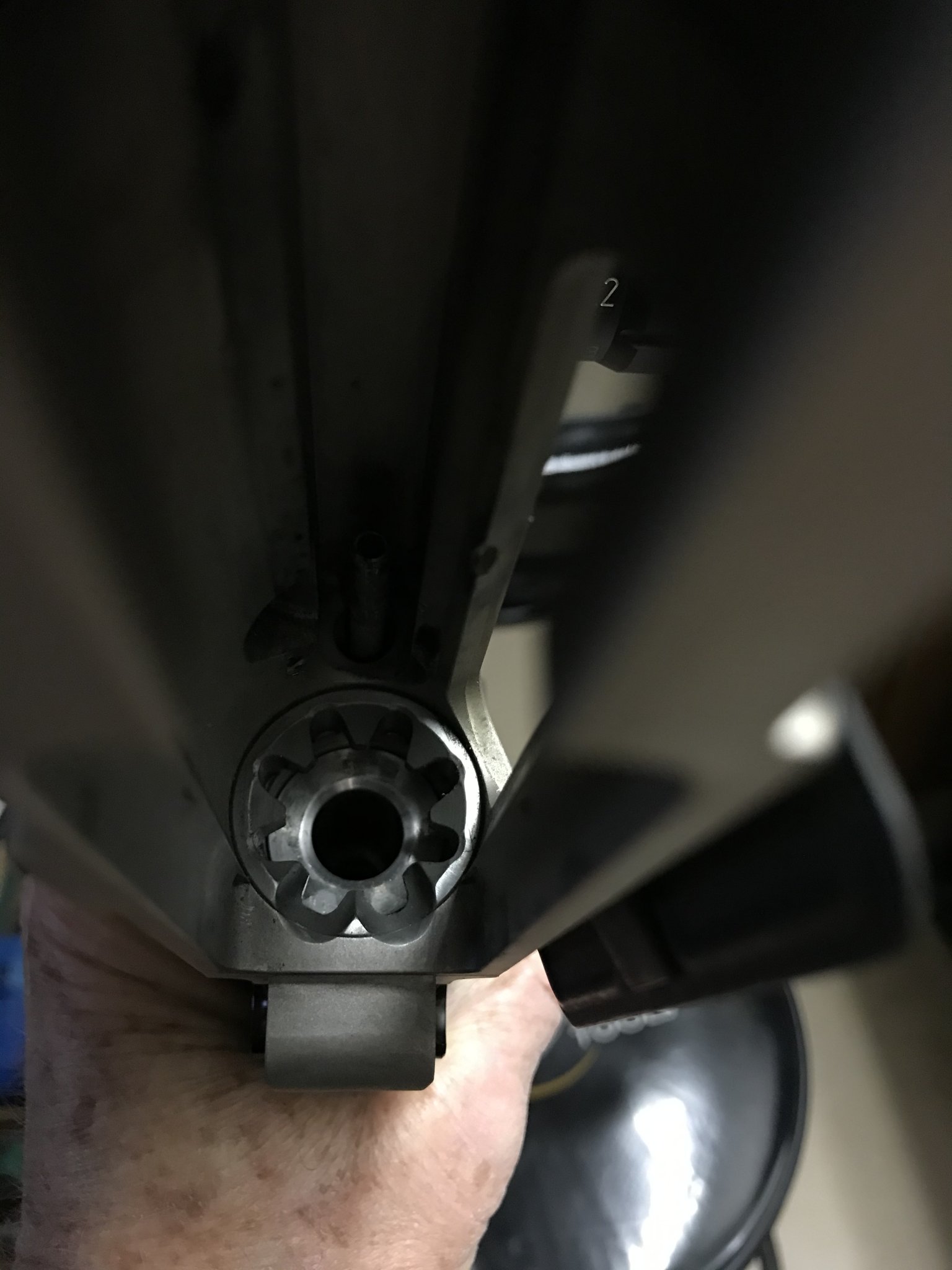

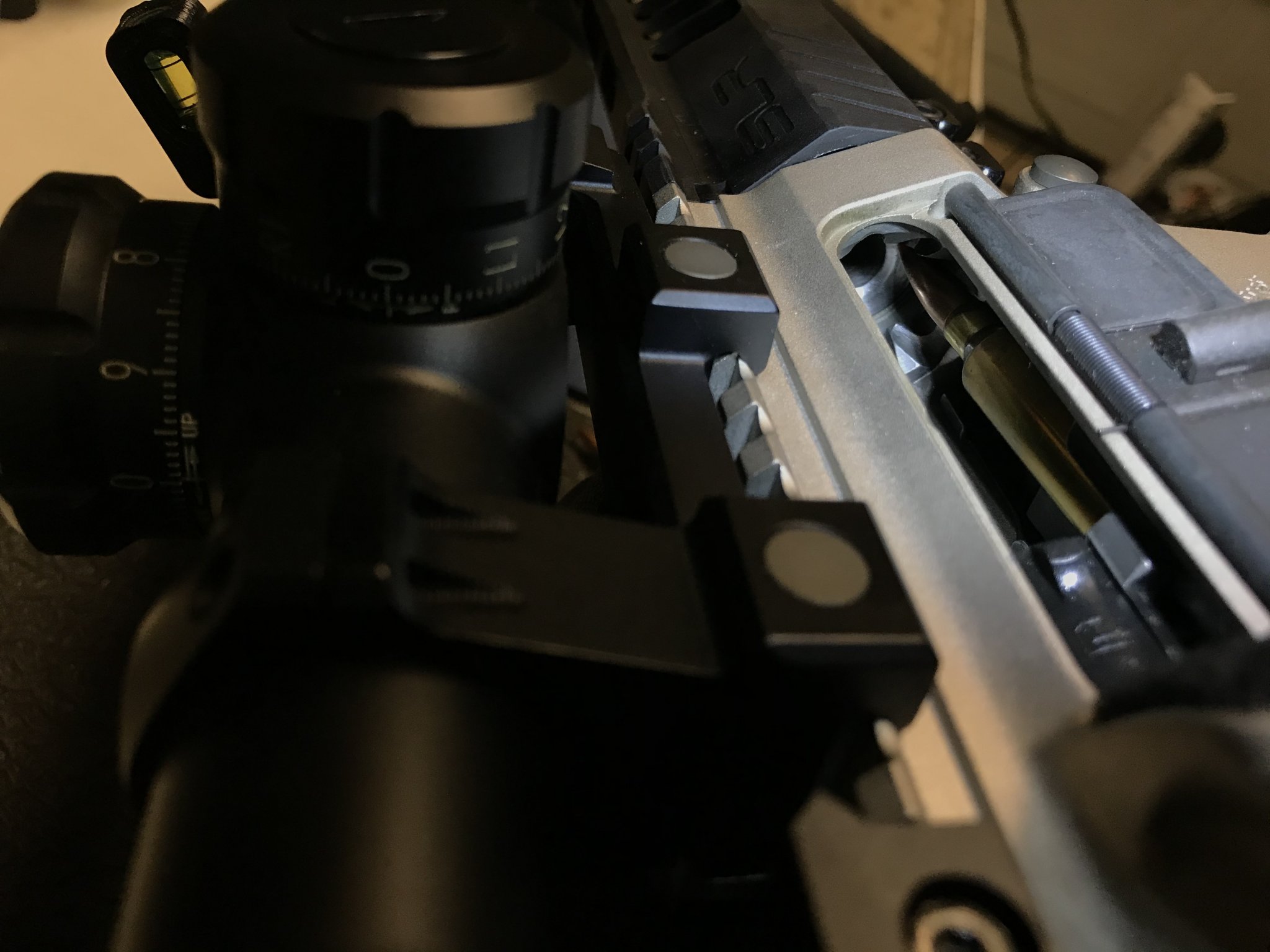

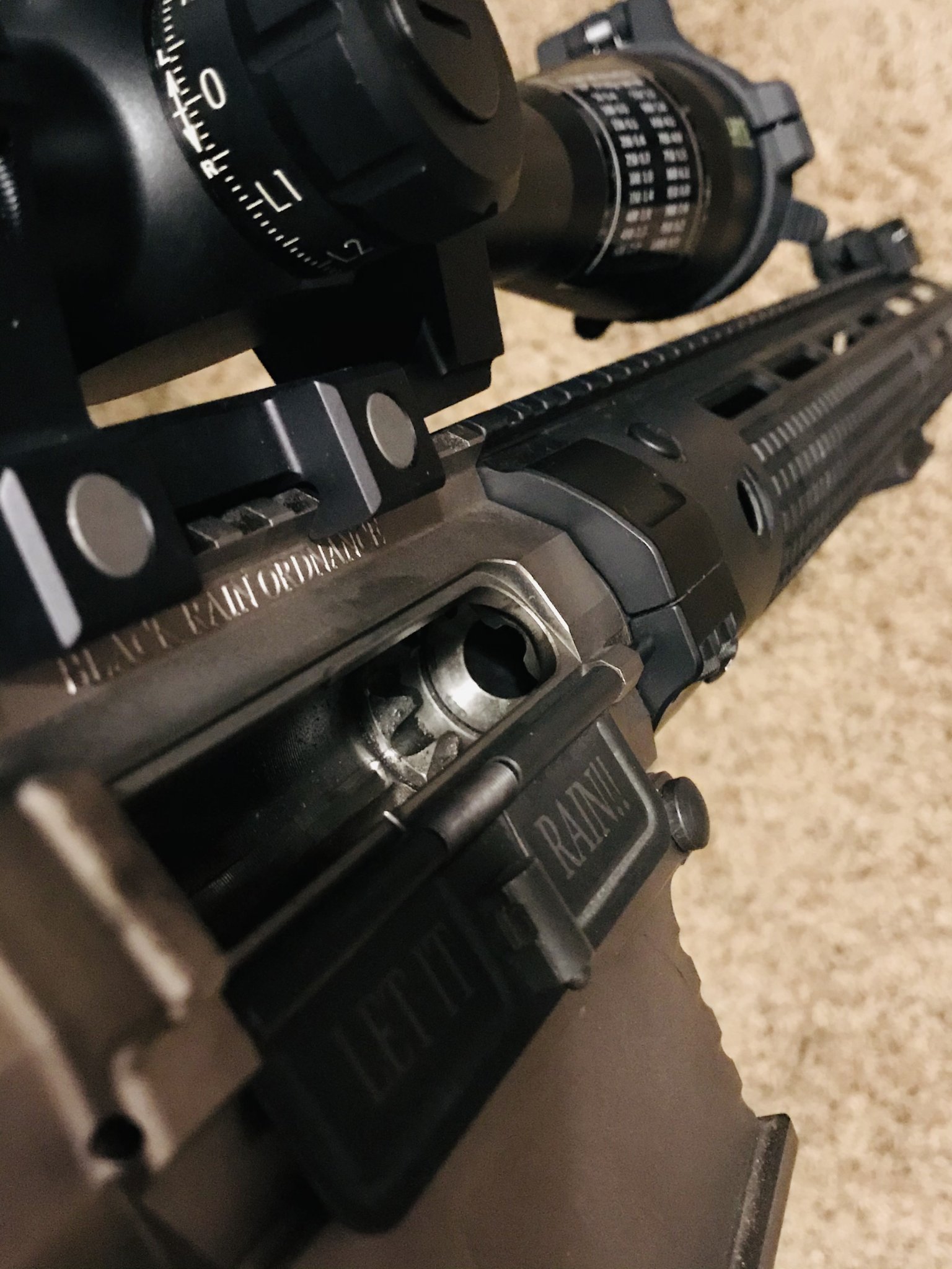

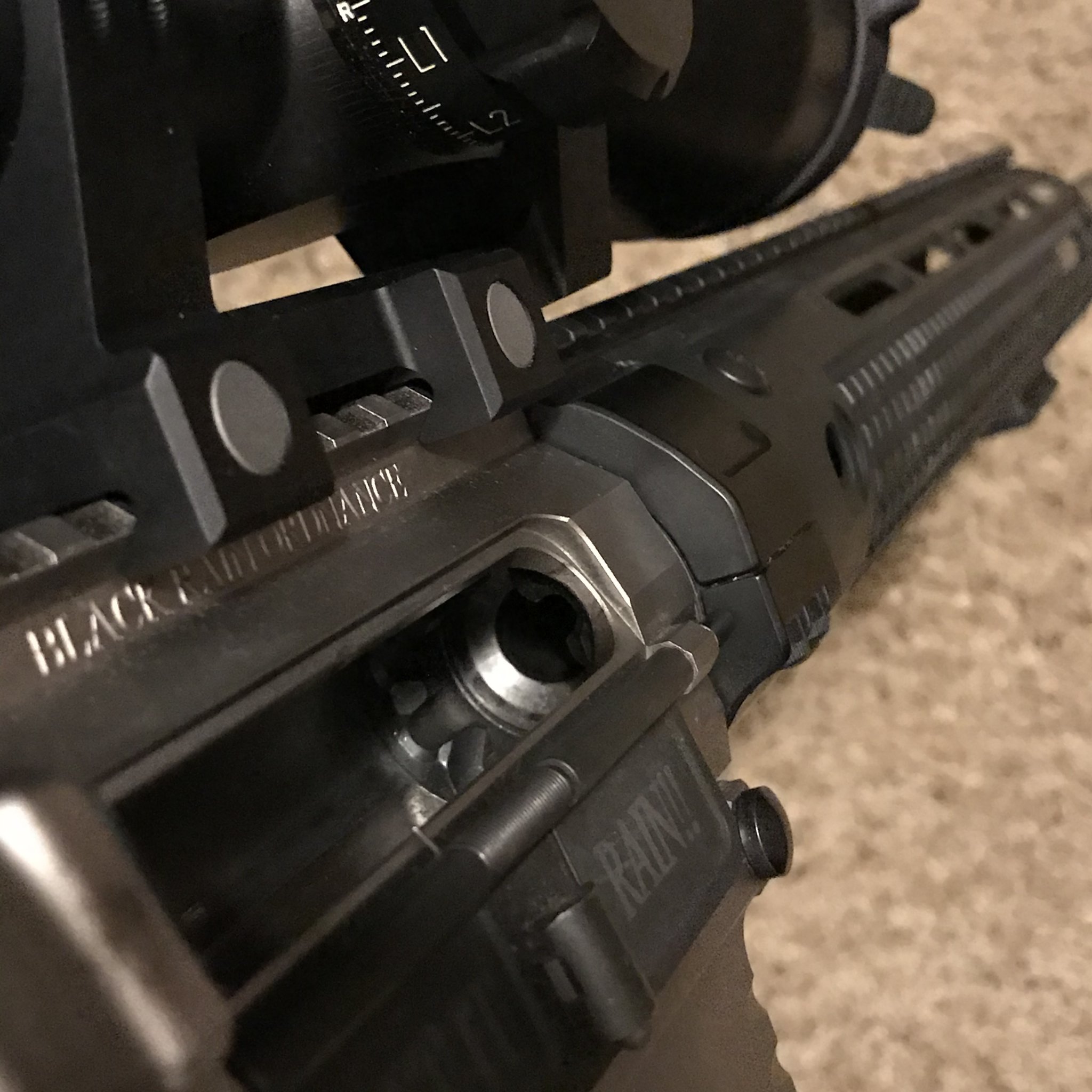

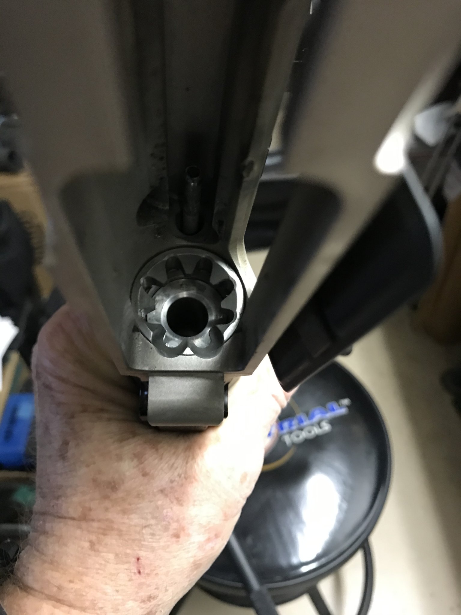

    Here’s a few, with pics of both a Bartlein and a Lilja that do work, regardless of magazine used. Given existing cone is 30 degrees, smith has requested a ‘spec’ for him to follow.
    B0959286-F7CF-453B-8573-1F7149FB71C3.jpeg763BB831-63F0-4202-8C1D-D76C04F0CB53.jpeg245172A3-D9BF-400A-AF1E-F50D6817E044.jpegDFE5BD20-9359-49DE-A8F2-3EB708FBE1CE.jpeg8E4BFC1D-F5CA-4E15-B8E5-14C9C3E26156.jpeg
    First two above, plus attached. Last two on Black Rain receivers are a Bartlein redone by Bohem and a Lilja direct from their shop.

    The reason I ask is because I have a 30 degree (or 60) whatever you want to call it, feed cone cut about .035” deep. It’s a 6 creedmoor and feeds the vmax and Eldm no problem. But with the berger hybrid it slams into the back of the chamber. I’ve read of guys running the 105 hybrids in 6 creed ar10’s. I could push the feed cone deeper which would make it wider, but it can’t go much deeper without loosing chamber support. Does anyone have a feed cone angle and depth they have used reliably with berger hybrid bullets in 6 and 6.5 ar10’s?

    I wound up not getting a satisfactory response from original smith after sending it back, so forwarded it to Josh Kunz at PVA and he installed new barrel extension, which reqd a new and shorter base/shoulder dimension. All doable with dedicated handloads, just no interchangeability with std chambers. And after all, and with a large stash of 140 AMax, which continues to produce best accuracy, am good with It as it sits. It’s a Bartlein, and will shoot.
