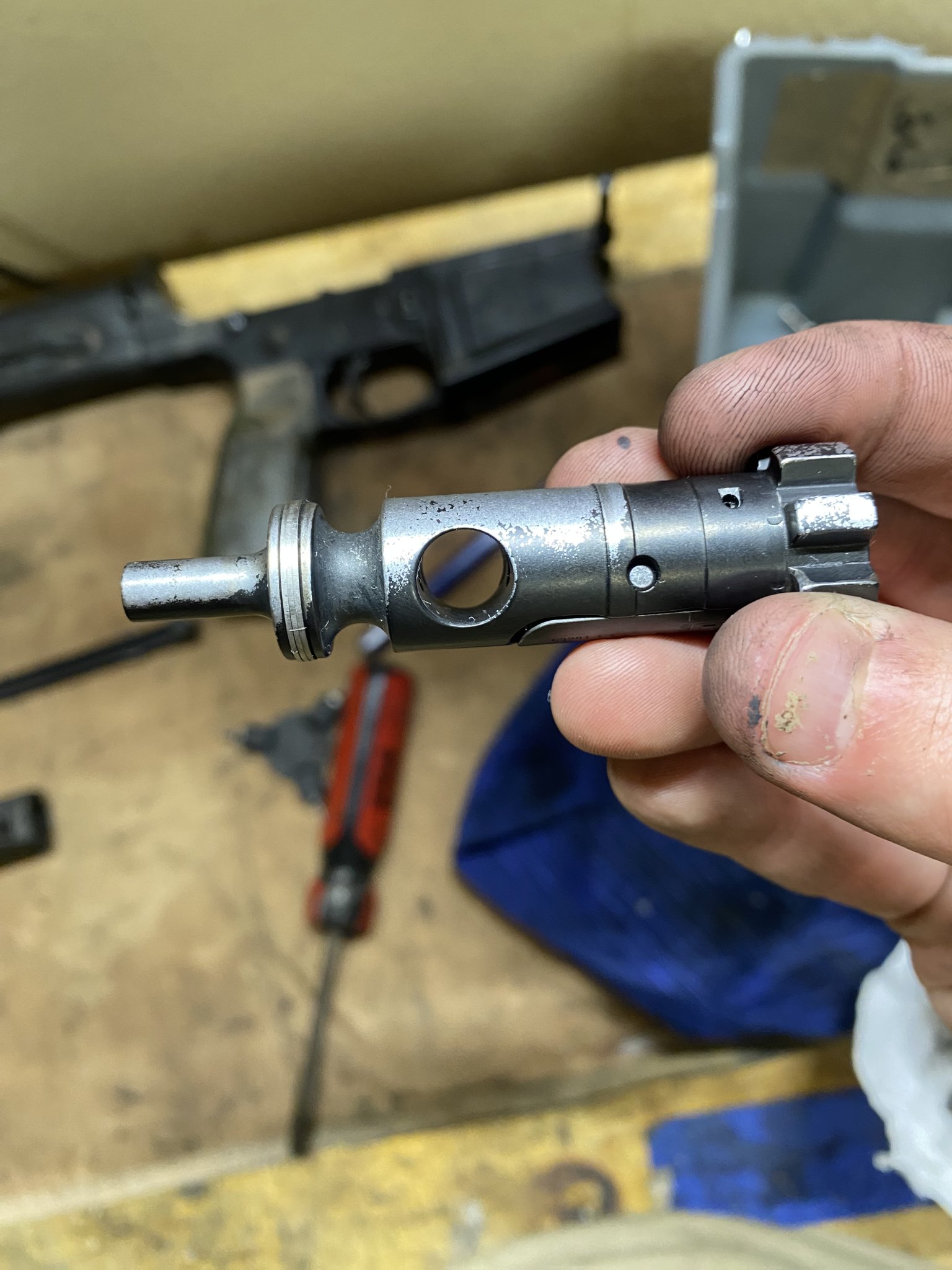

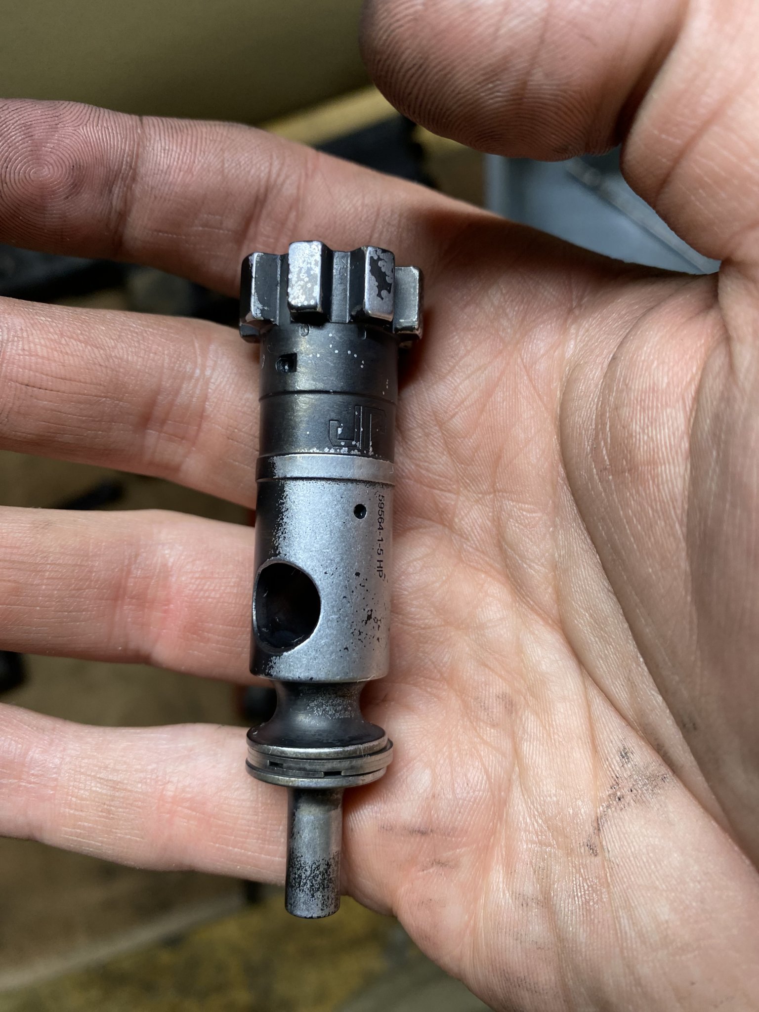

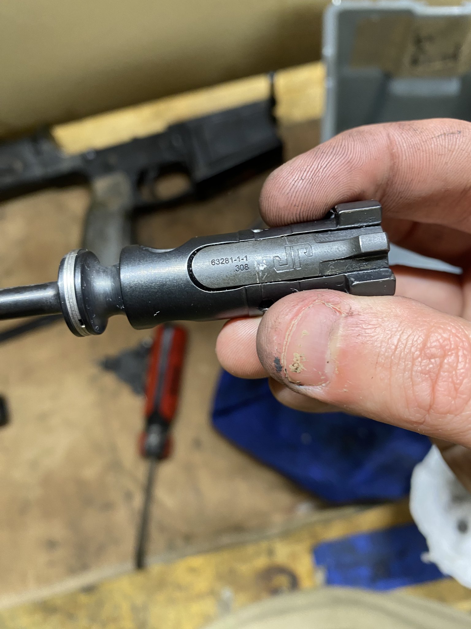

Hello snipershide, I’m back with another AR10 problem.
I had sent my barrel back to criterion to look at. They bedded the barrel, headspaced the bolt, and gave me a JP high pressure bolt. It was working fine but then suddenly with small base die Handloads and with factory hornady and FGMM ammo it simply will not reliably chamber the ammo. With duramags and PMAGS, the ammo will not chamber every other round or every couple of rounds.
I took the bolt carrier apart (fail zero bolt, JP high pressure bolt and firing pin) and I noticed this weird wear pattern on the top of the bolt. Does this mean my carrier needs to be replaced? I’m thinking maybe it somehow got damaged over the years (it has about 3500 rounds on it) but it isn’t cracked or warped and nothings loose that I can see.

Attached are pics of the bolt. Nothing seems to be warped and I can cycle the bolt just fine but ammo will not reliably chamber. I think the carrier is damaged but I wanted to get a second opinion before purchasing a rubber city or other carrier. Thanks!

Also, I don’t see whatever you’re trying to show in the pictures of the bolt.

Attached are pics of the bolt. Nothing seems to be warped and I can cycle the bolt just fine but ammo will not reliably chamber. I think the carrier is damaged but I wanted to get a second opinion before purchasing a rubber city or other carrier. Thanks! View attachment 8631850
It's not the gases and you're not having bolt rub, I've spoke about this in a few threads on here.
JP put out a bad batch of QPQ coated bolts a while back, they are well aware of it. Call them up and talk to Dave, send it back and I'll give you a new one.
As an update to my first post, I see what you’re showing in your pictures.
