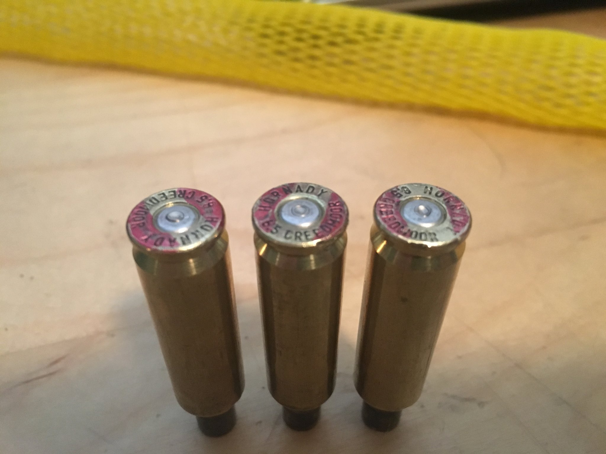

2. Primer Ignition
Took the assembled rifle out to the range this weekend for first test firing. Slammed home the first round, pulled the trigger, and nothing. Primer was not even touched. Confirmed BCG is fully seated using fwd assist...still no bang. Took the BCG out and compared to a friends 308 bcg, looks like my firing pin doesn't stick out far enough. Compared both pins, look to be same length. Compared bolt lengths (not carrier), and my bolt looked much longer. Filed the back of the bolt slightly to let the firing pin stick out more, and that seemed to ignite primers 80% of the time. Issue remains is that the primer looks to be flowing back over the firing pin like an 'outey' belly button. Sorry for the terrible analogy.
Let me know if anyone has any suggestions on my above issues. Thanks in advance!
Here's a picture of the primers
