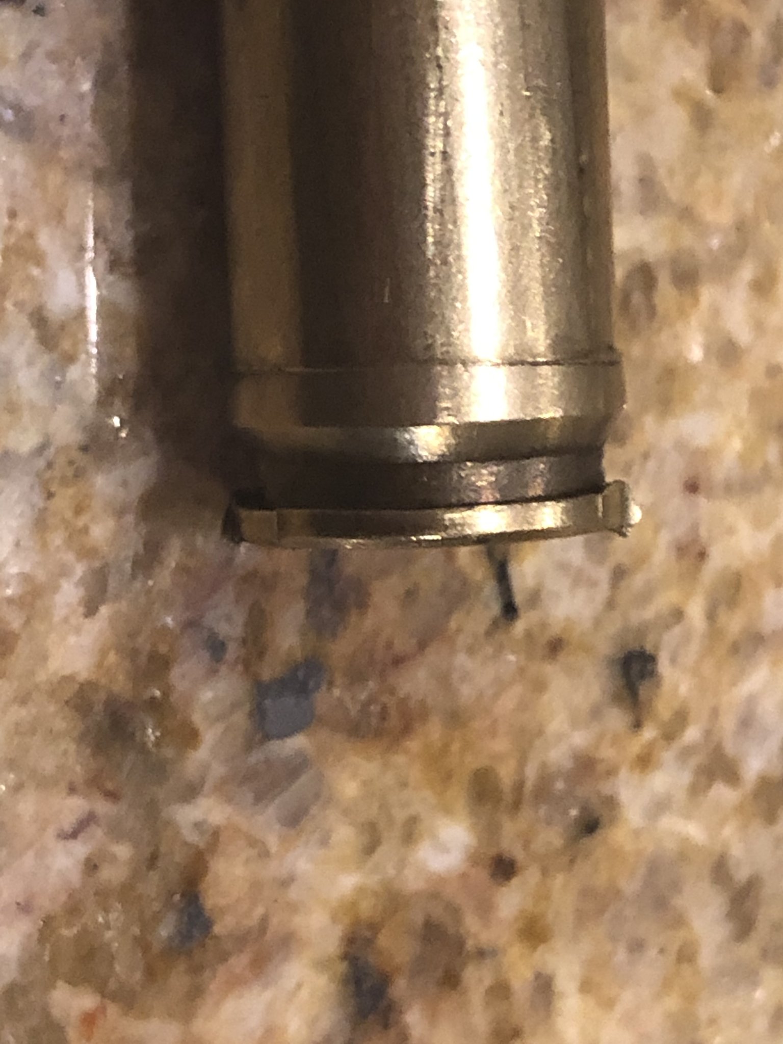

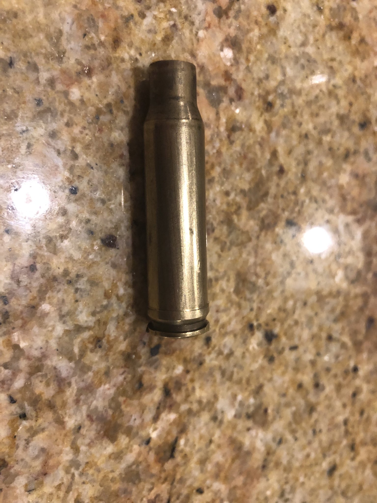

At the range this morning working on the new 1100 yard steel and had problem. I have been shooting the same handload for 400 rounds. There is some primer cratering, no ejector marks. Ran 57 rounds today in total. Last two rounds I ran in rapid succession and the bolt was stuck closed, casein the chamber. Was easy to remove, but looks like it wend off slightly out of battery. It didn’t go shoot until I pulled the trigger, not a slam fire. Thoughts?

An AR firing pin cannot reach the primer if the gun is out of battery.
Where the brass is expanded is as far as it goes into the chamber, drop a sized piece of brass in the chamber and look.

Could be powder related, but I don’t know how. Every charge is done on an auto trickler, and checked for fill height. I have seen the trickler over run bu 0.06 grains, but not more. Might be neck tension, these are 1x fired to be annealed next run. If I put my body weight on the I get 0.002” change in length. Chamber is dry, bore looks good. Preceding round impacted on steel at 1100 so I doubt the charge was off or the bullet came apart. No evidence of necks splitting.

Is that a 308 case? Damn. If so, that's some serious pressure. I'd guess a heavier bullet made it into the box too. Or accidental overcharge by a few grains.
Glad you made it through that one unscathed!
That looks like the new 308 belted magnum.
Weird, it just seems almost impossible to have enough pressure to expand the head yet the primer did not blow out.
Is it possible the reloading die did that when you resized the case and you missed it.
No matter what the pressure is if that that round burned its powder while still in the chamber you would not get case expansion like that. Especially since that low on the case the expansion is happening in the web. The reason I say if if was in the chamber went the round reached max pressure the chamber would not have allowed expansion with that sharp of a step in it especially in the web.
Maybe the firing pin on AR's won't allow an out of battery ignition, I am not qualified to argue that point, but I will sk is this true with all flavors of the 308-sized rifles since there are so many different proprietary designs.
I don't see this due to case head separation as it is too far down on the brass and it does not cause the case to expand in diameter, and is more often a result of pushing the shoulder back ttoo far when resizing than pressure.
The over pressure caused the brass to expand past it's elastic limit to the unsupported head of the case, it was jammed tight enough to not allow the bolt locking lugs to disengage when the gas from the gas tube tried to start extraction.

Pull out your BCG and play with it a little and you will see it is not possible for an AR firing pin to protrude enough to hit the primer unless the bolt is fully turned and in battery....and yes, this pertains to all flavors of rifle caliber AR's with rotating bolts, big and small. Of course, pistol calibers are different, and also the CMMG Guard.
While it's out, drop a round in the chamber and see how much case head sticks out unsupported, it's exactly where his head is expanded in the pic above. I've seen dozens of these, usually with a hole blown out the side of the case head. He was lucky, if it was a few PSI hotter, he may have had a mess, i.e. blown out magwell, ruined magazine, possibly ruined bolt and barrel extension....maybe injuries.
