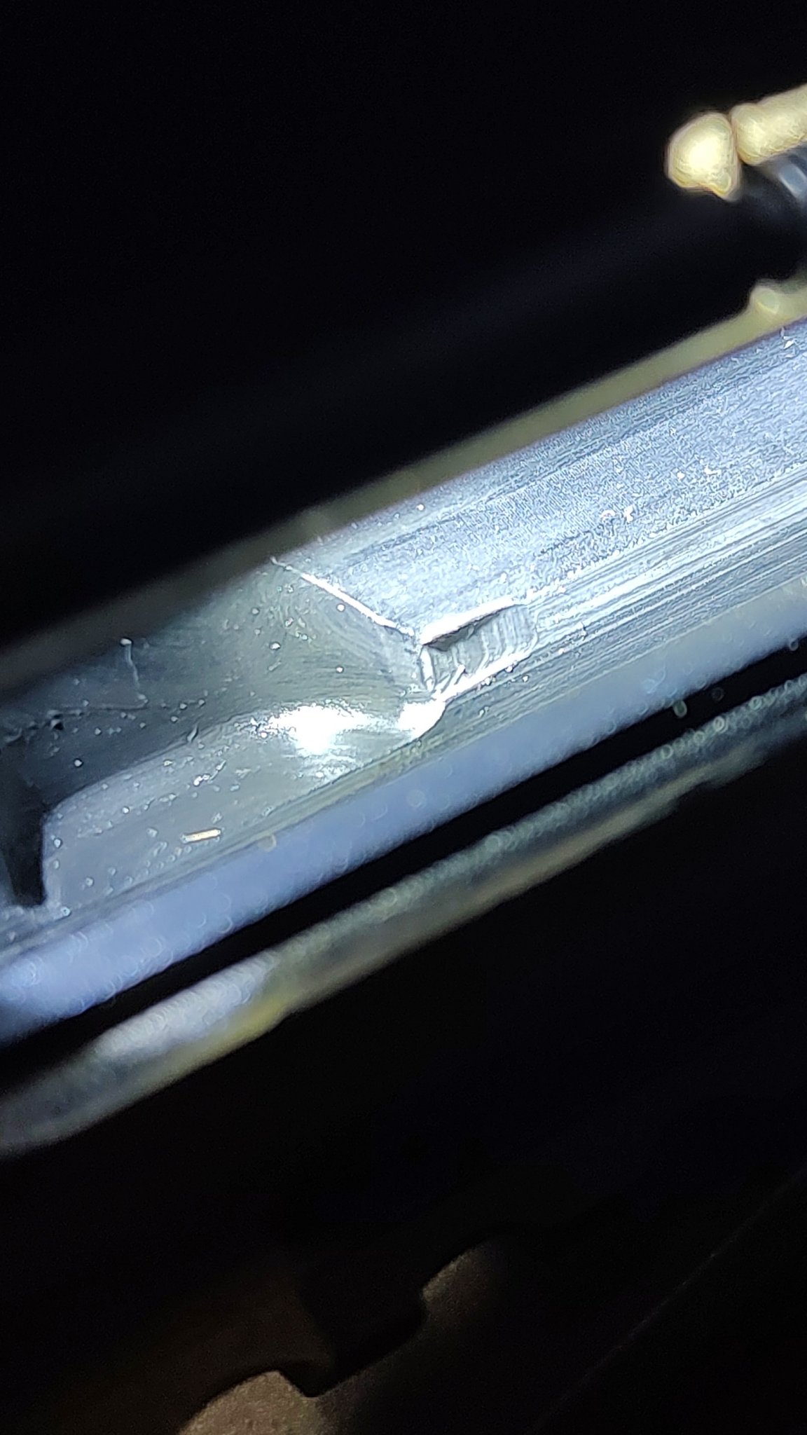

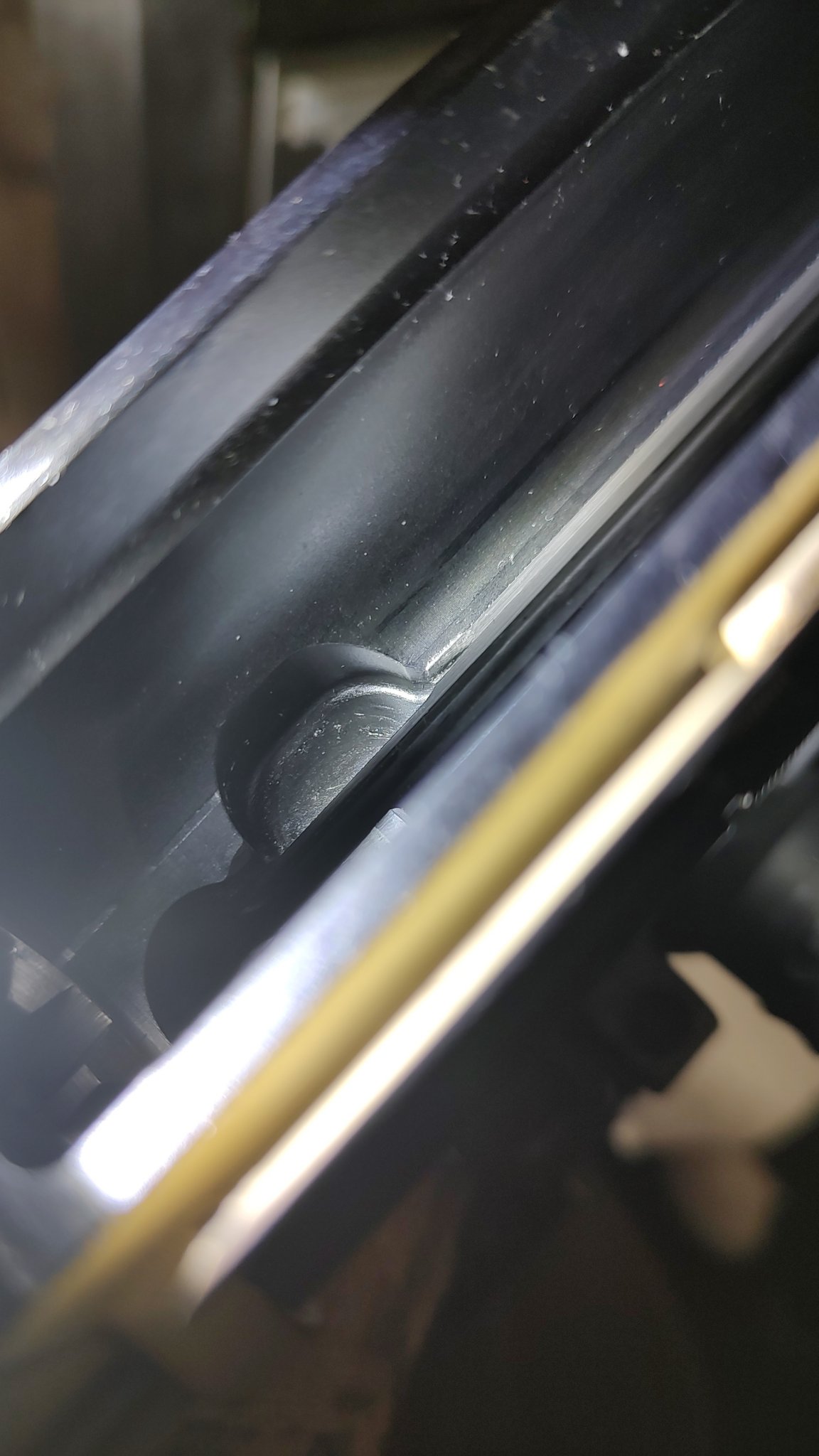

Is this normal wear for a AR10 platform? If it is ok I'm not complaining just wanting to make sure it's normal. Gun shoots fine and I've never had a malfunction.

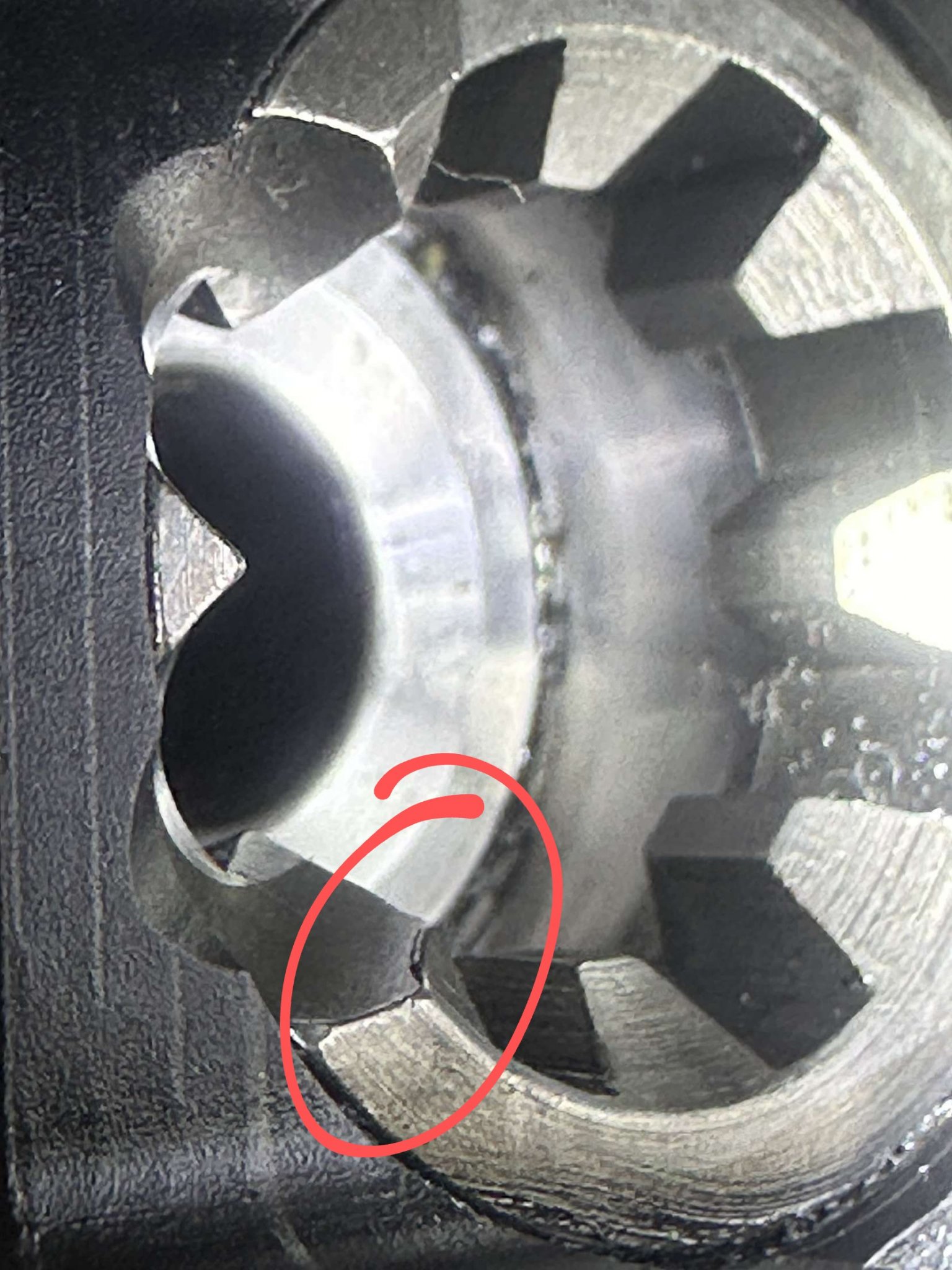

Barrel extension, flow on the feed ramp

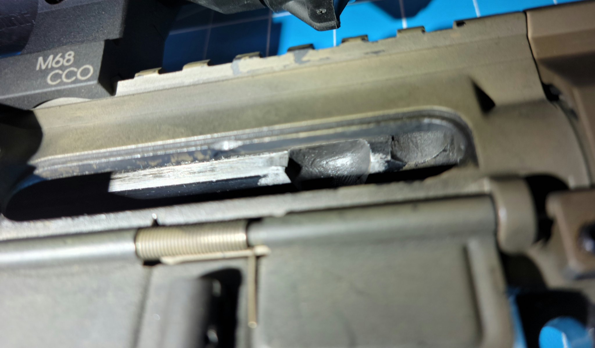

Upper receiver

can speak to the extension and bolt lugs but the cam pin drag is something i see but not in everything. some uppers are worse that others. some dont have any.
can’t recall if thats normal or a sign of excessive carrier speed. so tagged for interest and answers here.

Man if I remember right the cam pin looks fine but I could be wrong. I found all this cleaning it and I disassembled the bolt and nothing stuck out but I'll double check.
I'd be looking at the barrel/barrel extension (BE) not being properly timed/clocked in the upper. Shooters perspective, the barrel/BE could be counter-clockwise from being correct. If the bolt lugs are disengaging from the BE lugs before the cam has completed its travel in carrier cam path, the cam pin is not inline like it should be and gouges the cam pin cut-out of the upper until it does line up. The wear on that side of the rear of the bolt lugs would indicate that the bolt is over-rotating in relation to the BE and engaging the adjacent BE lug. and not the BE lug that the bolt lug would normally lock into. Hard to tell for sure, but that BE looks cracked.
I'll pull the barrel nut tonight and check time and see if there is enough slop in the upper for the barrel to be clocked one way or other. I don't remember it being sloppy but it's been almost a year since I assembled the upper.

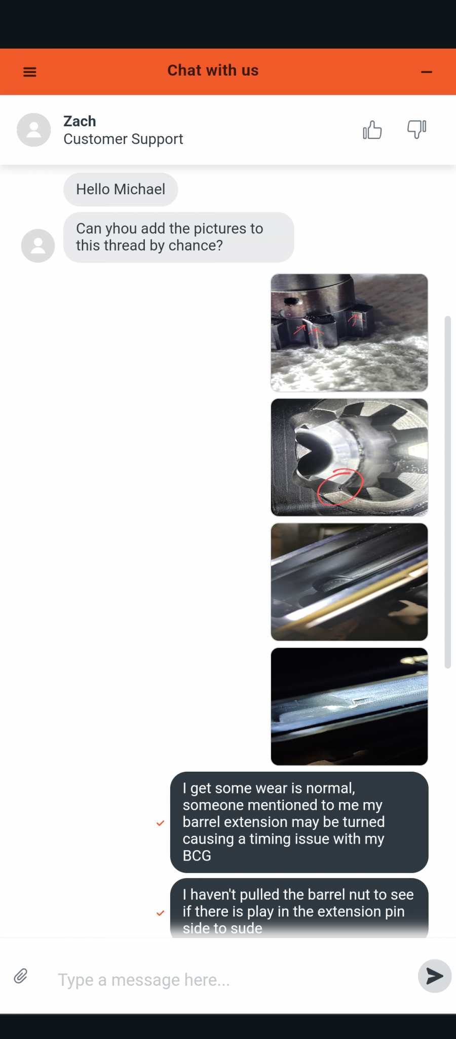

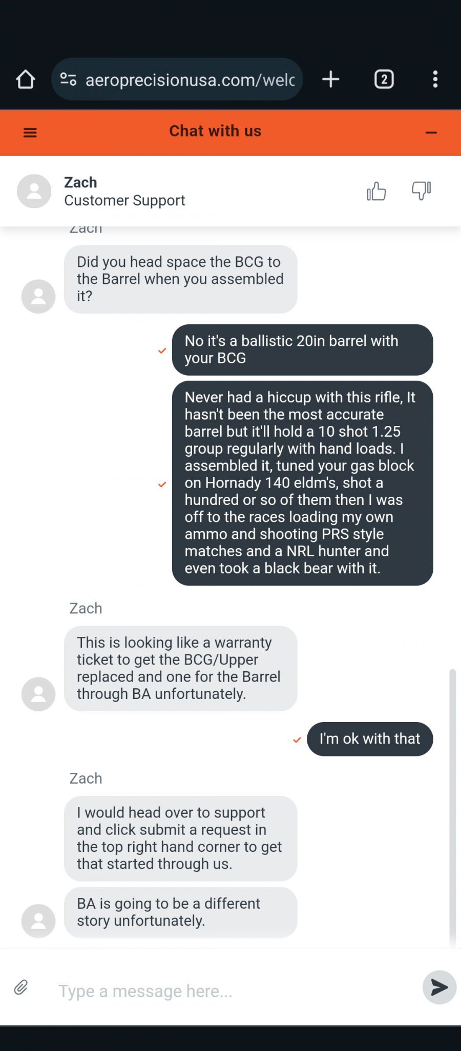

Aero FINALLY got back to me. I talked to a guy on their chat system and sent him pics. He told me to submit a warranty for the upper and BCG and get a hold of BA about the barrel.
good, get all new as they probably think it best to just replace and keep good cs. good for them and good for you!!!!!

Upper receiver wear mark looks normal ... your bolt lugs ... I'd keep an eye on ...
Aero owns BA (IIRC) so not sure why they have a different process ...
Yea they own them. I've talked to BA about warranty before they where easy to deal with. So we'll see how this timeline plays out.
