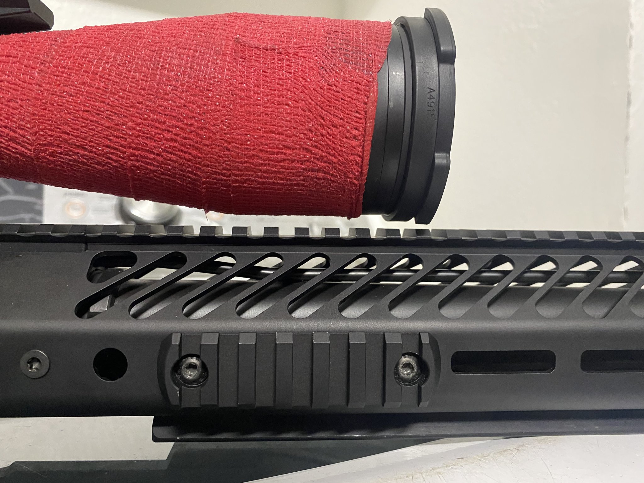

I’m running a 6602 With a 527 with caps on my sp10. Here’s a picture.
Reactions: LakuNoc
