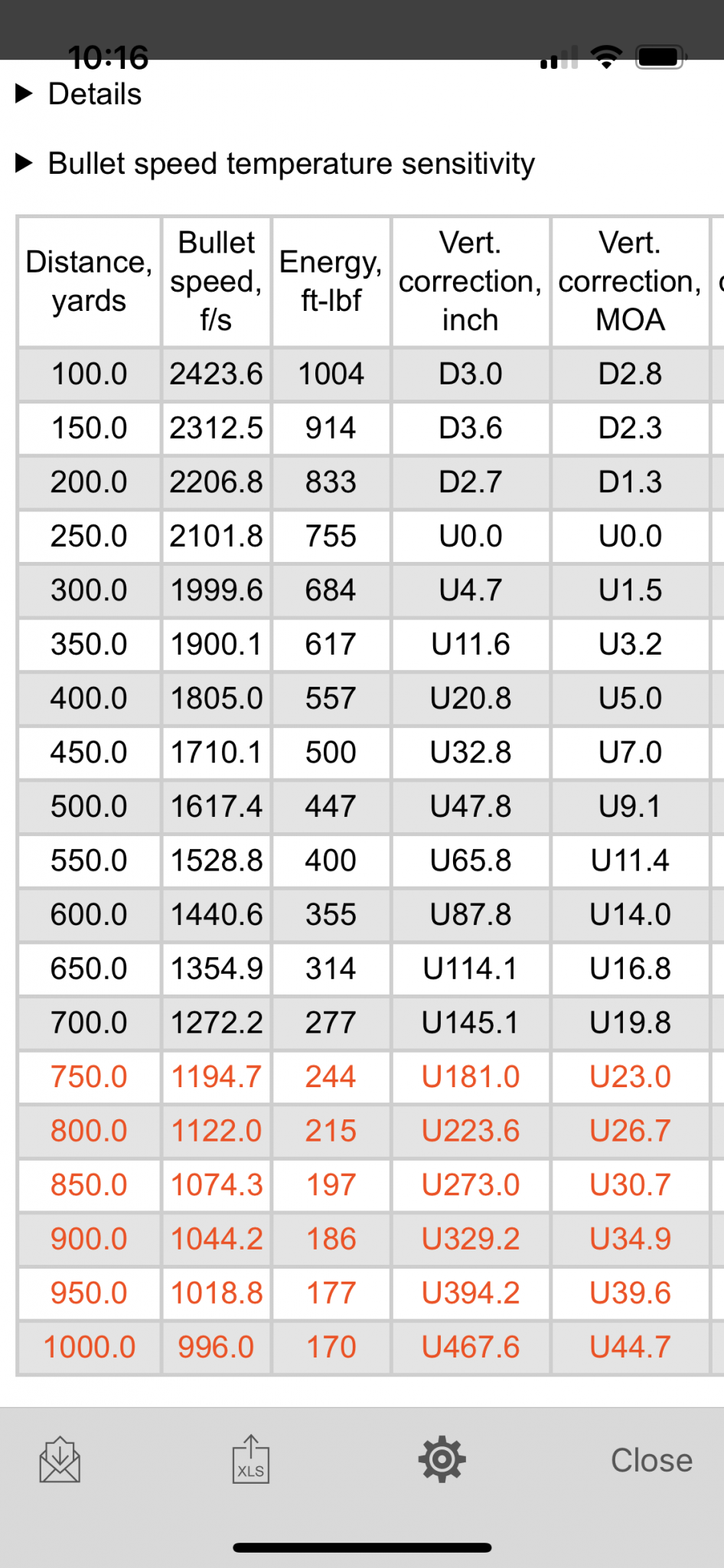

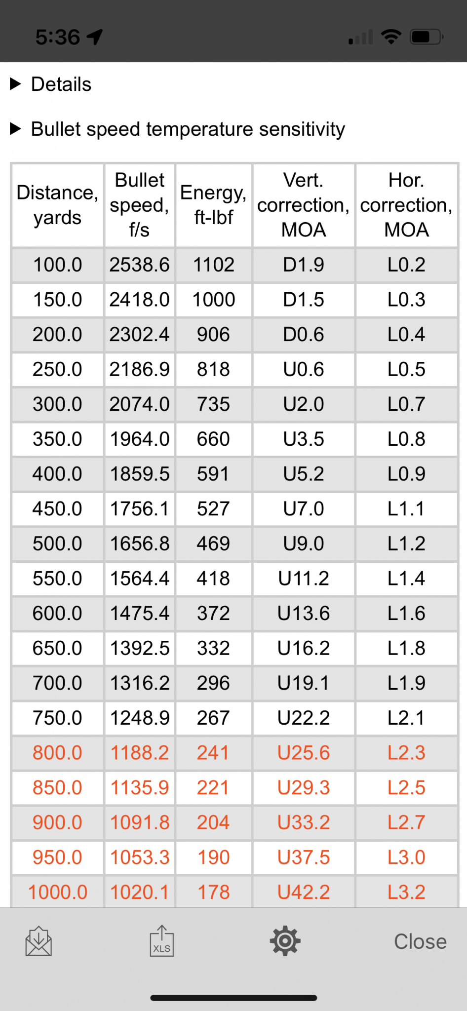

Rifle is shooting 77gr SMK’s at 2783 fps muzzle, I am at sea level. My ballistic app says between 750-800 yards it was going transonic and I guess it didn’t lie. I shot earlier at 790 yards and noticed my 1/2-3/4 moa rifle was struggling to consistently hit a 1.5 moa plate. I kinda thought the 77 SMK would handle the transition better but maybe not. Any other experience especially at sea level? will the 77 gr TMK handle it any better? i noticed it would only gain me about 75 yards at the same velocity.

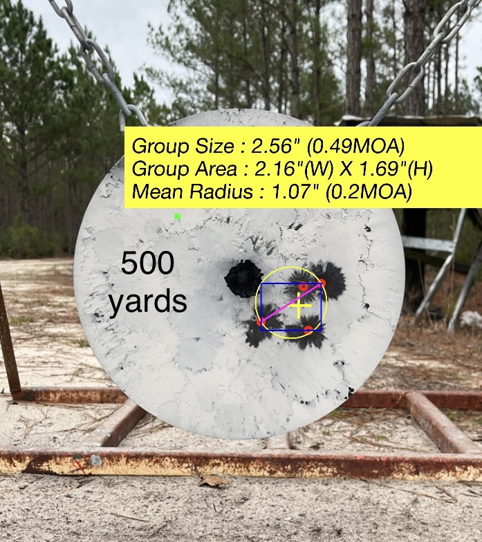

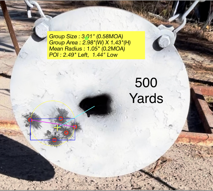

This rifle is holding 1/2-3/4 MOA consistently at 500 yards not 100 yds. I just got the chance today to push it farther since I’ve been extending the range and had next to no wind to test it.

No problem at all man. No I just know it says it’s going transonic at that distance and I haven’t pushed It past 600 yds until today since it was really good conditions to test it out. It was highly inconsistent compared to its usual performance so was curious if maybe this was a reason.
