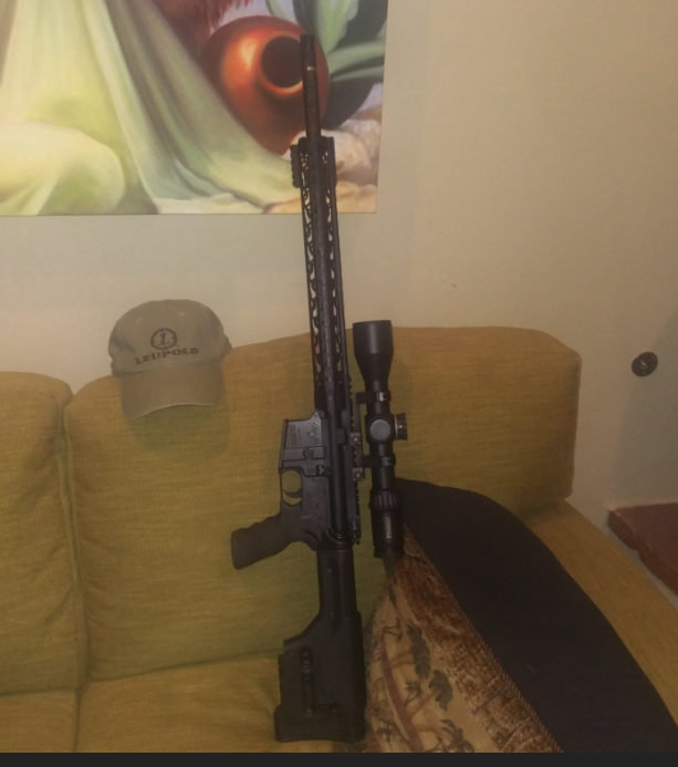

Been struggling with this upgrade in the area of accuracy. I've successfully met my goals of lightening up the platform my virtue of the barrel and an ultra light Odin Works rail. I suspect this may have produced some untended consequences. I have added an SA adjustable gas block as part of this build but even with that, the recoil impulse seems harsh and the gun moves around to the point of staying on target is almost impossible without the weight of my left hand on the rail for stabilization. Seems to only like the heavier 123 to 129 gr bullets. Perhaps a better match for the 1-8 wist?
I've got a 7.62 Surefire muzzle brake I'll be installing that I found laying around. Certainly not the best but it will help. Just on old 308 bird cage on it now. I'm also wondering if a new buffer & buffer spring setup is in order?
Thoughts?
Picture of rifle:
In addition to the Surefire break, I'll be installing a CTS AKTIVE Recoil Buffer with anti-tilt and new spring. Got to wait at least three weeks for the buffer. Guess they are in demand. Decided not to go with the Armspec or JP SCS noise reduction is not my objective but rather reducing muzzle climb and creating a smoother recoil impulse. Hopefully this comb will work. Worse case, I'm looking at my first suppressor.
That is a bummer. Try the brake, that should help some but might not be the whole formula needed. Are you sure the gas is adjusted right, i.e. tuned to just lock back on empty 5-10 times in a row and maybe a hair more gas for adverse conditions? What buffer weight and spring?
I do suggest trying one thing at a time, so you know what helps and what doesn't. Just shotgunning parts leads to a lot of confusion about what really works.
How much does your rifle weigh? It doesn't look like a super light rifle with that PRS stock; I guarantee it's heavier than my SBR 6.5 Grendel but that one is the flattest recoiling rifle I own. Balance might be part of the problem, IMO heavier in the front recoils better, yours looks like the weight is more to the rear.
Just for comparison, this little gun is also 6.5 Grendel, and is fairly easy to double tap 8" steel with at 100 yards, and easy to spot hits at the same or farther, just because it tracks flat. It uses a standard carbine spring and buffer, adjustable gas, and a medium-light 12.5" barrel with a lightweight Rogers SuperStoc at the other end, and a single port brake that I made. Forgive the nasty camo job please, I need to redo it.

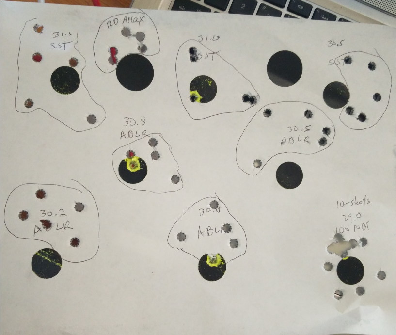

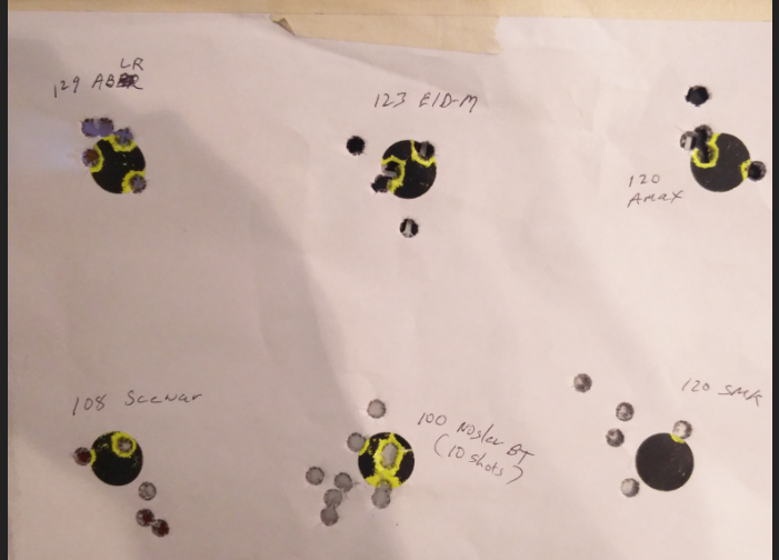

Had a chance to get to the range today with the new Surefire break installed. Shot 7 different bullets. The results of six shown here:
Five shot groups at 100 yards. The Nosler NBT is a 10-shot group. The Nosler ABLR clearly shot best both times I've tried them. I think the NBT 100 has potential. I'm sticking with hunting bullets so my testing going forward will include the 129 ABLR, 123 SST & the 100 NBT.
The break helped but I think I still have to find the right harmonic load for this barrel. Thought these Proof CF barrels are supposed to be super stiff but maybe not. I'm hoping to have a CTS Active Buffer and new recoil spring installed for the next outing but either way I'll be doing reduced load ladder testing.
Well going from bad to worse. I'm thinking about using "down grade" instead of "upgrade"in the thread title. I reduced loads for the 129 ABLR, 123 SST and 100 NBT. Everything got worse except for the 100 NBT. A longer seating depth seemed to help with the 100 NBT in addition to a .5 gr drop in powder charge.
The only bullets that seem to hold promise are the 129 ABLR and the 100 NBT. This makes no sense as the sweat spot for the Grendel should be 120-123 grain bullets. This barrel just hates them! I went to the range yet again this morning but too crowded with yahoo hunters getting ready for dear & elk season.
My last testing effort includes only two load: 129 ABLR at a max load of 31.0 grains and a re-test of the 100 NBT with 29.0 & 28.5 grains of IMR 8208. I did load up 10 rounds each of the Hornady 123 SST and ELDM with 28.2 grains of 8208 just to rule out CFE 223 as a possible culprit. No Grendel IMHO should be this picky. If this hold true and I find no other technical reasons for the tuning problems, certainly would NOT recommend this CF barrel.
