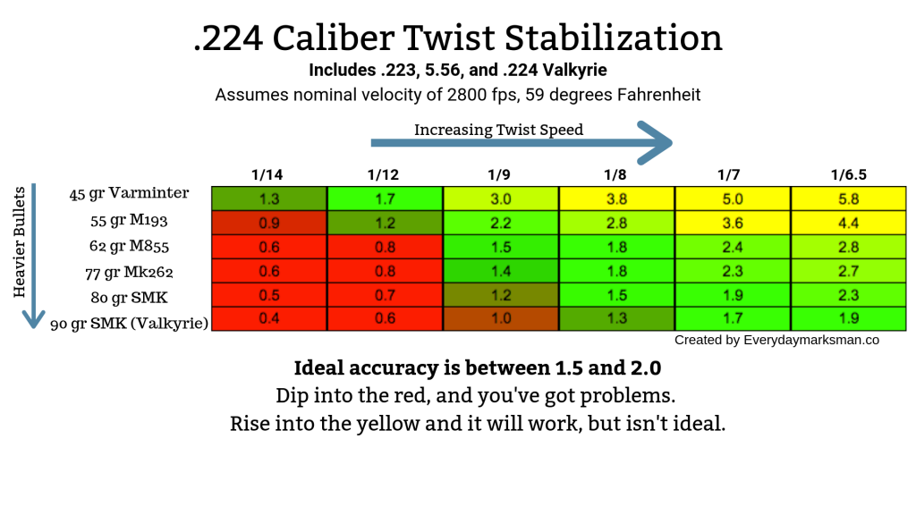

sorry, barrel twist 1:8, ammo IMI match 77 grainers open tip and Norma match
Im just not familiar w/ ARs and not sure I want to sink a bunch of money without doing some research
I would bet your barrel would like 62gr SMK
