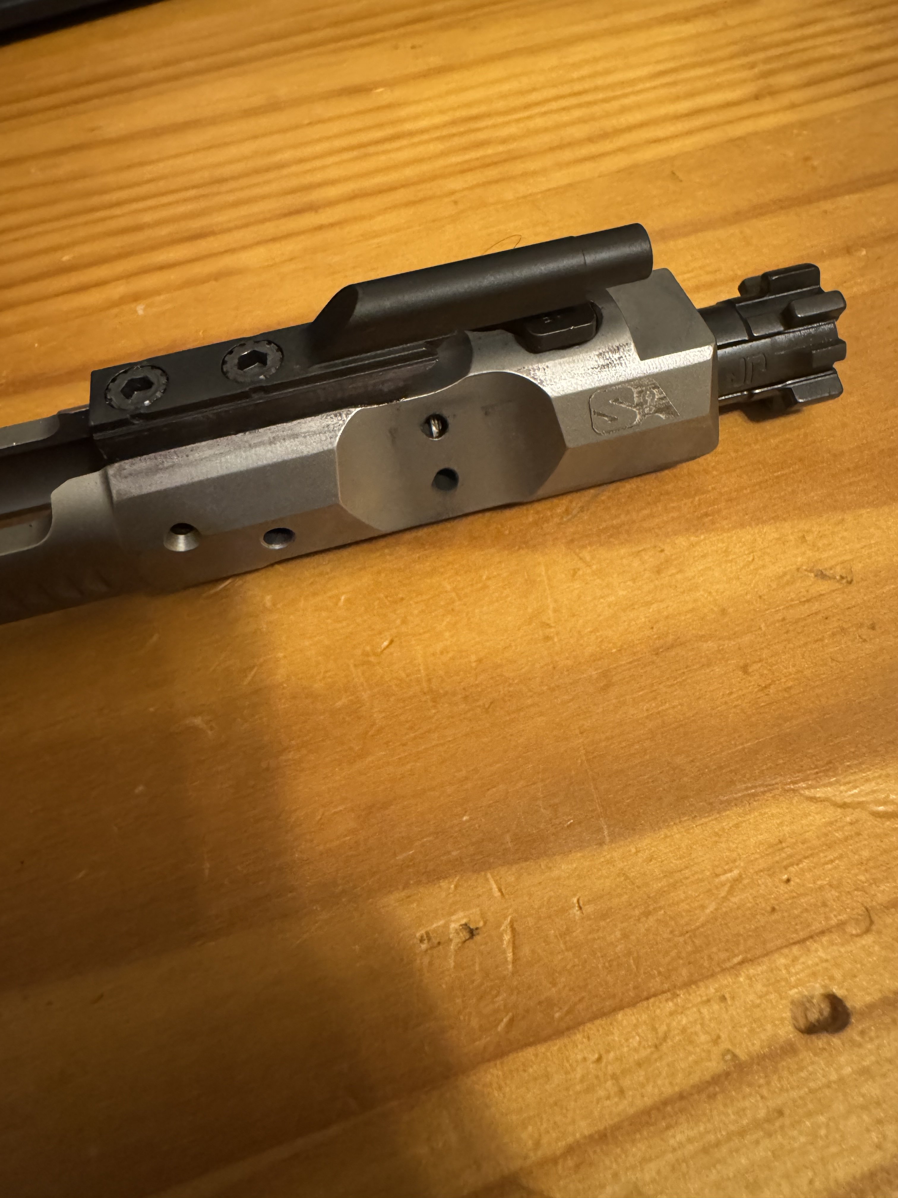

Putting together a new upper build, took it out for the first time today and it won’t pick up the next round or lock back.

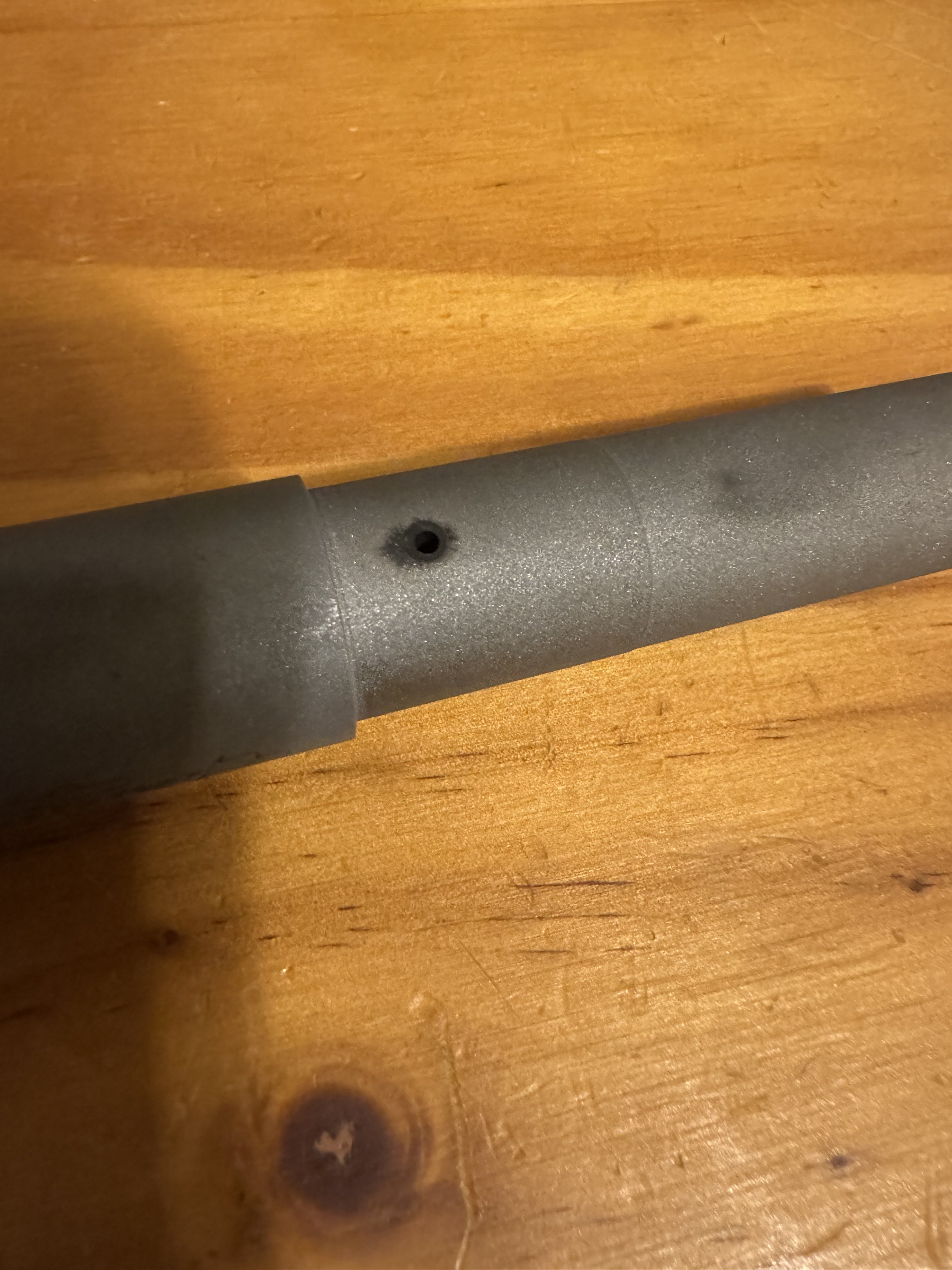

It’s a 11.5” Craddock carbine plus 1 gas system. Superlative arms adj gas block with set screws. Superlative arms bolt carrier and JP bolt. Gas port appears to be around .080” +/- just eyeballing with calipers. Don’t have gauge pins….I triple checked to make sure it was in the all open position. Still building out the lower but put it on an existing lower with a Geissele super 42 carbine spring and H2 buffer. Carbine tube.

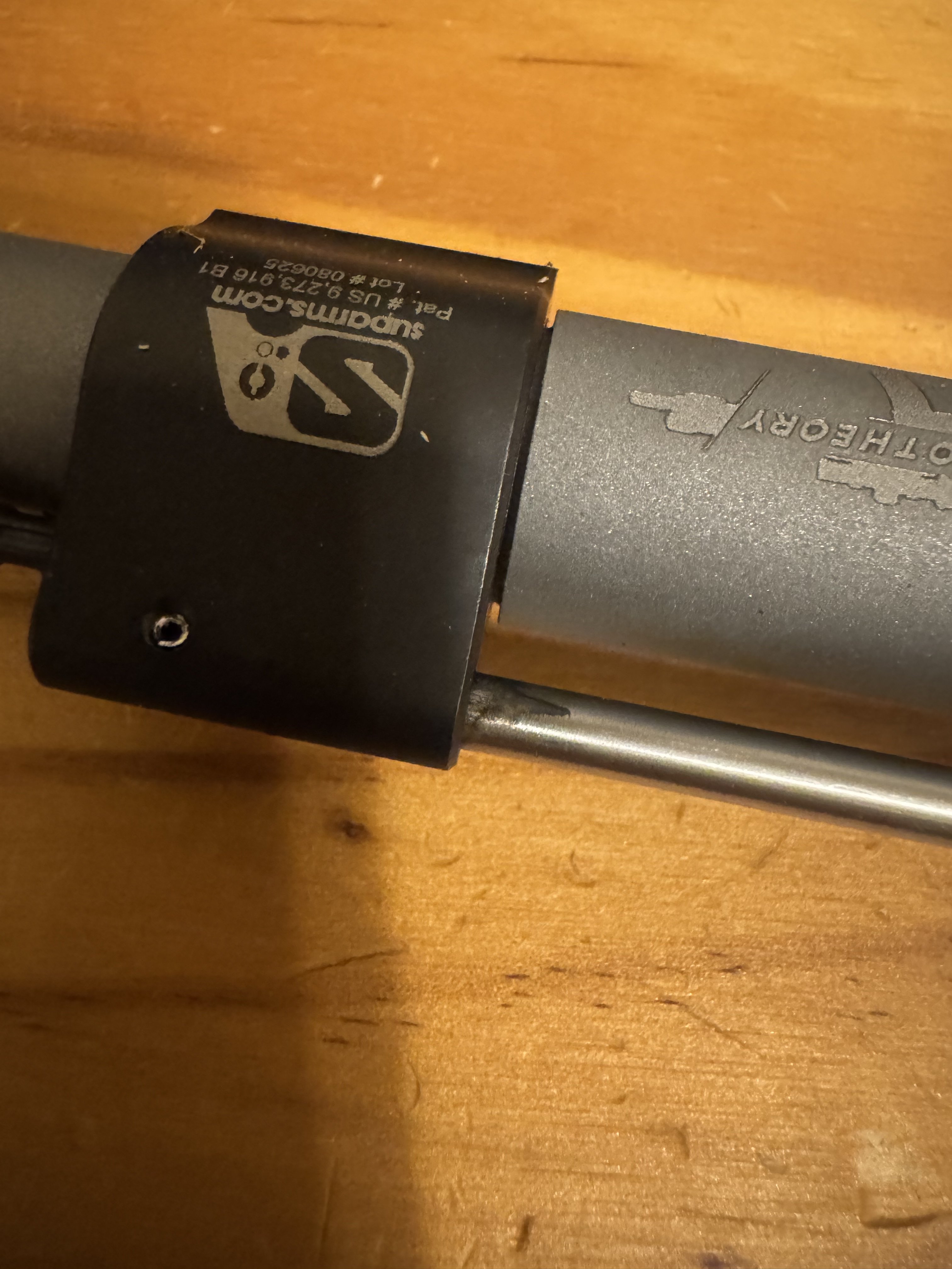

I thought it was gas block misalignment but it appears to be fine. I noticed some carbon on the gas tube right at the block. Not sure if that normal. Now wondering if it’s something with the buffer system???

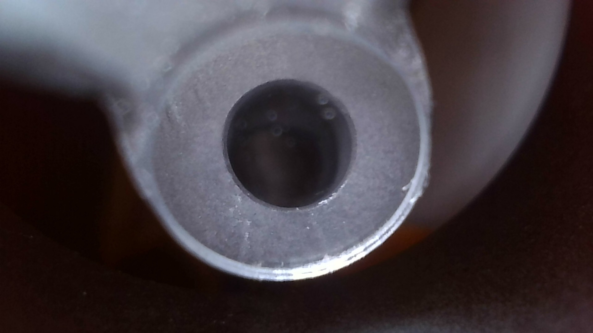

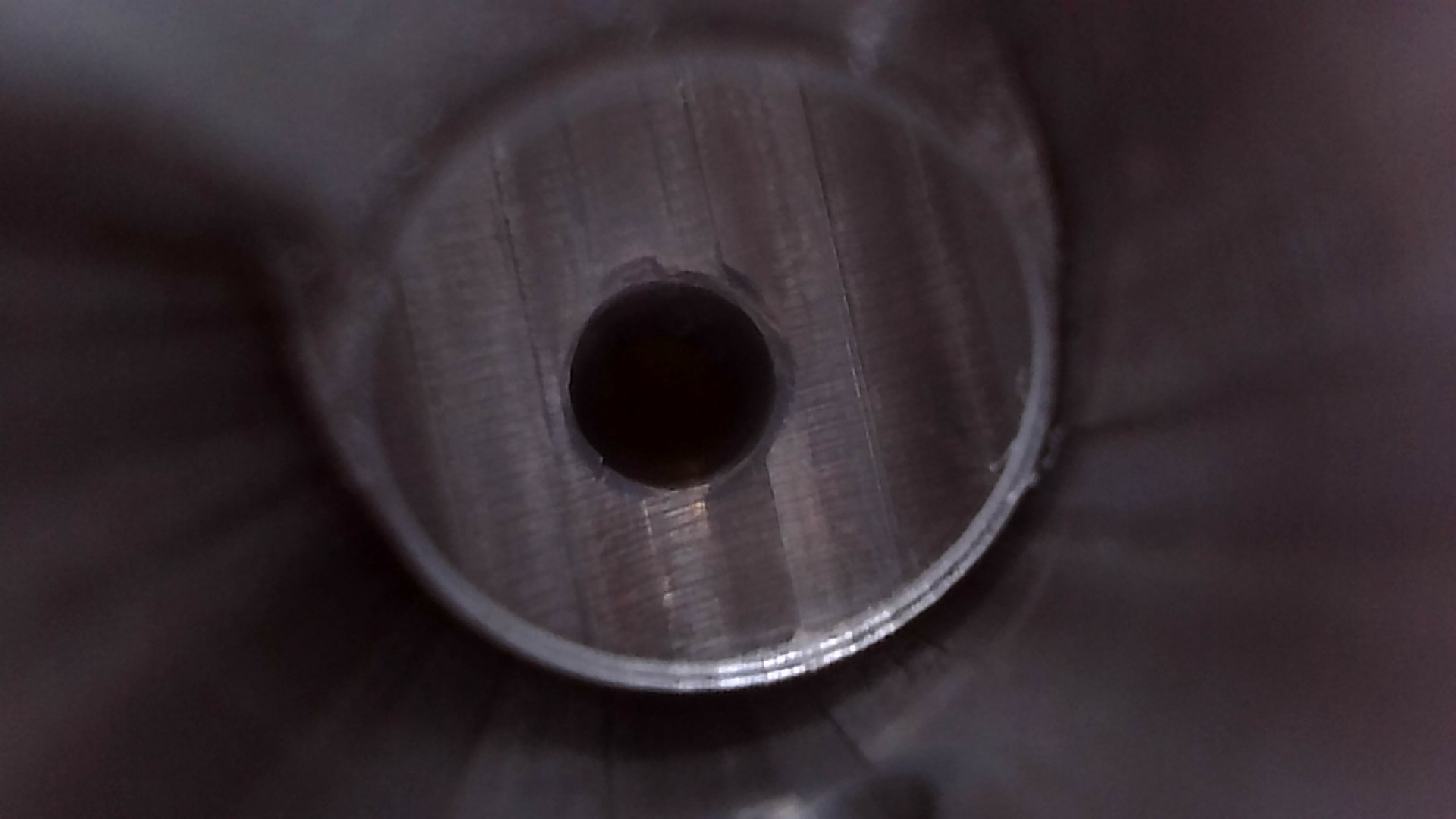

Any ideas? I do have another lower with a geissele spring and h1 buffer to try. As well as another BCG. The one strange pic is the gas block looking into the adjustment area. Couldn’t get it clear. I also put some fishing line down the tube. Didn’t feel any obstructions.

First guess before seeing your pics was gas port alignment, but that looks good.

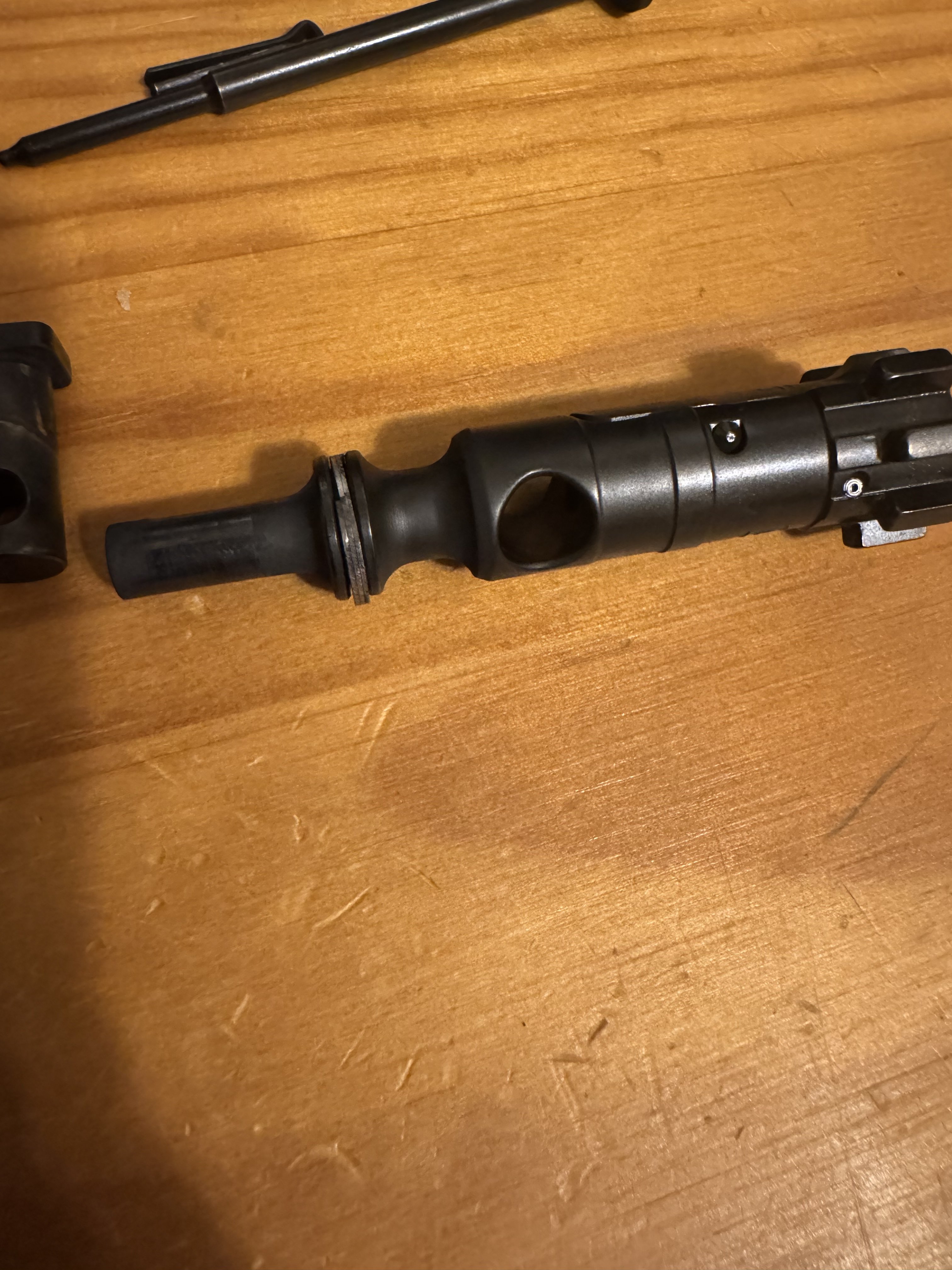

Next guess is your JP bolt has the garbage one piece gas ring.
After that if the bolt/carrier/key/gas block are all sealed well enough without some serious leakage I would say it's just undergassed and you need more port diameter.

2nd edit: bolt pic definitely looks like a 1 piece. Maybe not THE problem, but a huge problem nevertheless that needs fixing before any other diagnosis is worth doing.

What’s the issue with the JP 1 piece rings?
They don't work at all and have caused short stroking in every rifle I've tried them in, every time.
Thought I was doing something wrong, consulted with a bunch of my shooting peeps and some JP team shooters (my match shooting stomping grounds extend into MN, JP fanboi territory..) and it turns out they all threw theirs away too.

Swap the bolt, I have not had an issue with the JP bolts, but it it is an easy check. Turn the gas block adjustment screw and de if ANY thing changes.
Edit: swap to a fixed gas block and try it. That will tell you if the SA block is working.
