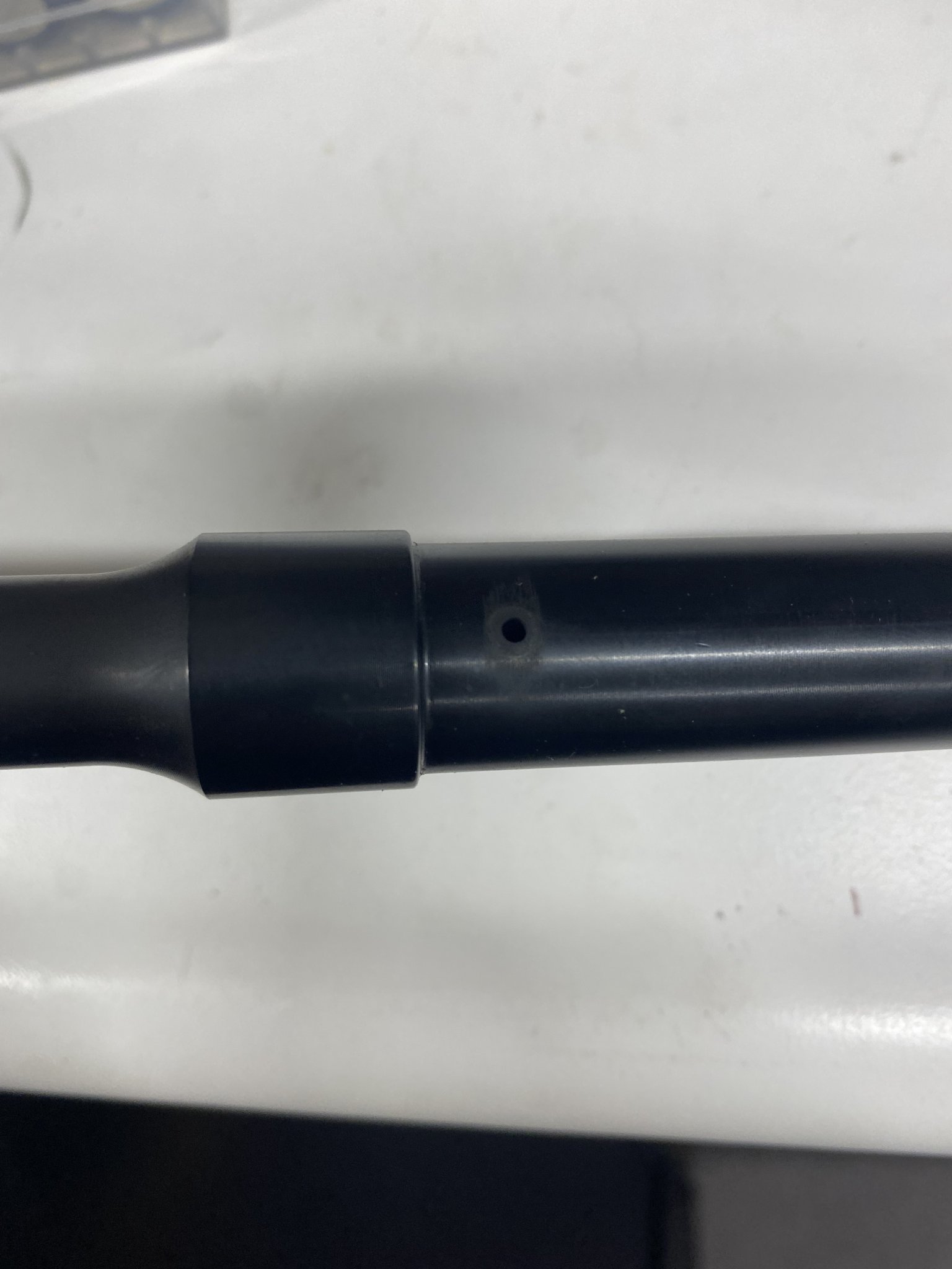

Are you positive the gas block is aligned with the gas port ? ( Since it sure sounds like a gas restriction issue )
Some barrels need the gas block to be against the barrels shoulder flange... some leave room for the handguard cap... IE in between the barrel flange / shoulder and the front sight base. That slim space, is enough to cause gas flow issues if the gas block is not positioned correctly over the gas port.

By all accounts, the gas block is lined up with the gas port. I used a gas block genie to verify such. I just got in a borescope, maybe with that, i'll be able to double check that they are aligned.

5:00 ejection is pretty "weak"... hence the GB alignment question.
Maybe check for any gas leakage... at the gas block, the gas tube, and the BCG gas key.

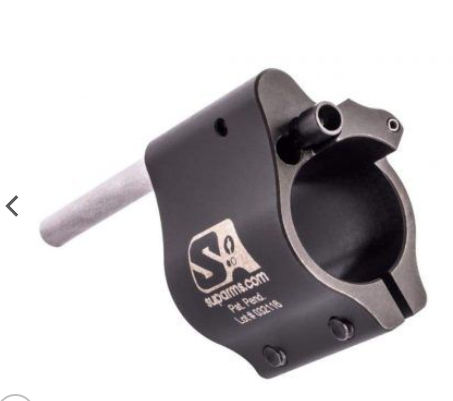

What gas block? If you're running a Superlative Arms gas block and you adjust it to what you think is wide open, you may actually be in bleed off mode. Does your gas block look like pic below? If so, close it all the way, then count 18 clicks.
^^^^^and they require some offset to the shoulder. Make sure you haven’t accidentally mounted it flush with your GB shoulder

Check the gas port, I have had 2 separate barrels from different manufacturers with the wrong gas port, I used a set of drill bits to check diameter. Super easy to re drill just go slow, use a good oil and a new bit, or send it back and have the manufacturer fix it.

I borescoped it and the gas block and port line up perfectly.

Faxon barrels tend to have oversized gas ports at 0.081". If the barrel gas port size is correct, check the gas flow from the BCG. Stick a copper wire through gas key and check to see if it protrudes inside the BCG (with bolt removed). Assuming there is a gas port hole machined for the gas key, what could've happened during assembly is they went a little too generous with the gas key sealant and you have hardened sealant blocking the BCG gas port. If you find you can't push a wire through, remove the gas key and inspect (or contact the manufacturer for an RMA).
While the bolt is out, insert the bolt into the barrel extension and see if you can spin it freely without binding.

The wide open regular gas block gave me an ejection pattern of 3-4 o’clock and got rid of short stroking. Maybe I’m wrong, but I should be able to achieve a 1 o’clock ejection with everything wide open.
I did swap bcg’s and nothing changed. Gas key was open and not clogged. To the best of my ability, the gas port is measuring .079 so it appears ok.
The gas tube is clear of obstructions. Is it possible it is undersized? May try a new gas tube next.
3-4 o'clock ejection is perfectly fine if you're in the northern Indiana region with the temps it has been the past couple of weeks (excluding those oddball 40*F days). Your ejection pattern will start shifting forwards as the carbon starts sealing any gaps around your gas block.
URG-I gas port size for midlength should be 0.076" (or was it a 0.070", it was one of them, in any case smaller than 0.079" or 0.081") running with H2 buffers. The gas port size was selected to be reliable for operational temperatures -60*F to 160*F

For future reference the Ballistic Advantage barrel gas port spec for the midlength should be 0.0785" which is inline with your measurement.

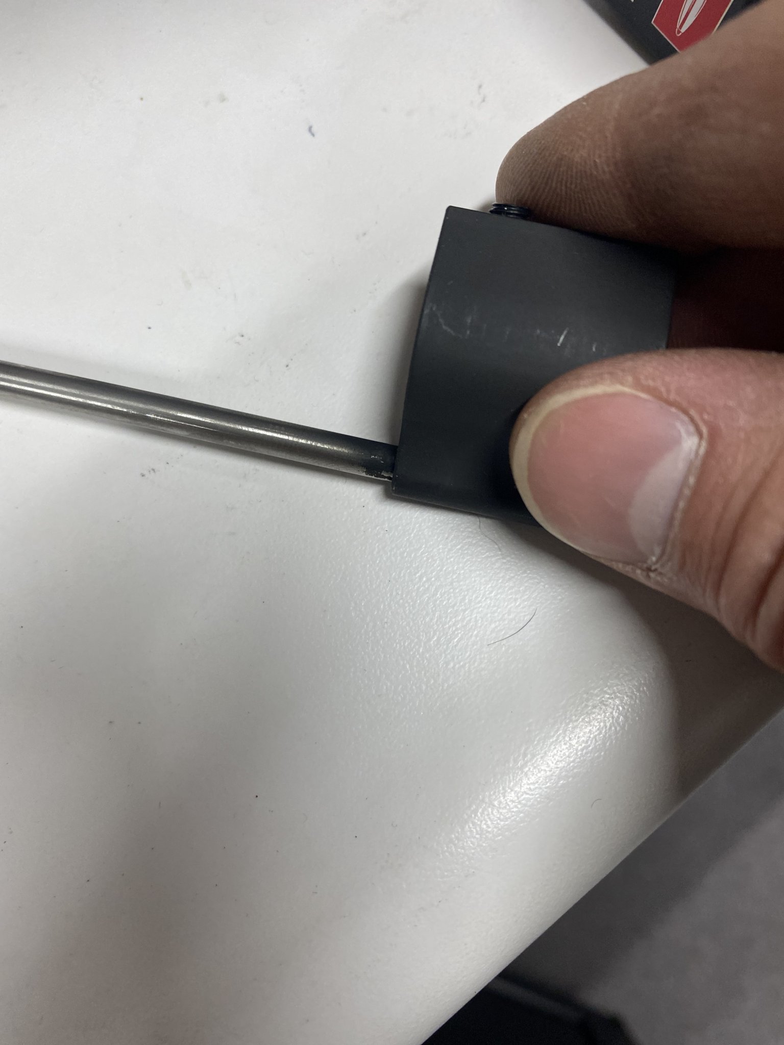

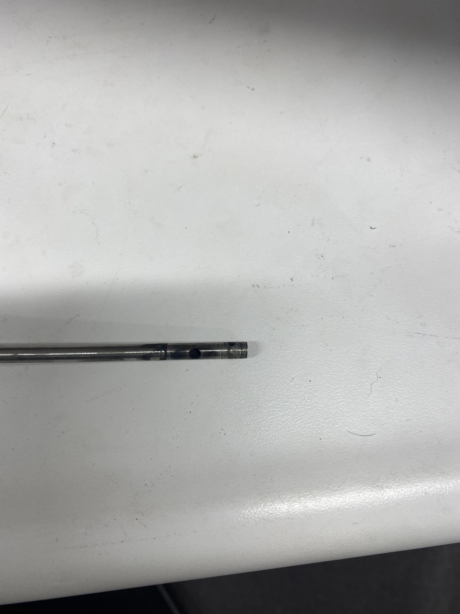

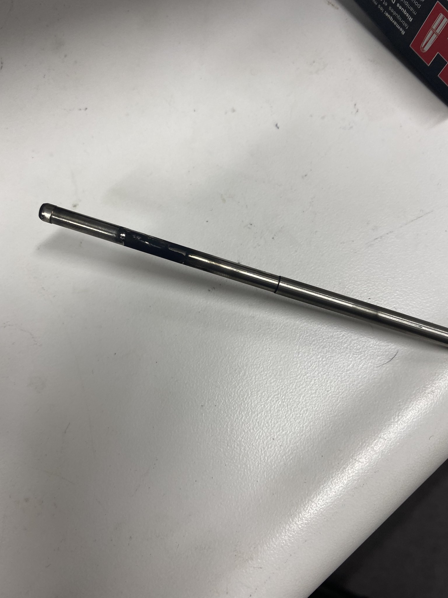

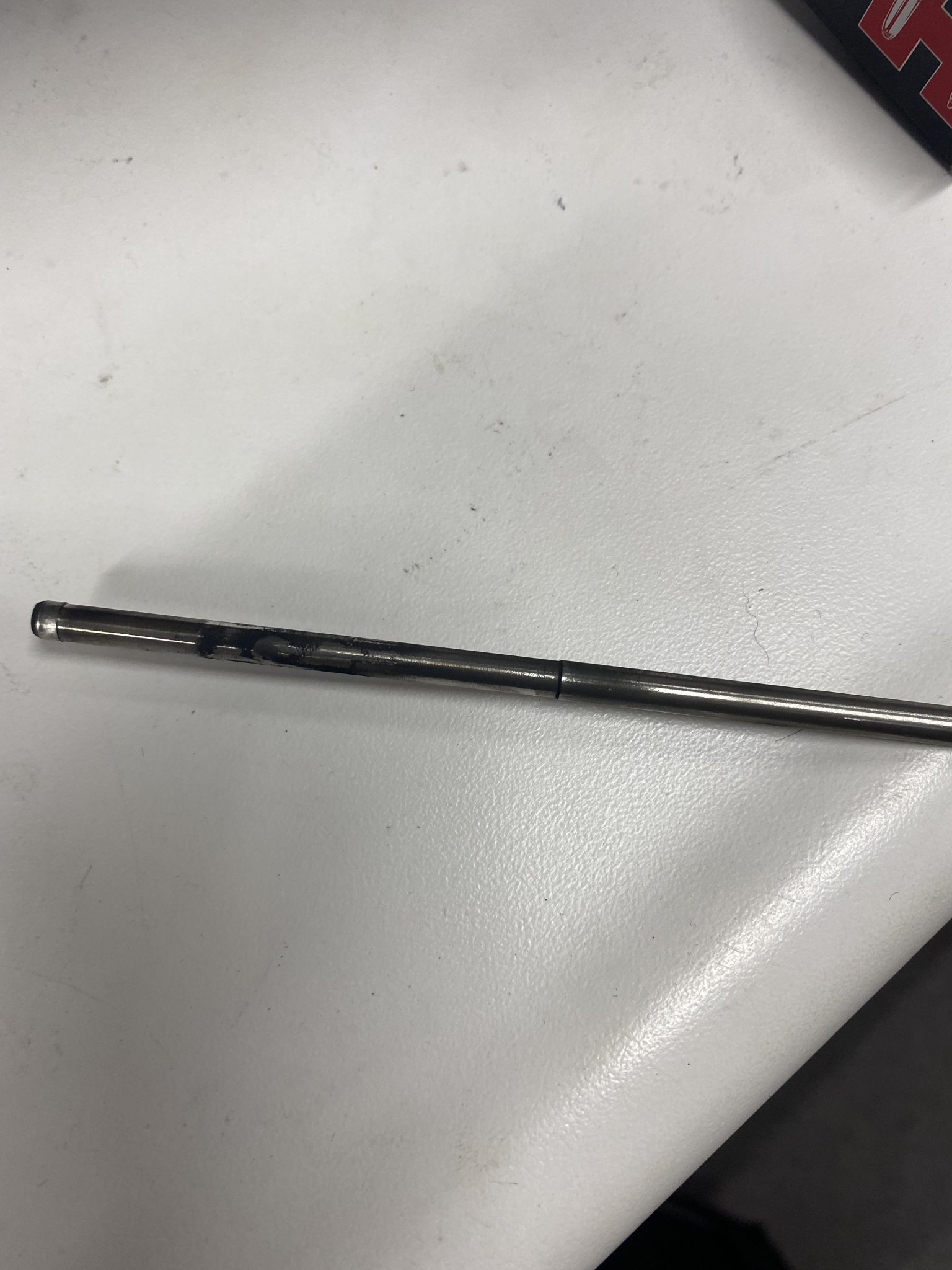

Attached are photos of the original gas tube. Can someone with more knowledge than me comment if locations of carbon staining looks normal? It was a pain to remove the OG gas tube from the gas block. It seemed to be locked into it pretty good due to carbon buildup.

  6. Measured the gas port at .079

All the images of the carbon on the gas block and gas tube look normal to me. The only things left I can think that of would also affect a known working BCG are:
- Misaligned barrel extension or burr, undersized barrel extension recess, nonconcentric barrel extension, that is causing excessive friction on the bolt lugs. Undersized barrel extension or receiver/extension pin offcenter). You'll see excessive wear indicators on the bolt lugs if this was the case. (for the Ballistic Advantage barrel, the most likely cause would be undersized barrel extension recess caused by too thick of a layer of Nickel Boron, but if the bolt spins freely in the extension without rubbing, this wouldn't be it)
- Misaligned receiver extension/receiver buffer tower or improperly machined receivers (upper or lower) causing a canted alignment. You'll see wear indicators on the tail of the bolt carrier, the lip of the receiver extension, and/or lower receiver.
- Improperly machined upper receiver cam pin recess causing the cam pin corners to drag excessively. You'll see excessive wear on the upper receiver and cam pin corners.

It's been mentioned that your gas port diameter is 0.0785" (#47), which is what BA drills at and should be fine. However, if I was having your issues, I would consider upping it to 0.810" (#46, 7/32").
If it's not any of those, I'm stumped.
You and me both. At this point, I am probably going to just reach out to Aero and see if they can verify the receivers are in spec if I sent them in. Same with BA and the barrel.
If all else fails, I will probably up it and see what happens.

I am guessing it is the gas tube, as it almost runs but not quite. I got it to lock back with max gas but then would have feeding issues. Only a couple times with hotter handloads would it cycle correctly, then feeding issues again. Will report back. I'm new to AR's.
I think I also need to try the gas ring test.

Further disassembly looks to be gas block just a tad off center(but still in line with the port on the barrel), and a dirty gas tube. we will see if that fixes it. I will probably clean the bolt in the meantime.

Got the barrel back from BA. They couldn’t determine any issues with it. They did drill the gas port out though so maybe it was undersized, although they didn’t state such.
I’ll get it mounted up and tested in the next few weeks.
