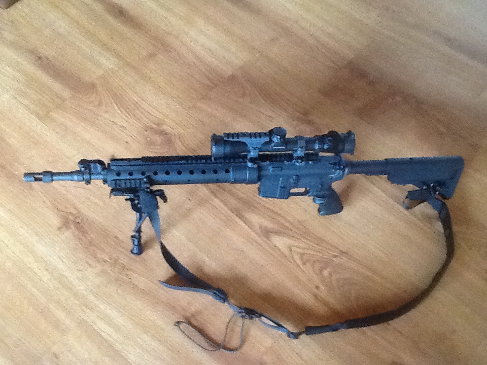

I might hit the Range tomorrow if I do ill post some target pics..thinking of doing the elf Test.
^^ That's a sweet setup, but it's not what the OP is asking for. He is looking for a nra service rifle or match rifle upper, like below.
The top is one of my service rifles, the bottom is one of my "space gun" match rifles. Neither of these uppers cost over $1000, and there is nothing better. Different sure, but not better. The national champions and record holders all use setups similar if not almost identical to these.

I run a MK 12 Mod 0 with a Douglas 18" and long rifle length gas tube really nice set up!
