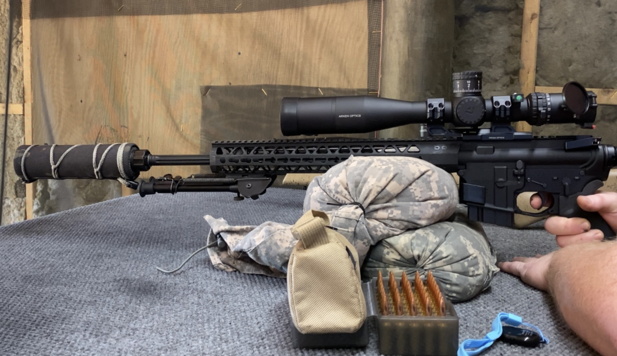

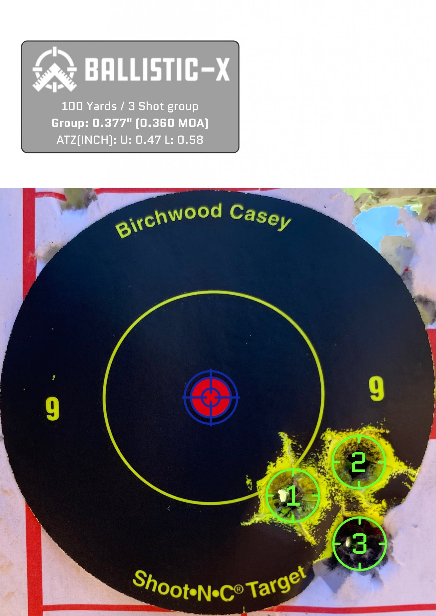

I used a VLTOR upper paired with a 20" Proof carbon barrel. It shoots a tad over half MOA with factory 108 ELDM. I have zero complaints so far. 9.9 mils to 1000.

And the first barrel is a Compass Lake Douglas 20 incher, tactical contour. It gives nice ragged .7 ten shot groups with 77 gr. Sierras and 24 grs. Varget. Looking for second barrel after Christmas.

I used a Seekins upper with the integrated hand guard nut. it was much more solid than the upper I had used before. I used a proof barrel, but if I was going to do it again, I would go with Craddock precision. I use and H2, full mass carrier, and adjustable gas block.
