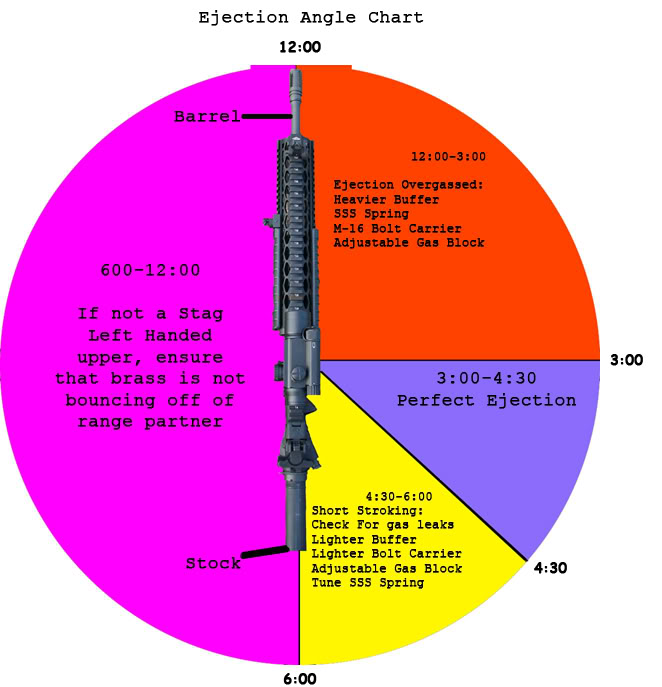

    The brass flies out completely perpendicular to the rifle. Interestingly my southwest ammo goes maybe 4 ft, while fgmm goes in the same exact direction but literally 20ft away.
    Is this a sign of very overgassed?
    Normally if the brass ejects forward of your position is a sign of over gas not the distance.
    I can only speculate why there would be such a great difference between the distance the brasses tomorrow between the two loads.
    Experiment with your gas block adjustment if possible. Turn the gas down quarter to half-turn and try the Southwest ammo to see if the distance is reduced or increased.
    You can experiment with an adjustable gas block and answer that question yourself. And know this, it can be problematic to "tune" and adjustable gas block to work perfectly for different loads in the same weapon.

    I have found that "the chart" showing ejection patterns is useful to a certain extent, but IF YOUR WEAPON IS RELIABLE WITH NO OTHER SYMPTOMS other than ejecting brass in the "wrong direction" it's best to leave it alone. Use the chart sparingly, IMO it has caused many AR owners to perform much unnecessary work on their weapons. JMO and YMMV
