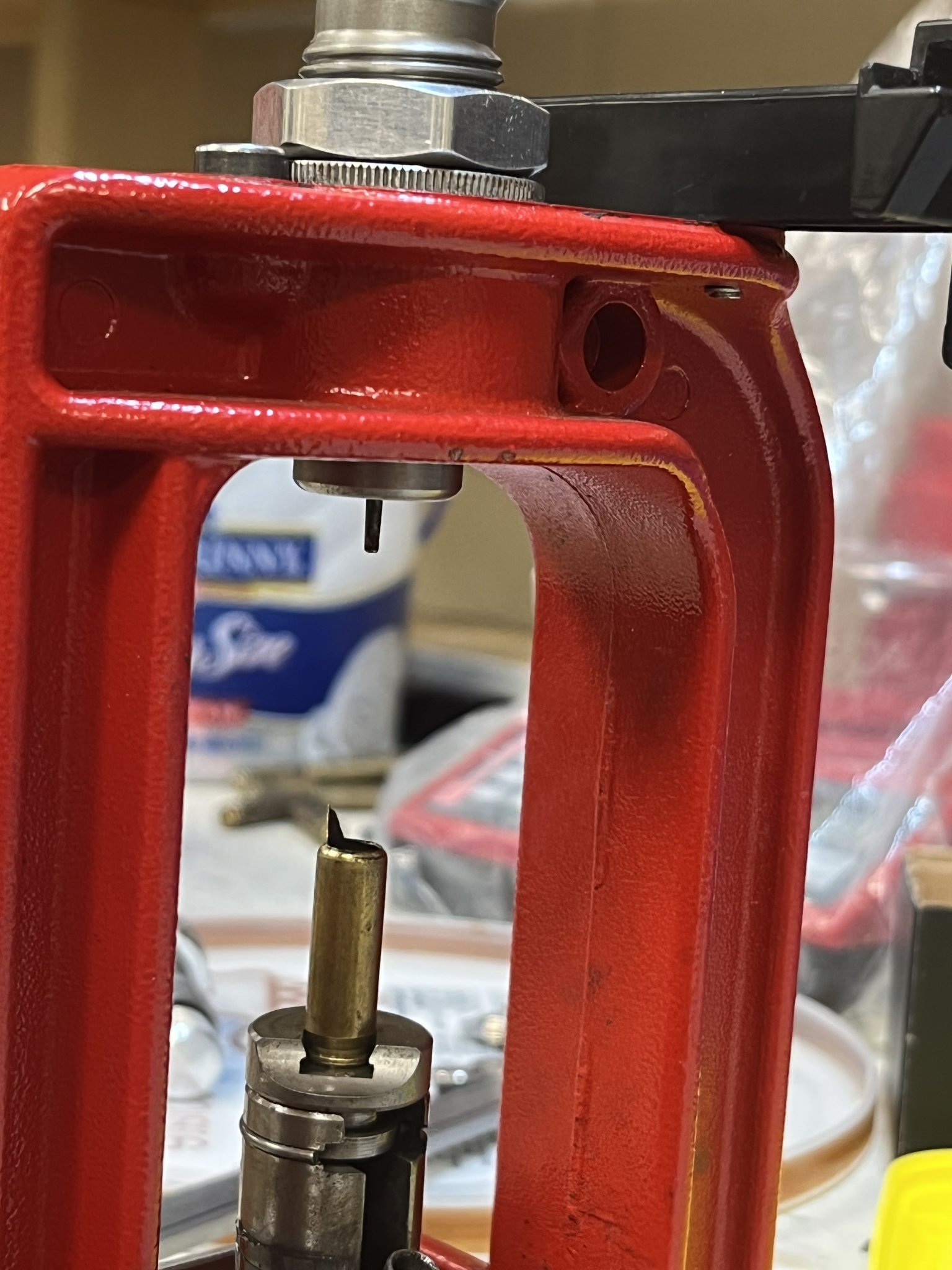

I have reloaded thousands of rounds ao far. The delayed blowback guns do some rough handling of the brass. You will lose some cases in the process. Mostly they will look like this one below. Take your time and enjoy.

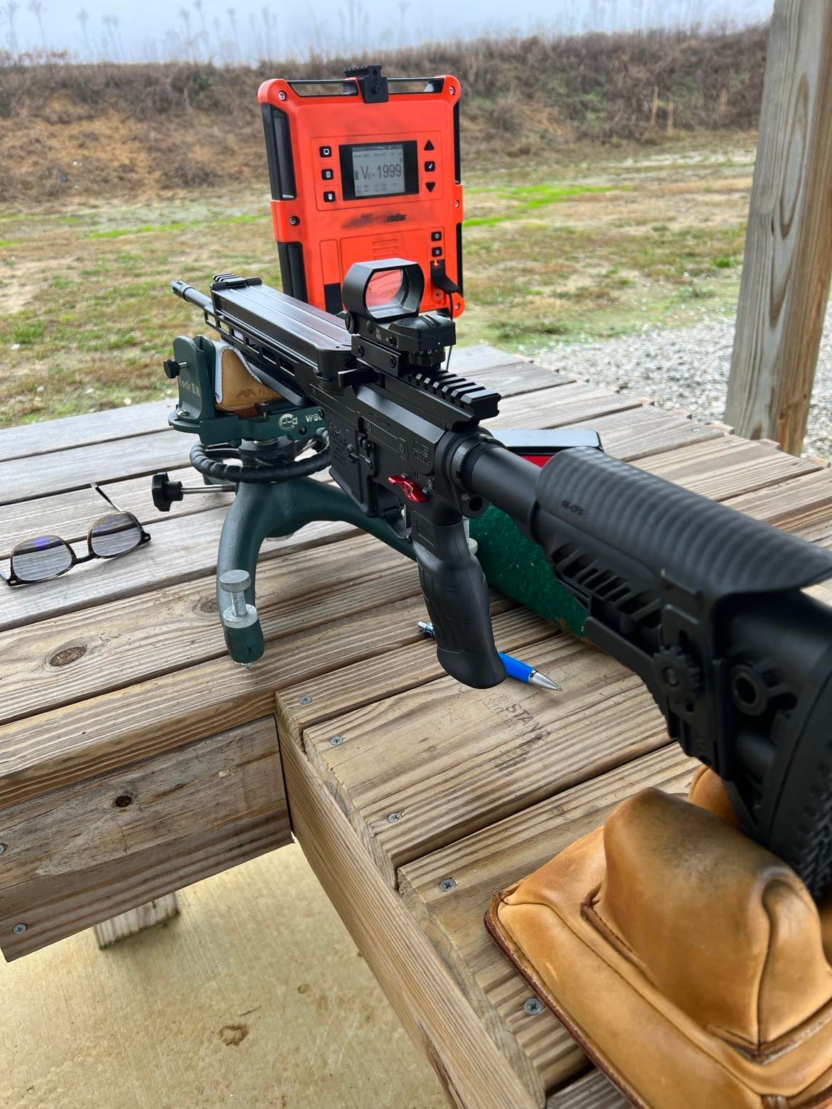

And enjoy shooting it. I’ve stretched it out to 400 yards. It gets real wishy at that distance and wind plays hell on it. I’m getting a hair over 2200 fps with 4.8 grains of powder.

I have reloaded thousands of rounds ao far. The delayed blowback guns do some rough handling of the brass. You will lose some cases in the process. Mostly they will look like this one below. Take your time and enjoy. View attachment 8136929
Wow! Maybe you could trim it up and make a new Wildcat cartridge out of that? How about the 32-Rooster?
