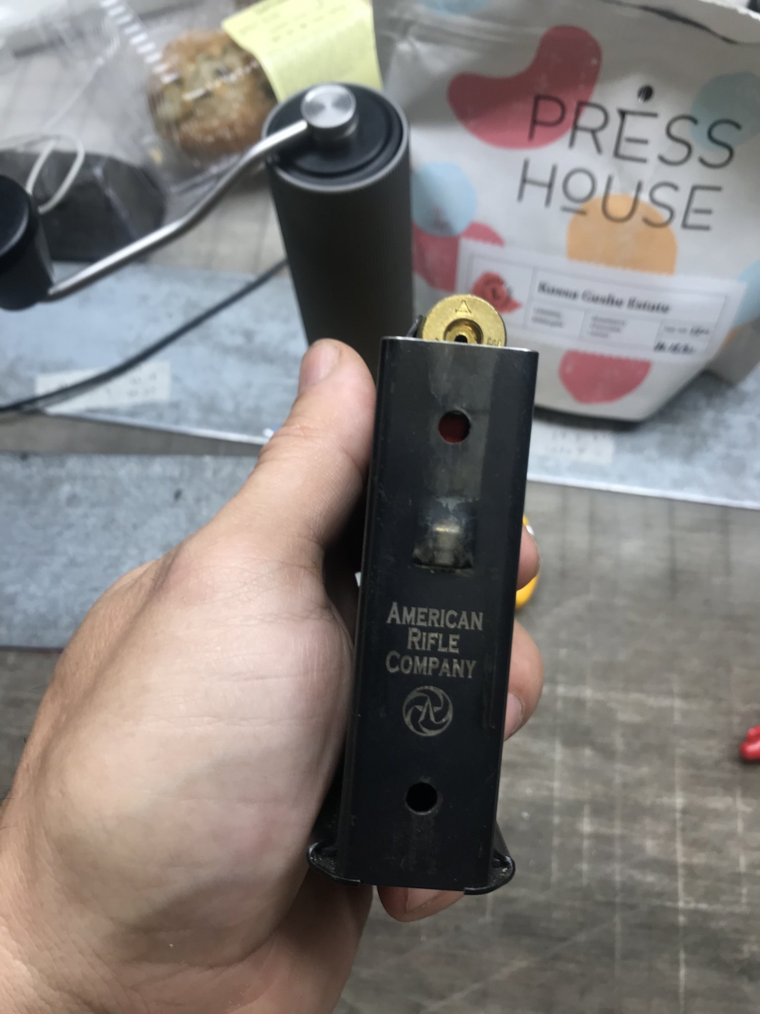

Open up feed lips a bit so case presents a bit higher.
for reference. with mag loaded and looking from the rear, can you see all the primer and nothing more or do you see all primer and a little bit of the case base as well.. I show about 98% primer right now (for SRPS that is )
