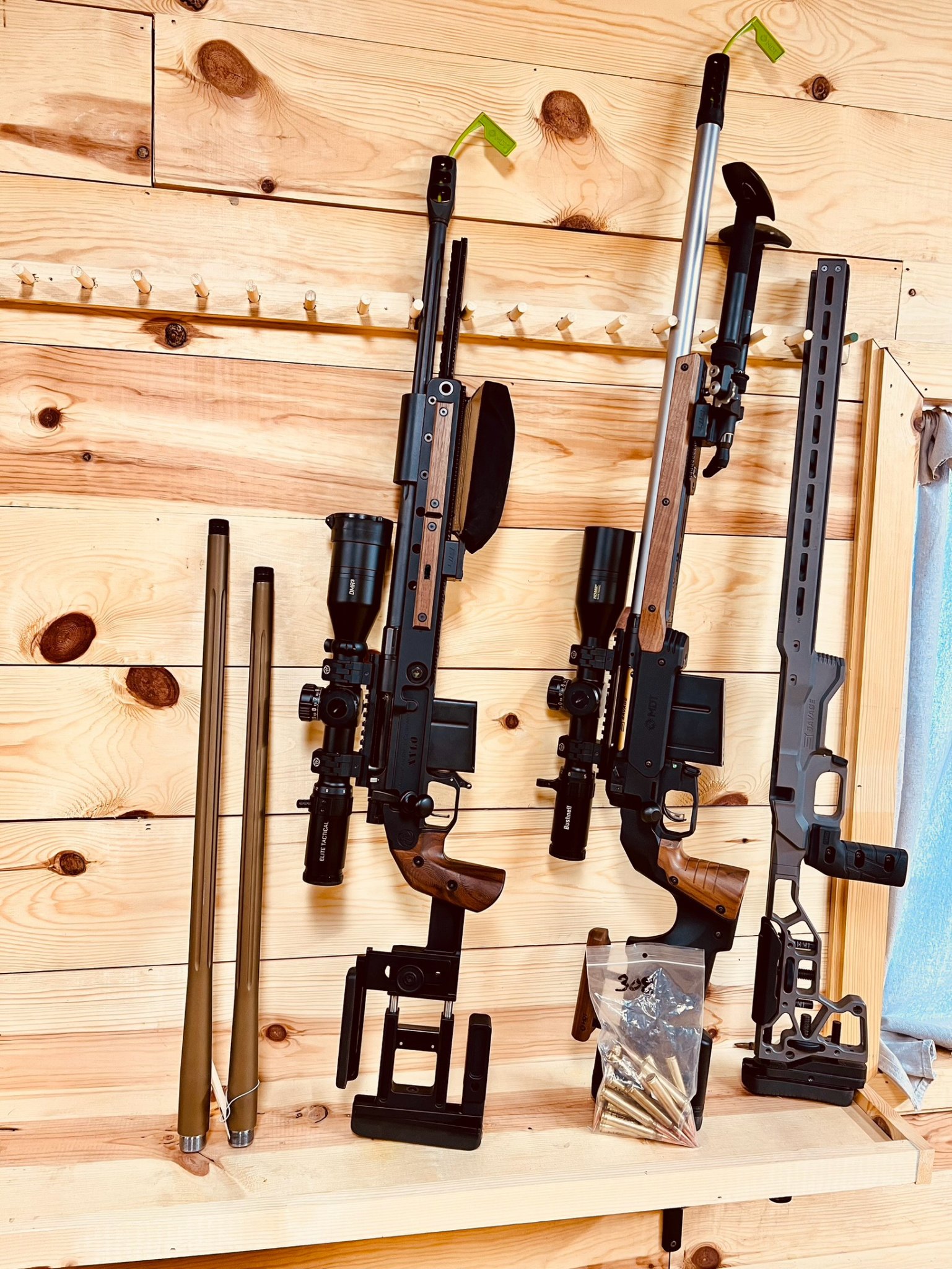

I do the minimalist thing "switch barrel" with a Nuke Gen 2 SA Xylo stock 308WIN/708AI, and "switch stock" with a Savage Elite 110 300WM between MDT ACC and XRS. MDT XRS stocks make for a good hunting stock. I hunt bolt guns static though as a hog hunter. Bait pile shoot at 400yds and then strafe the pack with my AR10 after I drop the big pig. One could big game hunt, mountain trek, with a Nuke in an XRS or a Manners stock. XRS way cheaper. I do like the look of wood, so I give my rigs some wood pops/flair. LOL
I like it! I have a couple of Stocky's carbon fiber stocks and an XRS element chassis I would use as my primary stocks.

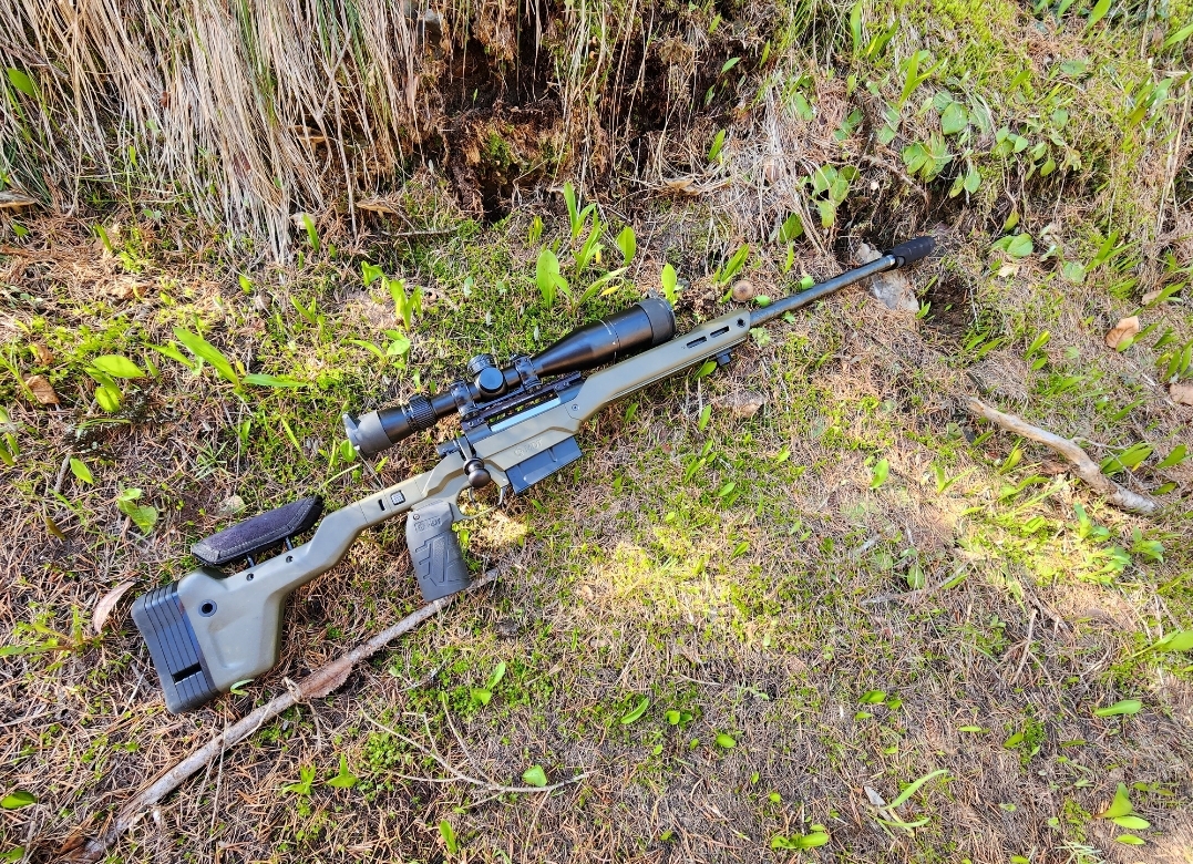

Had the same idea and built out a multi-caliber platform off of the M7 Mausingfield. I f#@%ing love this rifle.
M7 Mausingfield Long Action
MDT HNT26 Folder Chassis
MDT Vertical Grip Elite
Triggertech Diamond
Spuhr Hunter Scope Mount
Vortex LHT 4.5-22x50
Area 419 Hellfire (Now run a TBAC U9)
20" Proof .308 prefit
23" Carbon Six 27 Nosler prefit
25" Carbon Six 6-Dasher prefit

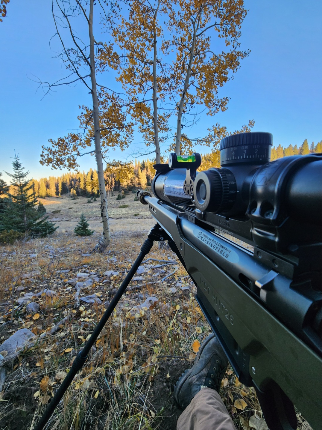

Had to fudge with the feed lips on some Accurate-Mags to get the dashers to feed reliably out of the long action, but she eats like a sad girl now. CRF is a game changer for this. Would never get that to feed right in a push-feed.
Its an absolute dream to carry. Love being able to fold the stock and side mount it on my pack. The full length arca is great on the HNT26; it's nice to be able to throw it on my tripod that I'm already glassing from.

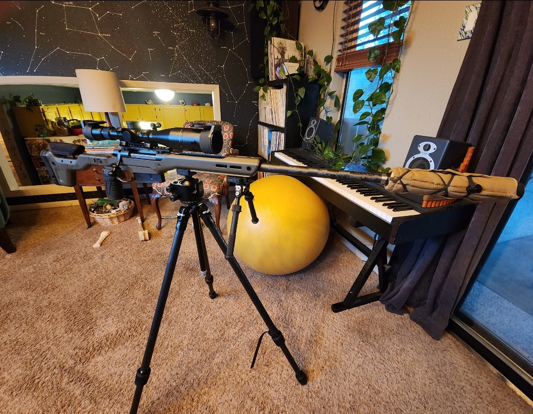

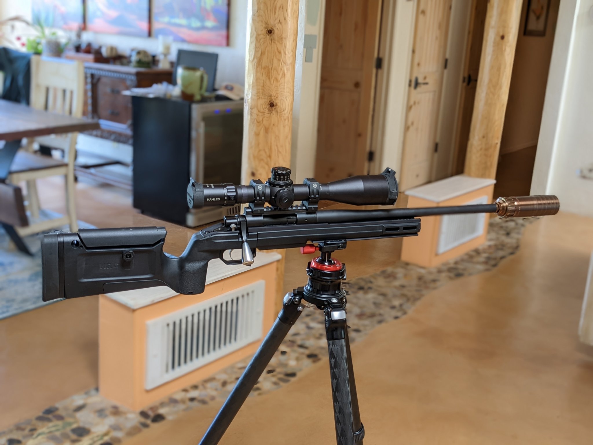

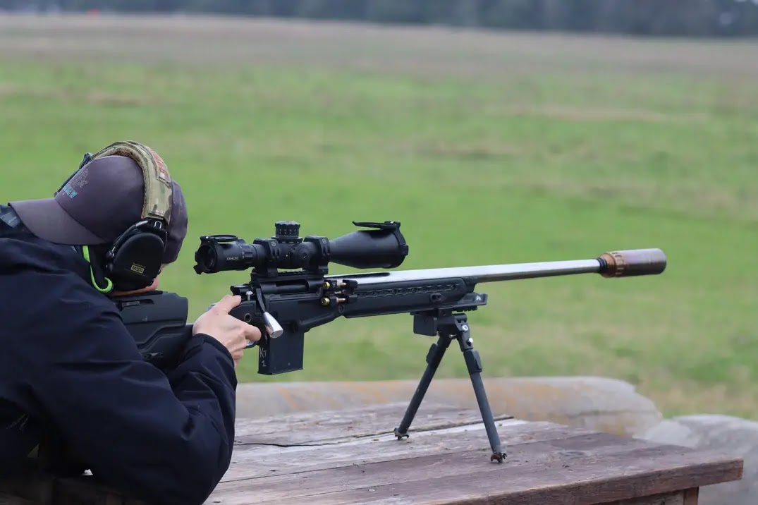

I actually do this with my Mausingfield. Recently got into hunting, and couldn't justify the expense of building a dedicated hunting rifle. So I bought a KRG Bravo chassis and had my gunsmith spin up an 18# lightweight hunting barrel for it.
Here it is in competition mode (~21#):
Here it is in hunting mode (~12#):

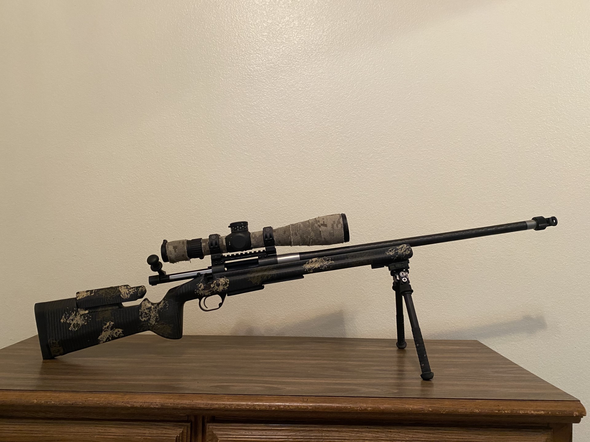

Here's one of the better builds I've done off of an ARC action. Its a Mausingfield M7 open top short action with a Bartlein left hand gain twist barrel in 7 SAUM sitting in a Manners LRH stock. 10.3 lbs without the bipod/can. Fantanstic set up.
