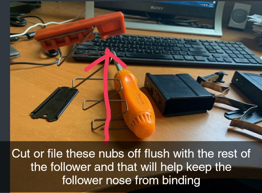

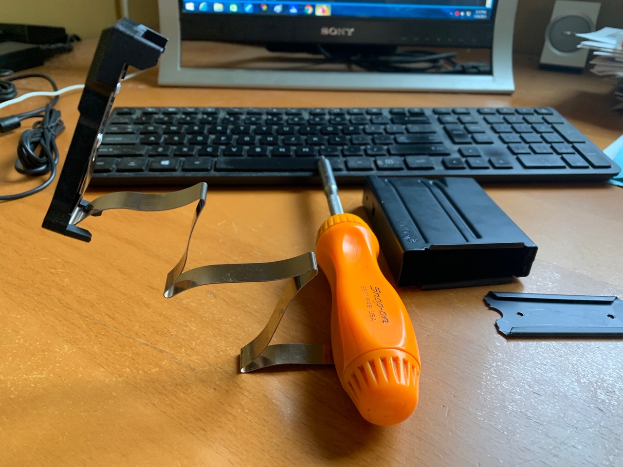

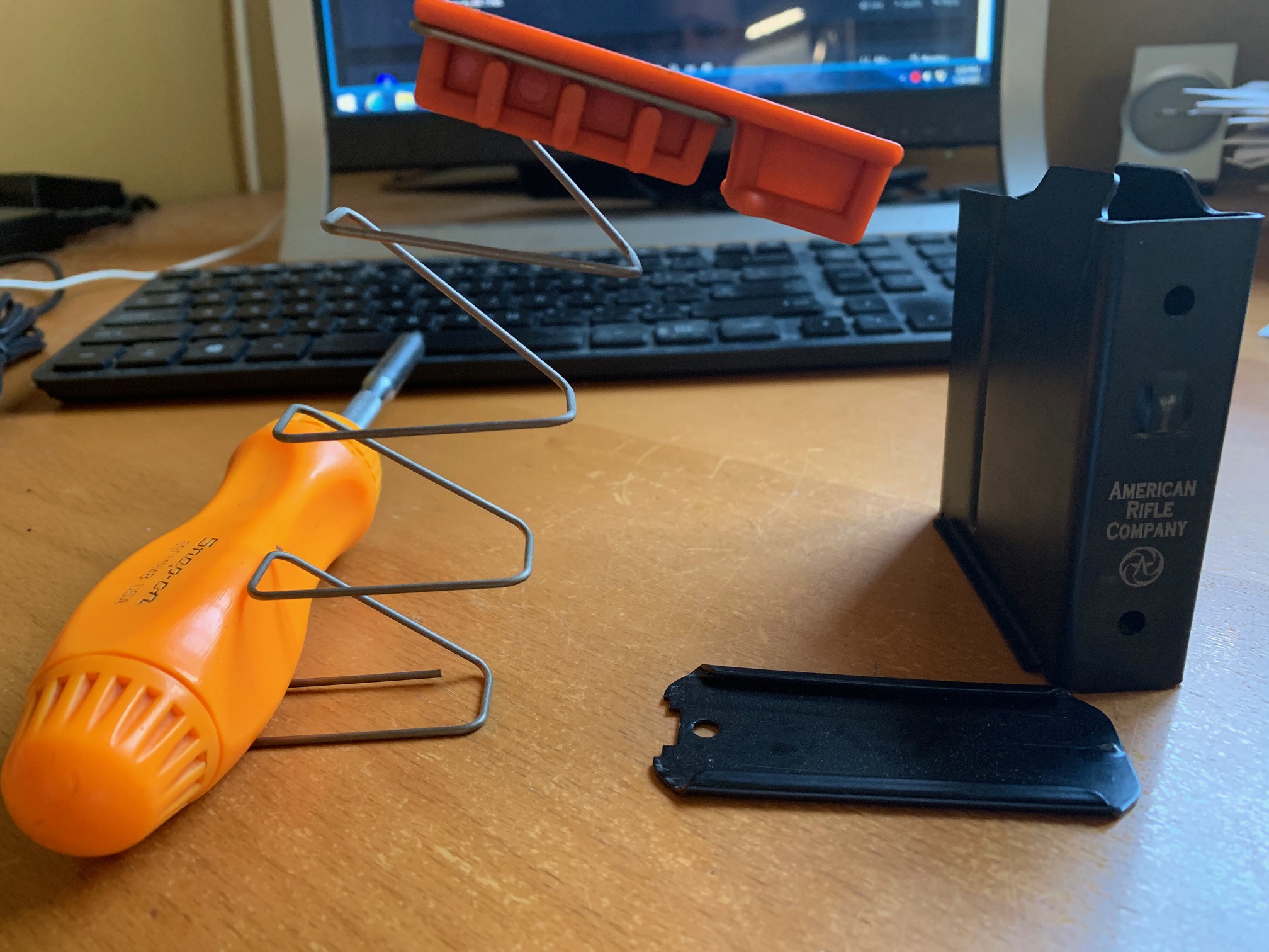

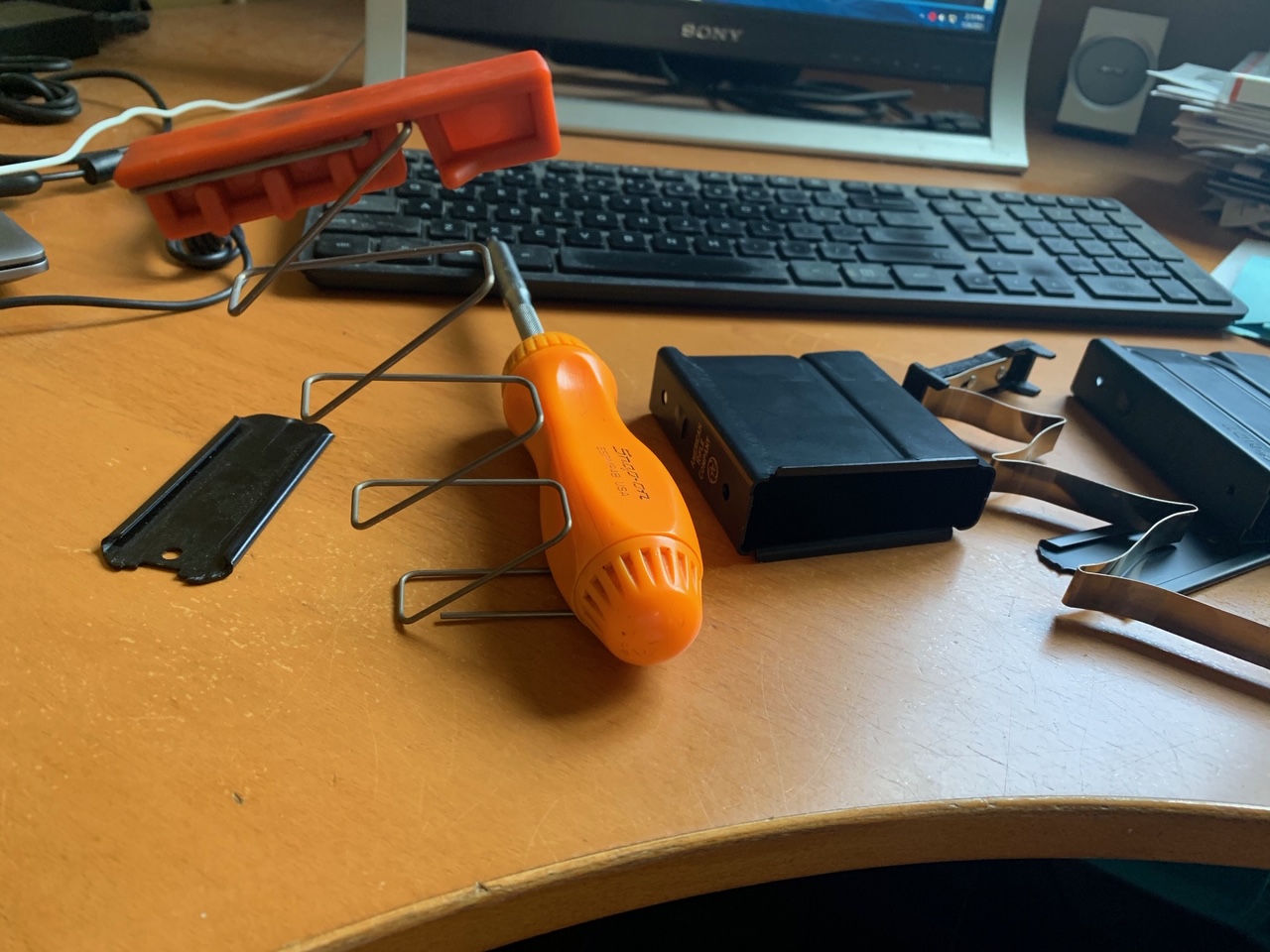

    @kthomas - Got any pictures of your early production mags apart? You kind of peaked my interest here cause I'm trying to finish up a Mausingfield 6GT build today & ARC mags was what I intend to use.
    Down the rabbit hole I go.
    The mag pictured below is a late production ARC. As of yesterday I'm @ 160 flawless feeds through a 6.5 C ARC Nuke Xylo.
    One oddity I see is that the spring bottom on the ARC mag (per ARC assembly) seams like it would bias follower to nose down.
    MDT is the opposite, follower nose biased up via spring orientation.
    I switched my spring around in the ARC & tried it. Still no issues. Does it make a difference? Hell if I know YMMV.
    I do plan on picking up a few LRI followers to try with the reversed spring.
    This is with mag spring reversed. You'll see at about round 5 I get a snug bolt close. Head space is really tight on this 4th of July ARC rifle. about 1 in 20 is snug close.

    I'll have to take it apart to confirm, but from memory mine looks very similar to yours. Same follower. I'm not sure if ARC has done any production updates on the mag? I know at some point there was talk of it.
    I won't be able to take it apart today, but if I remember tomorrow, I'll take it apart and post some pictures.
    Sounds like yours is working at least. When I used mine with 6.5 Creedmoor, I couldn't get through one mag without at least one instance of a round nose diving. And my experience today with .308 reaffirms what I remember with my 6.5 Creedmoor.
    Reactions: Halfnutz
    The nose down seems to make at least a little sense with CRF as long as the long as tip has room to is presented to the chamber in alignment.
    I was tempted not to post this at all as I thought it was not an issue, I guess maybe I was wrong and opened a can of worms in a sense.
