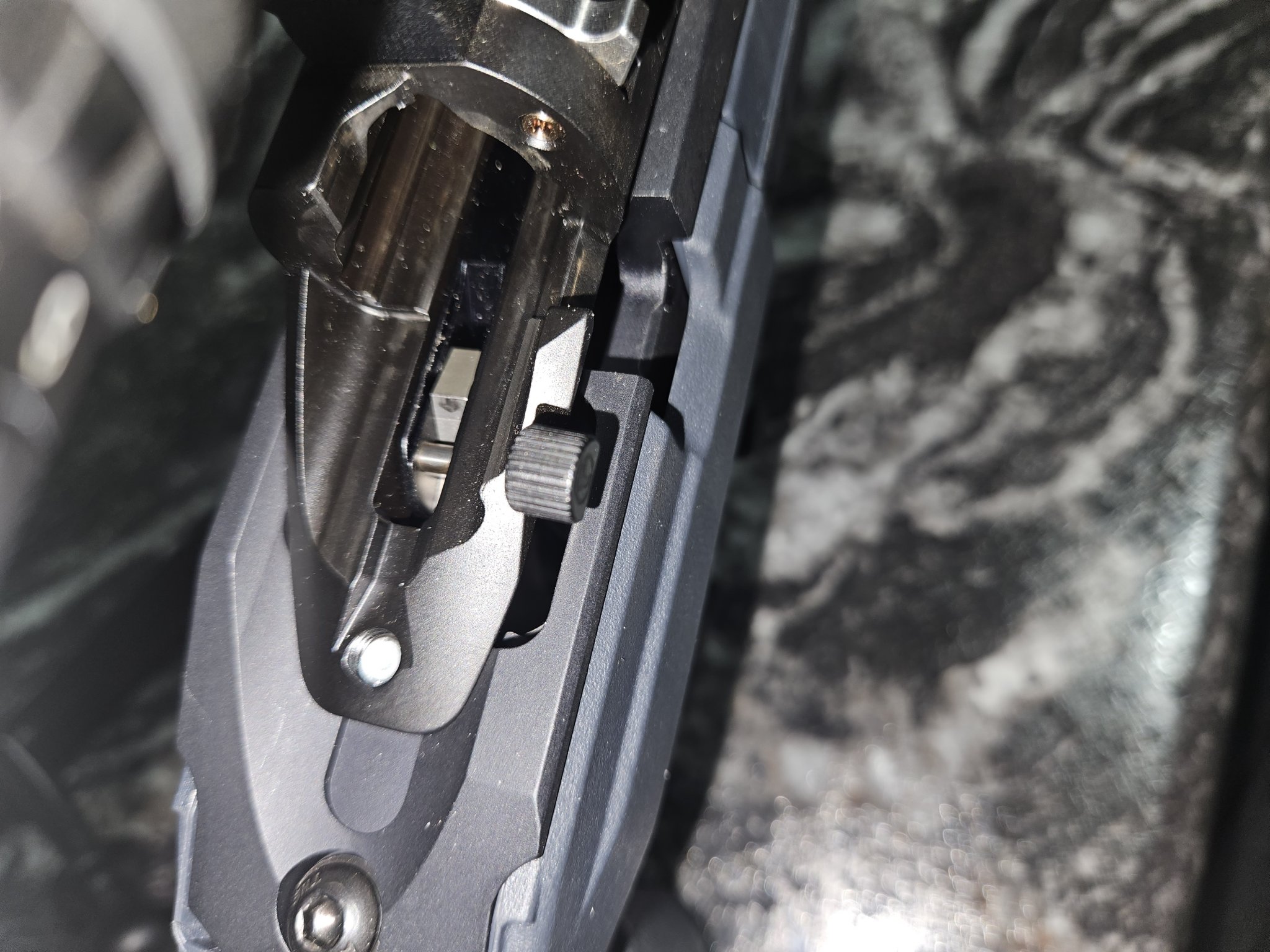

Okay so without taking the gun back apart right this second I wanted to replicate the trigger fail and here is what happens is that sear is sticking down is that a trigger weight issue or a flush the trigger with lighter fluid issue?
Most likely the trigger is either not adjusted correctly or broken. Send back to the MFG for inspection/repair or replace it.
Did you touch the adjustment screws?
No when I bought the barreled action pva installed it and sent it to me I just dropped it in the krg and went to town never messed with it other than made sure it was safe to use!
If it worked and suddenly it doesn’t work, something is broken. I concur with @whatsupdoc and go with sending the trigger back to the manufacturer.
Thankyou everyone for your help and education with this i sent the trigger back to timney and they got me up and running again. The trigger did have some broken parts in it and they fixed it and sent it back to me!
