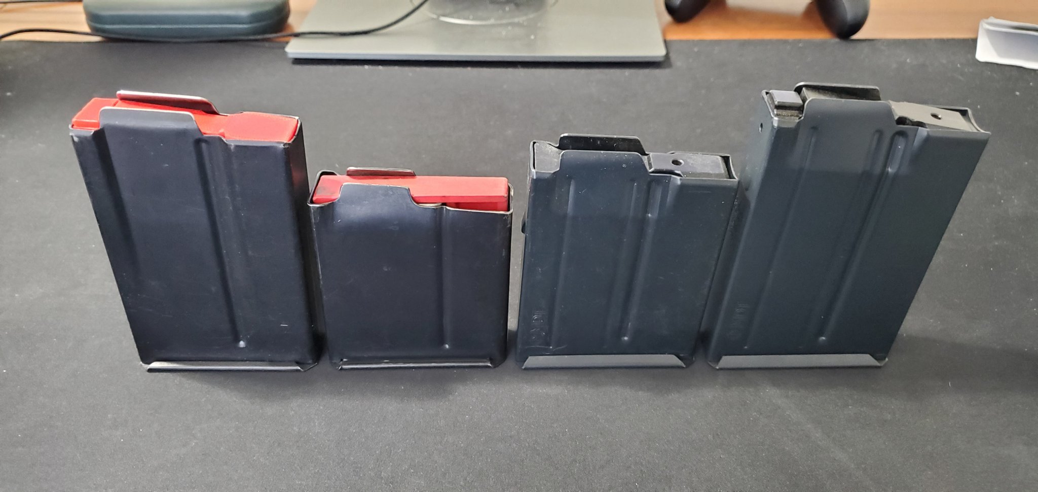

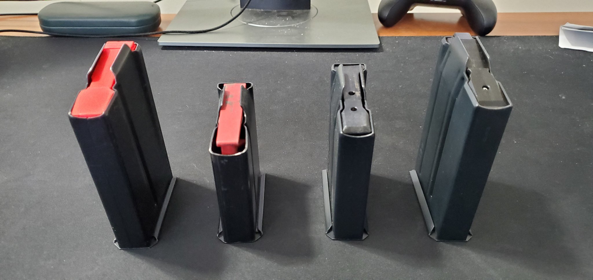

Anyone have a picture of the ARC next to the MDT 10 rounder?
From left to right: Accurate Mag, ARC Mag, 10 Round MDT, 12 round MDT
Hope that helps give you the comparison you were looking for. The ARC mag is more or less the same size as an AIAW magazine, while the MDT sits just about exactly in the middle between the AICS and the AIAW.
