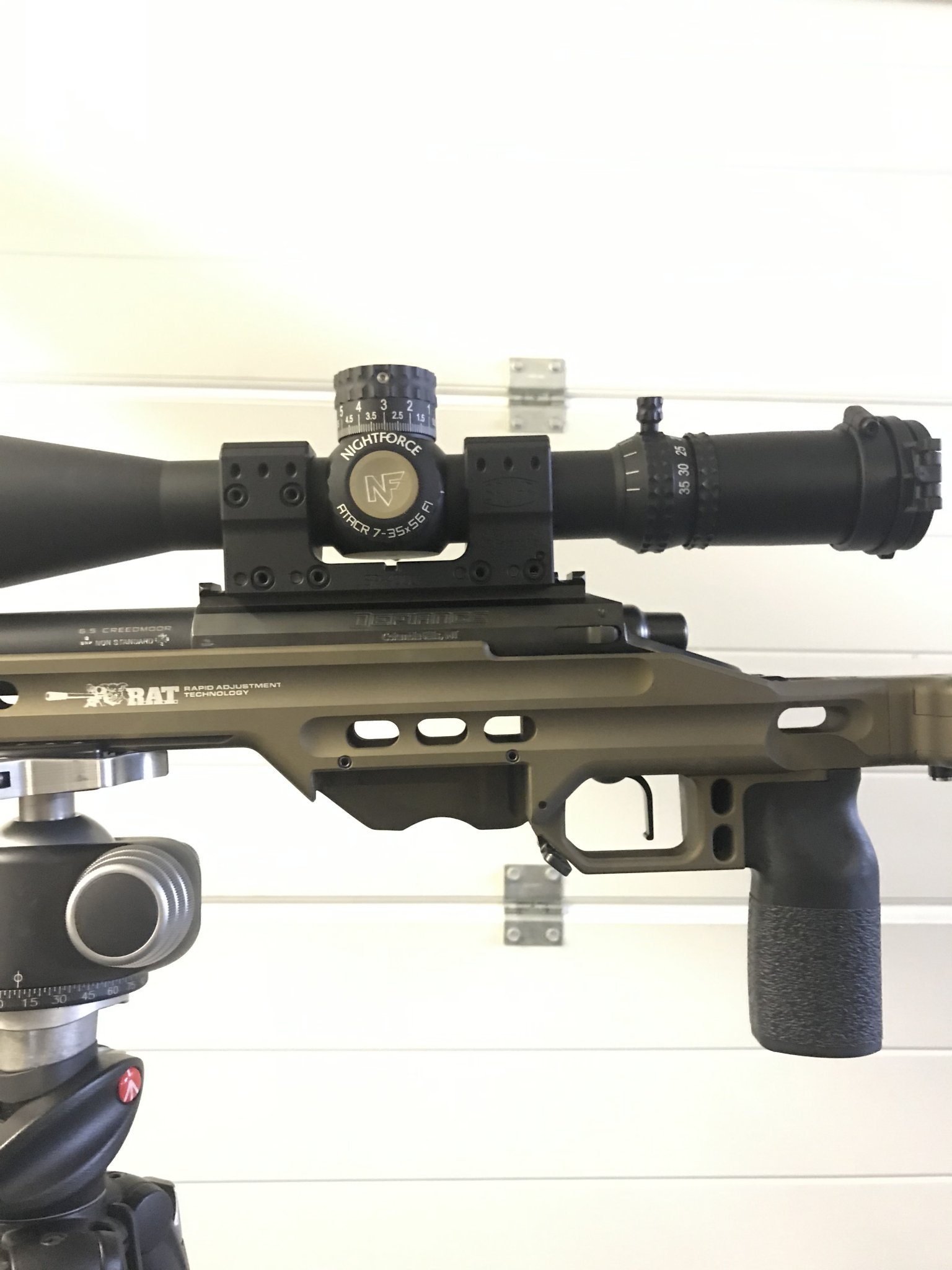

Hey guys I finally upgraded my tripod from something laughable to something reasonable. I scooped up a manfrotto 190cxpro w/ the 322rc22 ballhead. I have used this type of setup extensively for some time but never owned it up until now. I want to get away from proprietary QD plates and switch over to ARCA. I'm looking for a good ballhead that's user friendly and robust enough to shoot off of. This will be a field tripod used both on the range, during competition (Mammoth, Purgatory and PRS stuff) and in the field. Looking for any suggestions because I've had limited exposure to ARCA so far. Thanks for any feedback you can fire my way??
Looking at the Feisol CB-50D...looks like a solid ballhead. Anyone have either experience on this one or suggest otherwise?

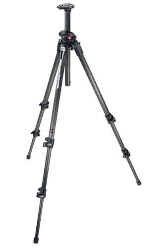

Hi, I did a search for your Manfrotto 190cxpro tripod. As I understand, this tripod has the three tripod legs and a central mast that can adjust vertically or positioned sideways.
While the tripod legs are reasonably solid, the mast works against your needs for supporting a rifle. In the down position the mast limits the tripods ability to shoot from a prone position and when extended it will wave around and make it hard to get a solid sight picture. Bottom line, adding a ballhead and an arca adaptor on top of this assembly will not likely give you a solid sight picture nor work well for recoil management.
An alternative you might consider would be to ditch the mast and ballhead all together and just use the legs with something like an Armageddon Game Changer on top. This combination should provide a precision hold, be faster, more flexible, and really help with recoil management compared to shooting off that mast.
Rasyad
That is not a bad idea. I bet it would be more stable just throwing a gc on top. Of course its less fun but this tripod was not what I had expected once it arrived, but I do like the lightweight nature of it for field use, field matches and hunting. It seems like it would excel for those purposes. As far as PRS work goes, it'll be a distinct disadvantage especially with any winds beyond 5mph lol.

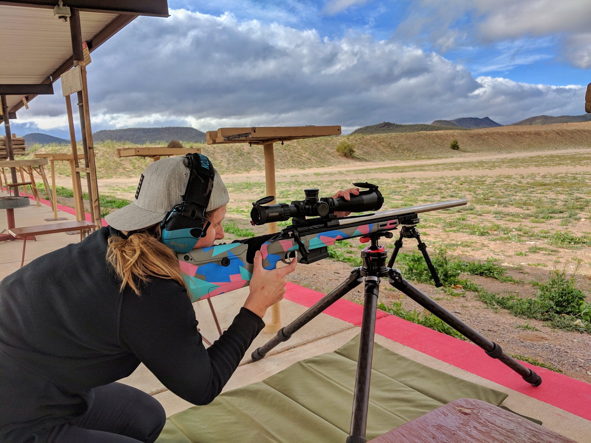

I'm using a Uniqball UBH-45 gimbal ballhead. It's rated for 88 lbs, so it's pretty stout and steady. The best feature about this ballhead, which I haven't seen in any others, is that it has a built in gimbal system. You level the main ballhead housing, and lock it in. From there, you can pan on the horizontal plane and tilt on the vertical plane, without introducing ANY cant into the system.
Here's my wife shooting her rifle with my ballhead and RRS tripod setup:
