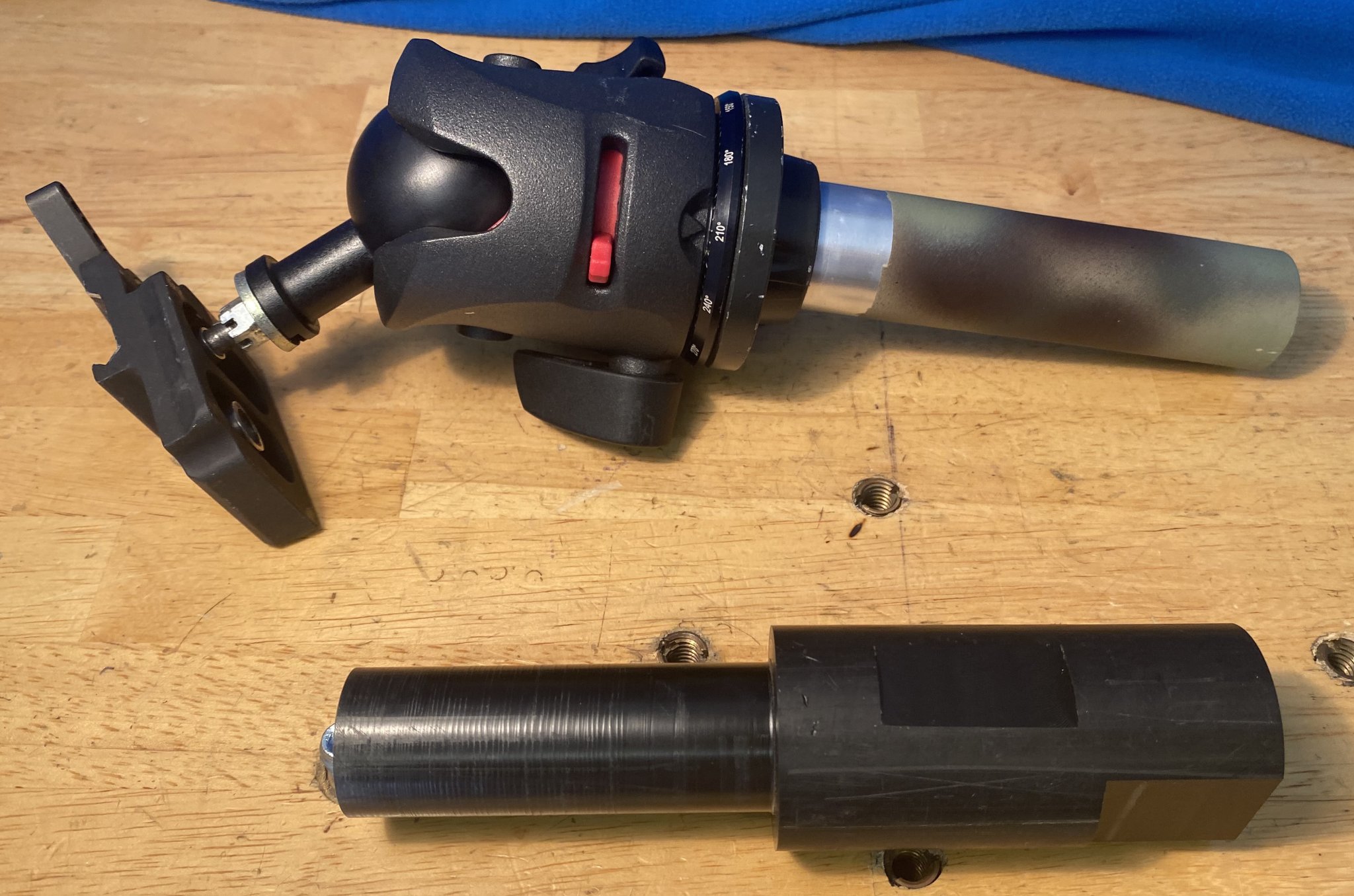

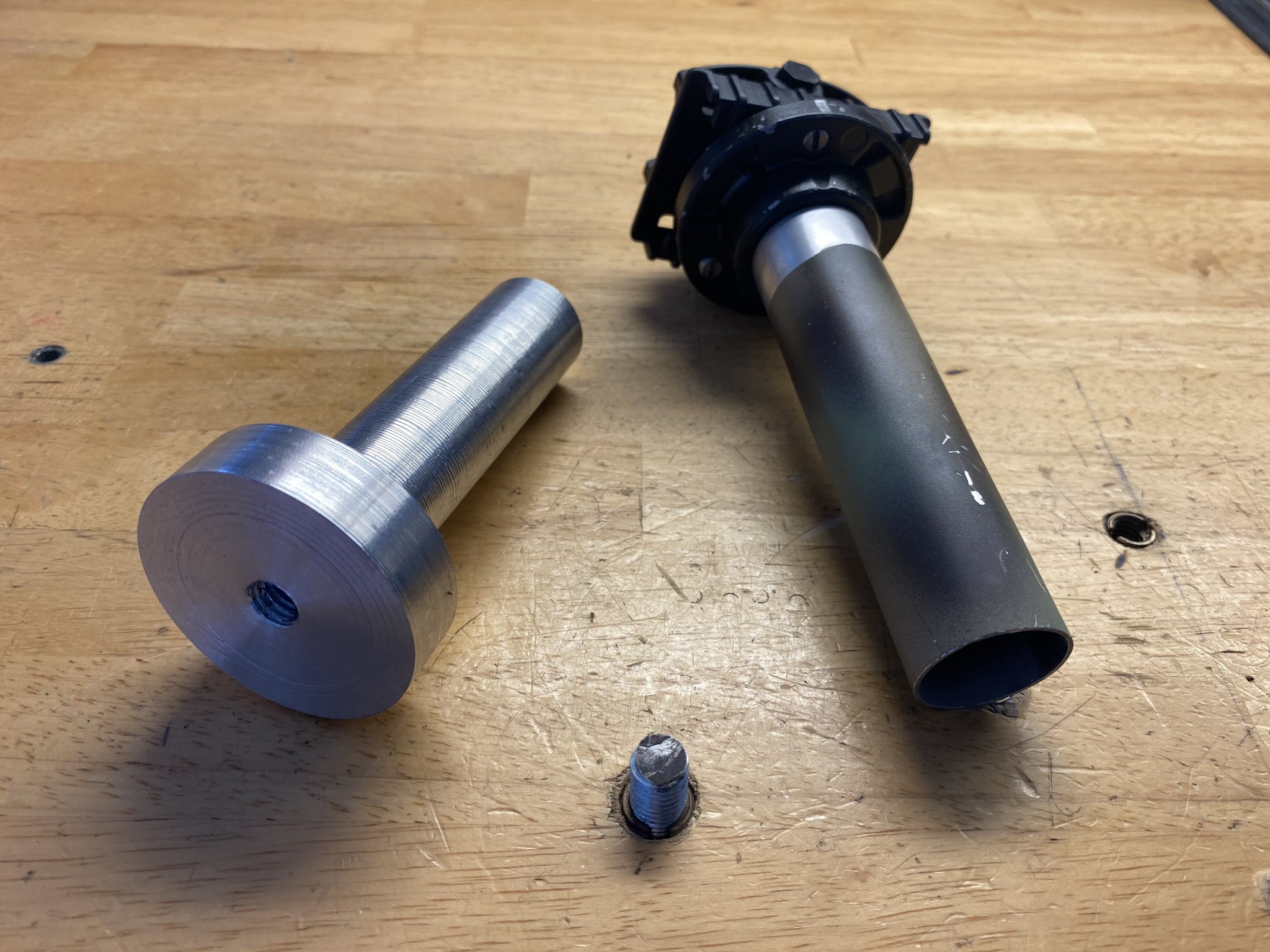

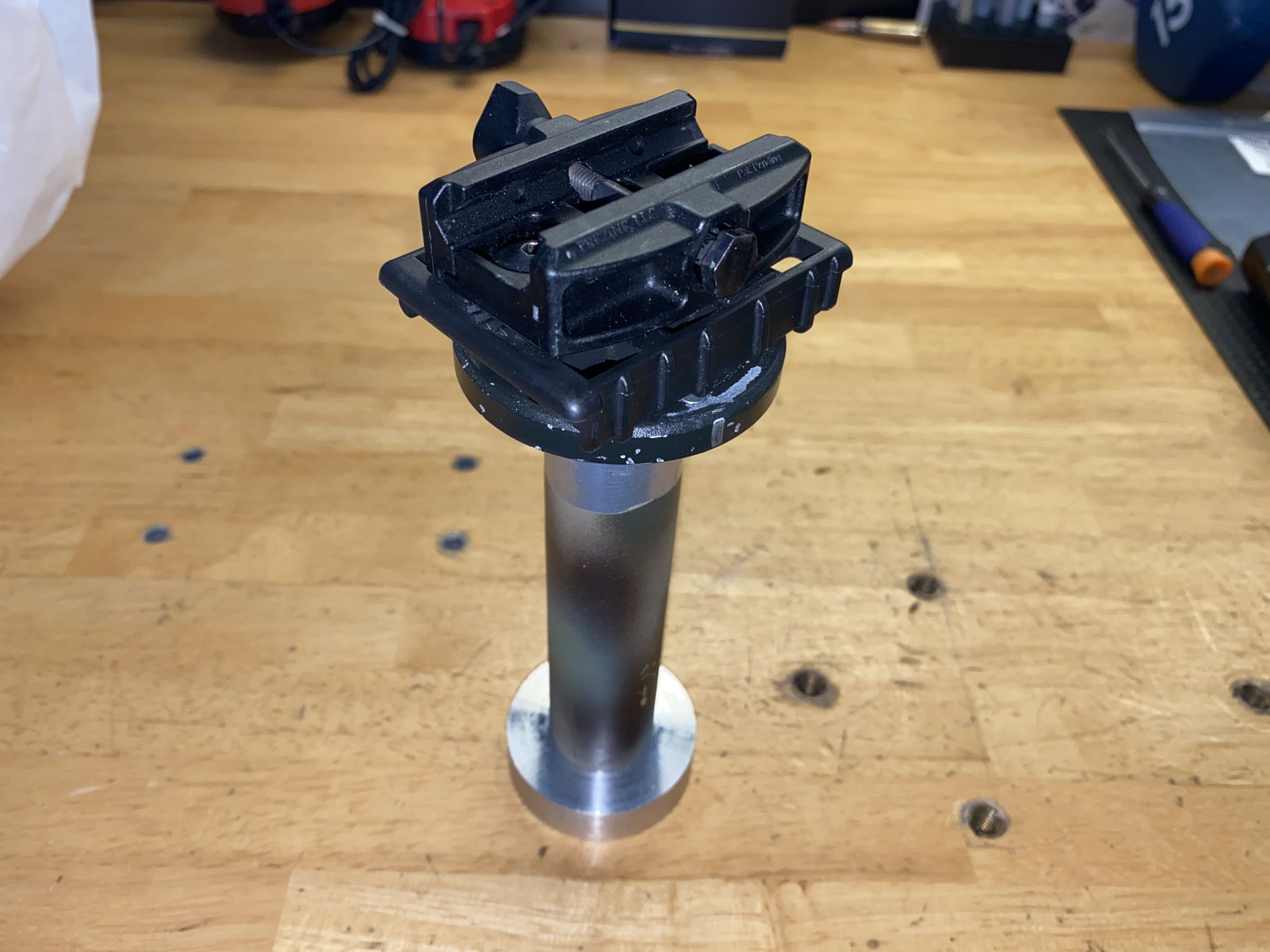

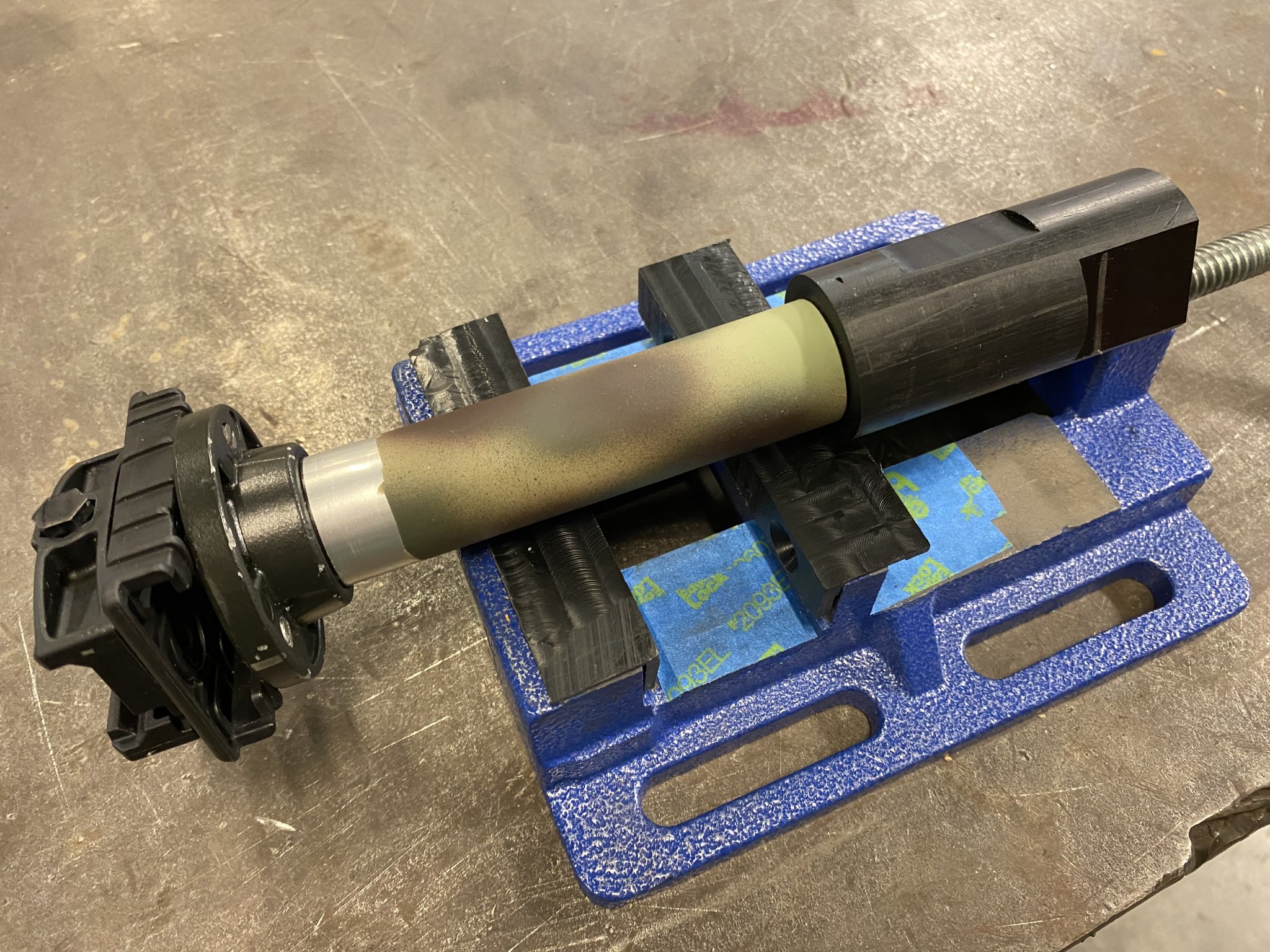

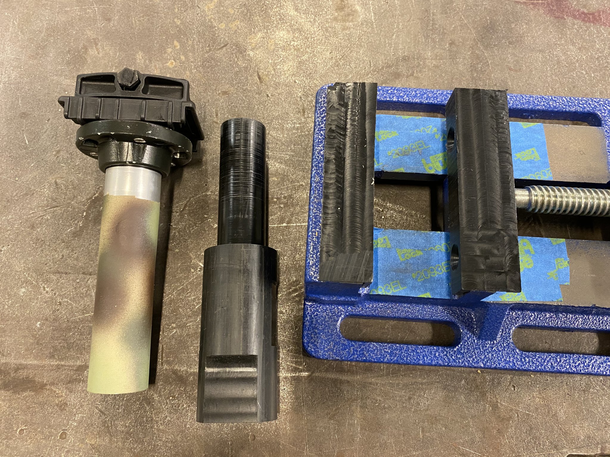

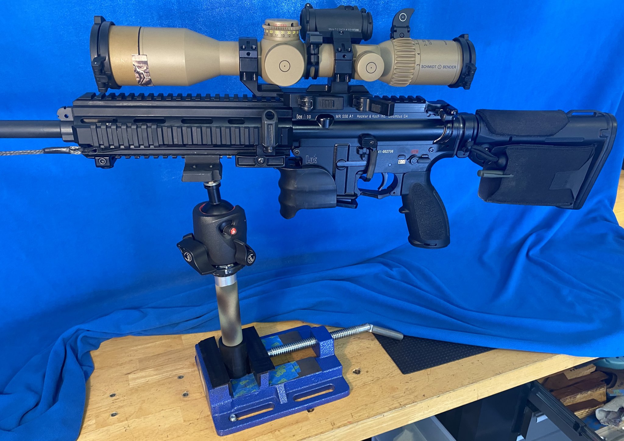

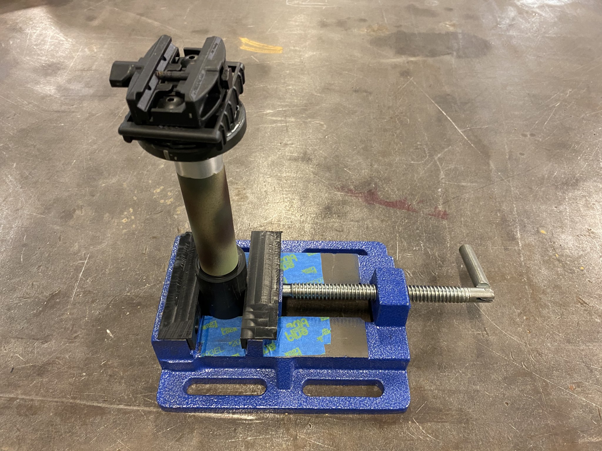

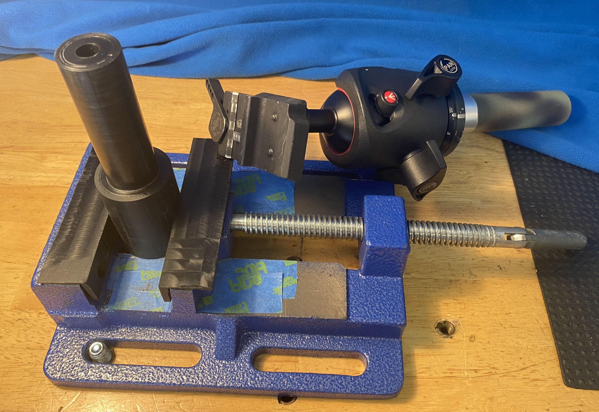

I have fabricated a number of magwell delrin vise blocks but the problem is the gun does not rotate 360 and it's too often at a low height off the bench. The articulating ball heads are particularly handy in some situations.
I did as some suggested above, not for the Arca, but other clamps using old Manfrotto center column/base and some delrin to make a
variety of options for bench top work.
These might give the OP some ideas for his situation.

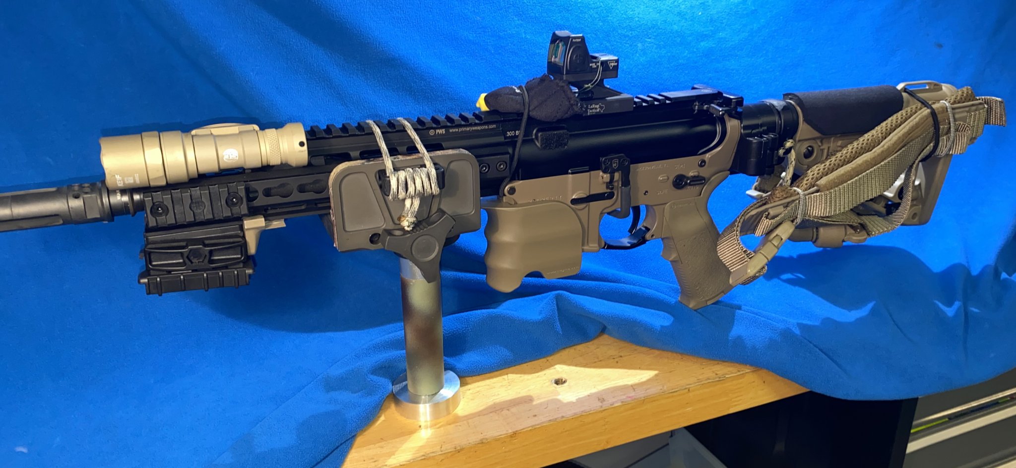

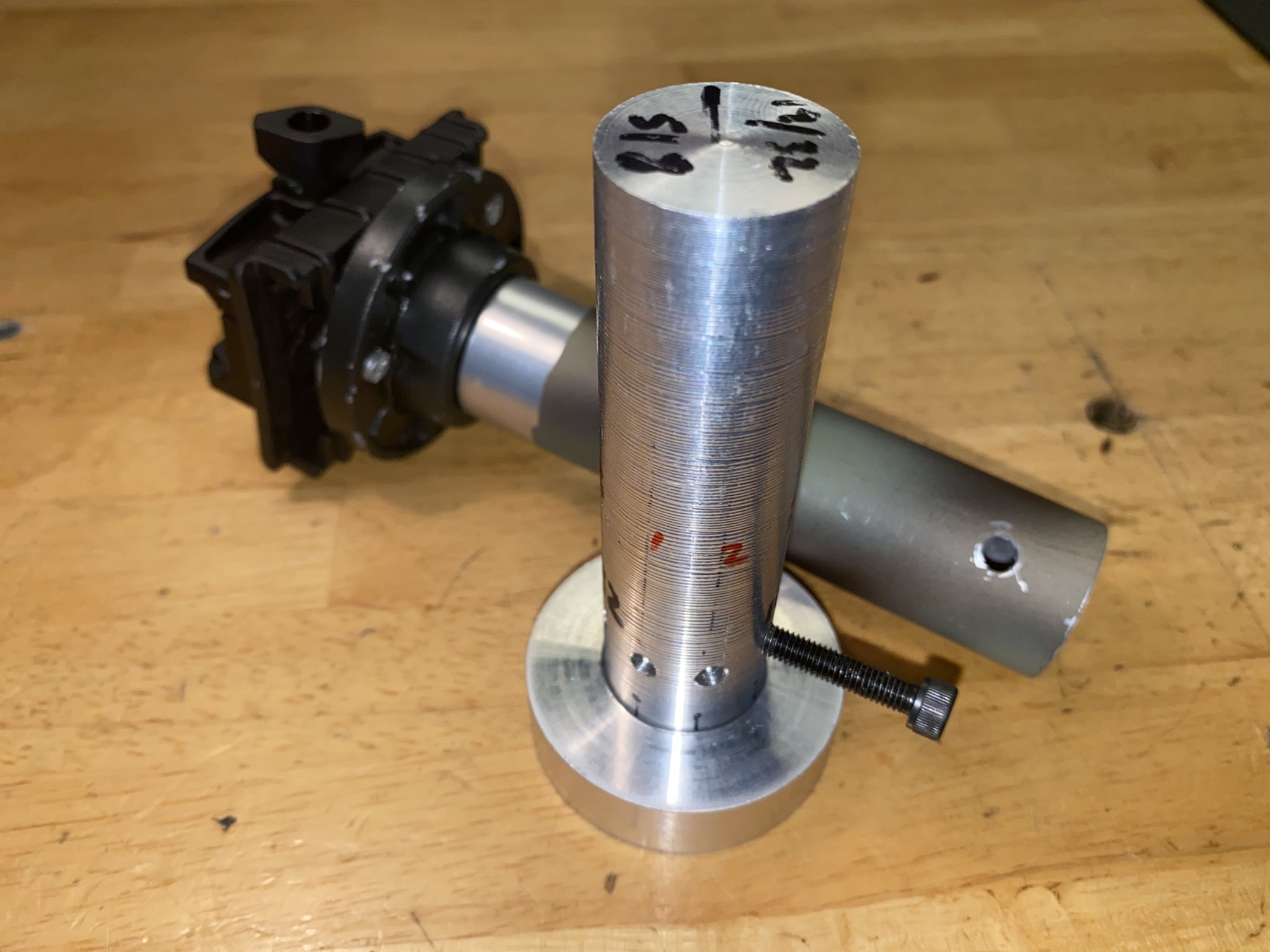

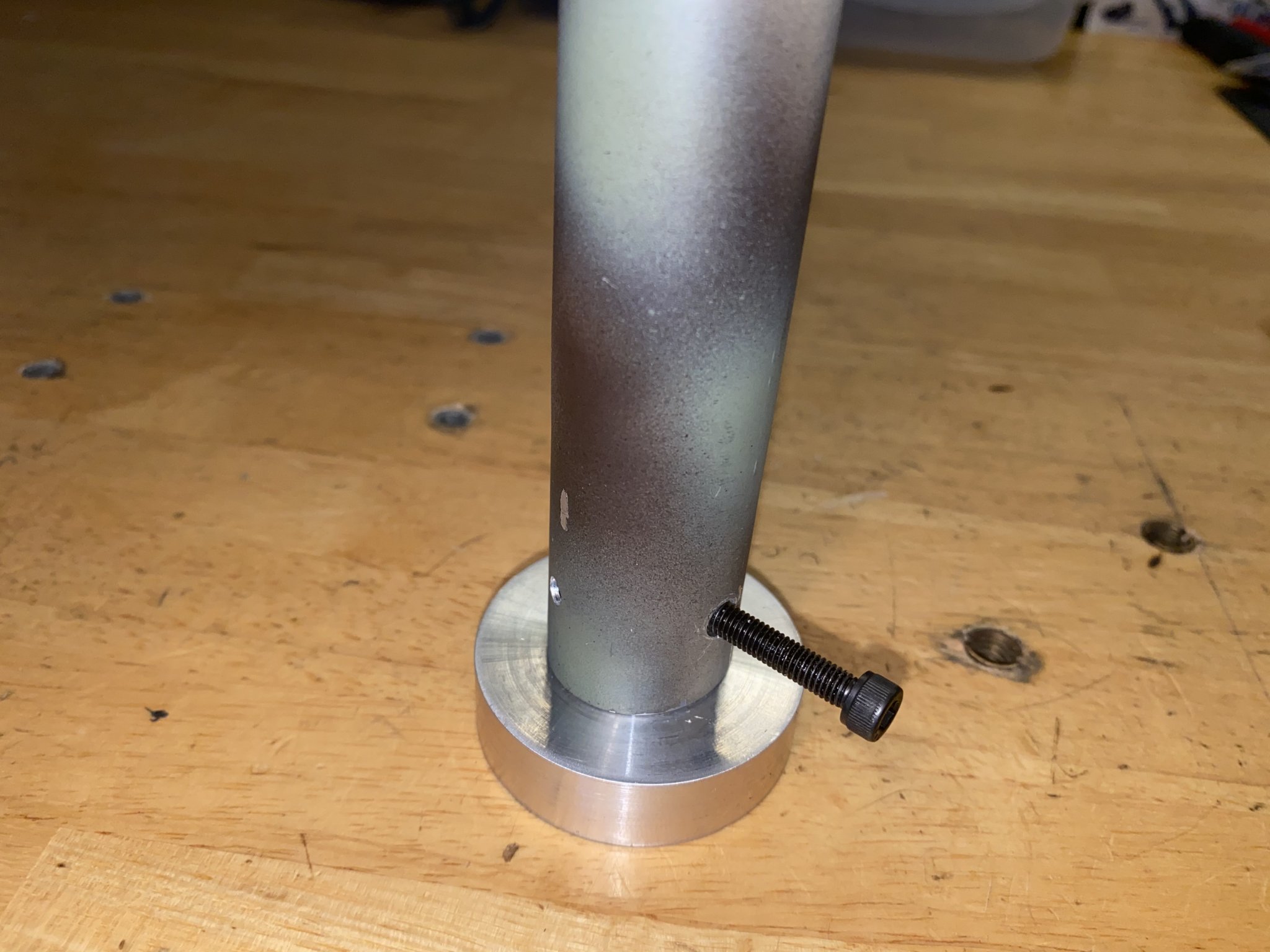

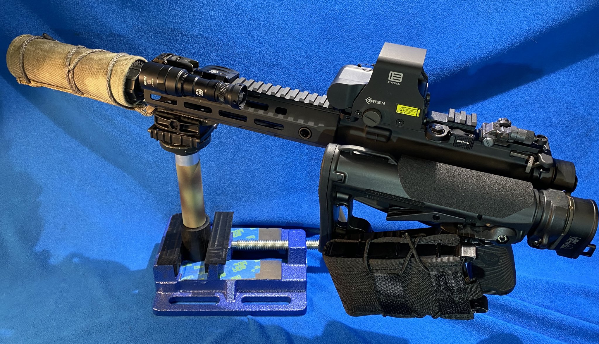

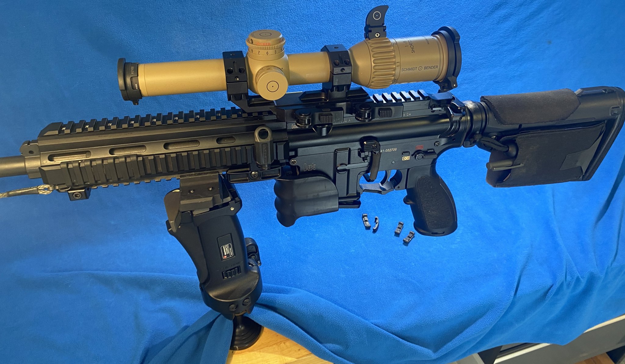

and a few more.
The solid aluminum post was further improved once I drilled / tapped holes circumferentially to fix its position for some odd work configurations.

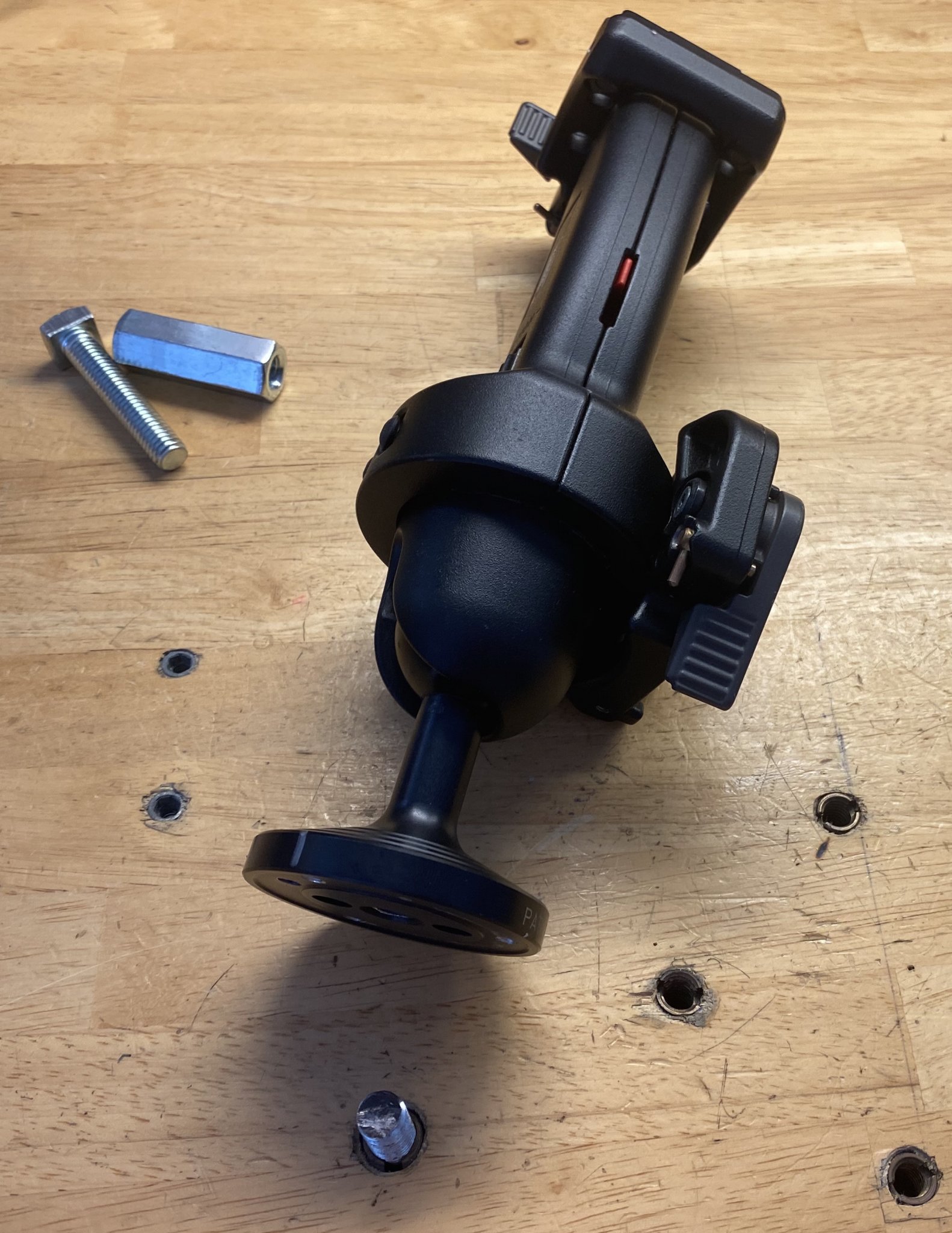

You can bolt this to a block of wood.
Or this if you have an extra ball head.
