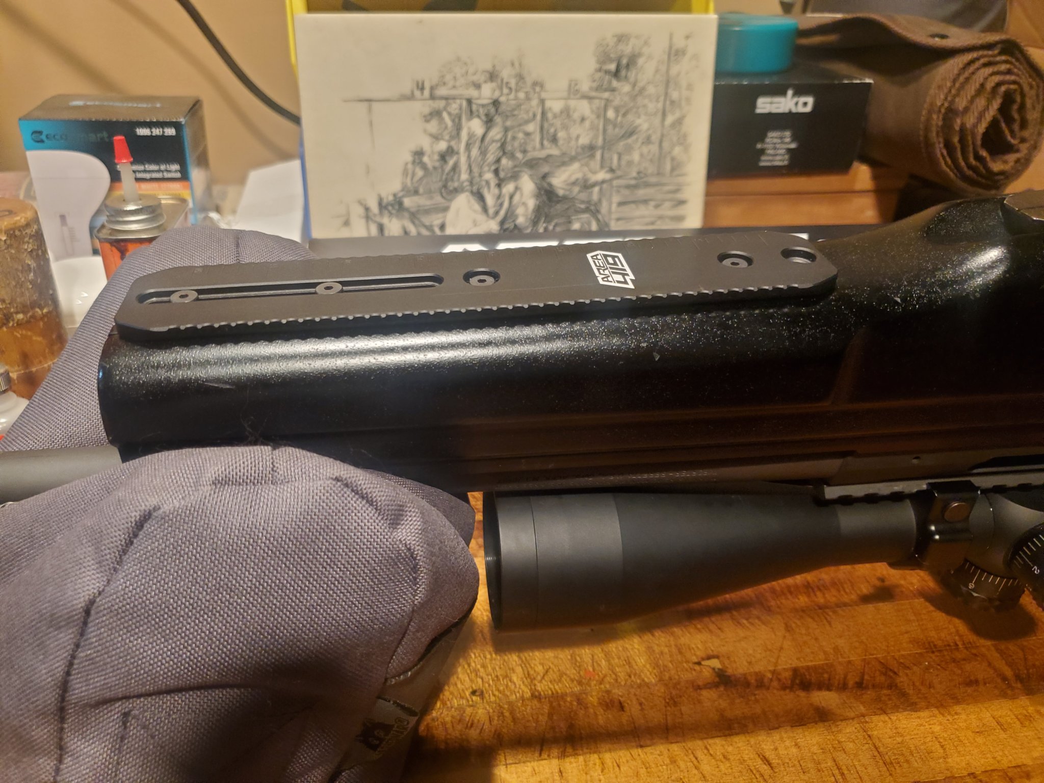

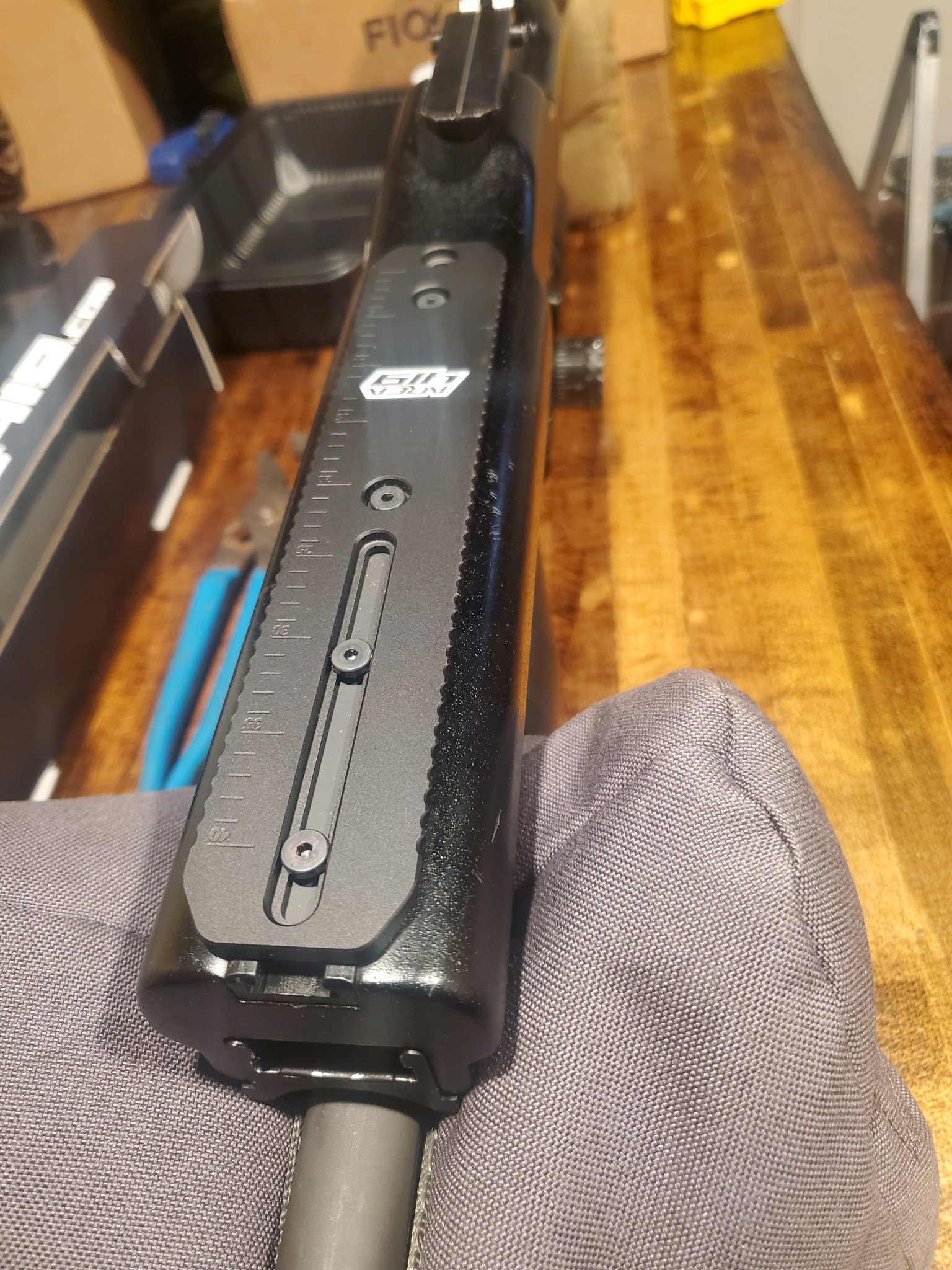

Found a Canadain company called Coretac Solutions that offer a few ARCA rail options for the TRG. They were helpful through emails. Its basically a bracket that slides in the forearm slot that the arca rail bolts to. Installed it today and haven't had a chance the test it out but if feels solid.
