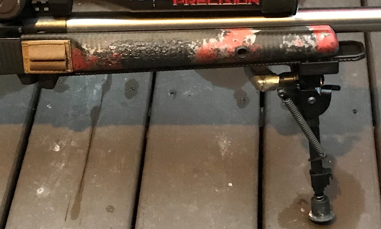

Measure the forend and see how long it is. Having hangover up front is not a bad thing as it allows for more flexibility in placing the bipod out farther depending on the prop. Below is a 14" on one of my Manners stocks and I like having the over hang.
