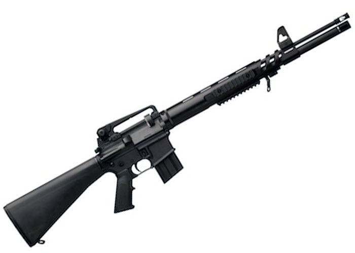

Here you go.
http://www.midwayusa.com/product/31...on-kit-177-caliber-polymer-stock-matte-barrel
