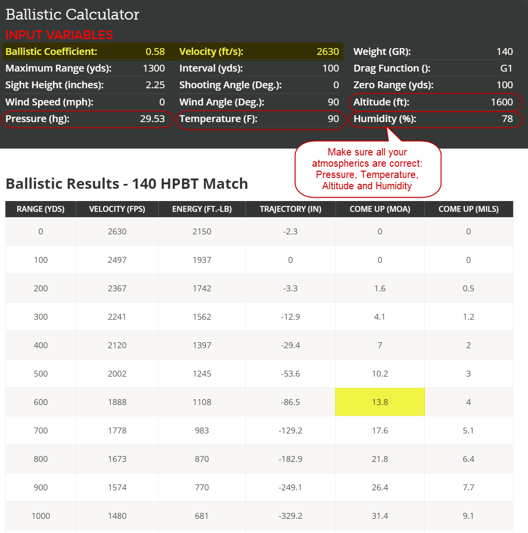

Part of the reason I ask is that I have not yet found a ballistics program that matches the performance of my handload. Hornady program at 600 yds says I should be at 13.8 MOA when in fact 12.0 MOA is just right. Programs are similarly off at 200 and 400 yrs. I have wondered whether it is the program or my scope (I think Tract is reasonably good brand; their own ballistics program, with my load, matches Hornady). For info, I am shooting Ruger PR 6.5 Creedmoor, 140 gn Hornady Match HPBT and 40.5 gn H-4350. Roughly 2630 FPS so it is not a hot load but I am almost 2 MOA less drop than predicted??

Next up is your finding that your ballistic program is showing 13.8 MOA at 600 yards but your DOPE shows 12.0 MOA is what your rifle/load is actually doing. Keep in mind that while ballistic programs have gotten better over the years they are not perfect and you absolutely must true your data to match what your DOPE is telling you. Here's the thing, I've seen some recommend that you true your velocity in order to come up with the proper corrections, but I agree with Frank (@Lowlight ) in that you should true your BC and not your velocity, so adjust your BC in the ballistic app until you get the results that match your DOPE; I would also recommend you do this at multiple distances. Also, make sure that you are entering in all your atmospherics correctly and ignore the Coriolis and spin drift settings as the margin of error won't matter at the distances you're shooting.

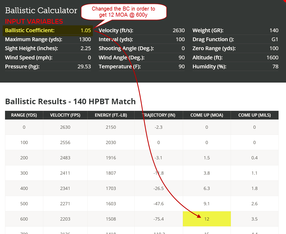

I thought that might be the case, instead of trueing your velocity, leave your velocity as is (because you're velocity is your velocity) and instead, go in and change your BC for the bullet in the ballistic app, since you are getting "better" ballistics from your DOPE vs your app I'd recommend increasing your BC. For example, you mentioned you're using the Hornady 140gr HPBT Match bullet which has a G1 BC of .580 and you said your muzzle velocity is 2630, using the Hornady App I had to adjust atmospherics to the following in order to get your 13.8 MOA adjustment at 600 yards (granted, I guessed at atmospherics but you should be using a Kestrel or other device to get the real world results):
So, you say you're changing velocity in order to correct for your DOPE; however, instead of altering velocity you should leave the velocity as is and alter your BC, in order to get 12 MOA at 600 yards I had to bump up the BC to 1.05 which is a massive leap from .580
What does this tell me, it tells me that something is way off because 13.8 to 12 MOA is too much. What are you using to measure your muzzle velocity and are you sure it's calibrated, do you have a buddy nearby who also has a chronometer? I prefer the Magnetospeed because my old Chrony would sometimes give me false positives. Are you sure you read your muzzle velocity correct? Sometimes an 8 can look like a 6 if you're not paying attention (I've done that before!) If you're certain your muzzle velocity is correct, then double check all your atmospherics, do you have a Kestrel or other device that will give you accurate atmospherics? Instead of using the online ballistics apps, do you have a smartphone that you can download an app into, most of these will use a feature called density altitude which many prefer, or better yet, possibly look into getting a Kestrel with Applied Ballistics built in and that way you can get real time atmospherics with your solution all in one.
There are other guys here on the forum who are much more knowledgeable than I so hopefully they'll chime in and might be able to help you further troubleshoot this issue, but you've given enough information to indicate something seems very wrong.

Your load dev sounds pretty solid and the fact you're using the latest Magnetospeed should indicate you're getting accurate velocity numbers. In lieu of that I'm back to thinking something is wonky with your atmospherics.
I understand having just purchased the NF 7-35 took a dent in your financials and the Kestrel's aren't cheap, at least not the ones with AB in them. Another alternative is what I have, the WeatherFlow WeatherMeter which is an $85 alternative to the pricey Kestrel's, but it is dependent on the BallisticsARC app and smartphones can have issues in the field - be it from losing battery or sitting in the hot sun, etc. I've been wanting the Garmin 701 to support connection to the WeatherMeter for wind but that hasn't happened yet, the Kestrel (to me) has too small of a readout which is why something like the Garmin is more appealing.
Anyway, back to the issue at hand, why is your DOPE so far off from the ballistics engine's predictions? If you download the free version of BallisticsARC it allows you to input one rifle/load and has the ability to link to Online weather stations in your area, this would at least be better than guessing at what your atmospherics might be, I'd be curious if you did this if it made a difference in the ensuing ballistic chart.
