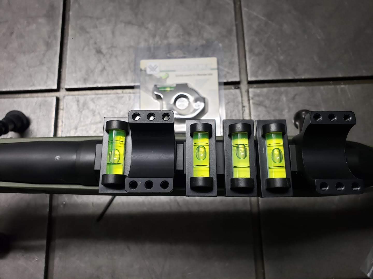

The cheap chinese bubbles on Amazon are not that great. For example, I lined about four of them up on the rail of one gun and then all gave slightly different readings. I ended up having to "average" them to determine if the gun was level. If you want to get an accurate level for a surface you really need to purchase a "machinist level".

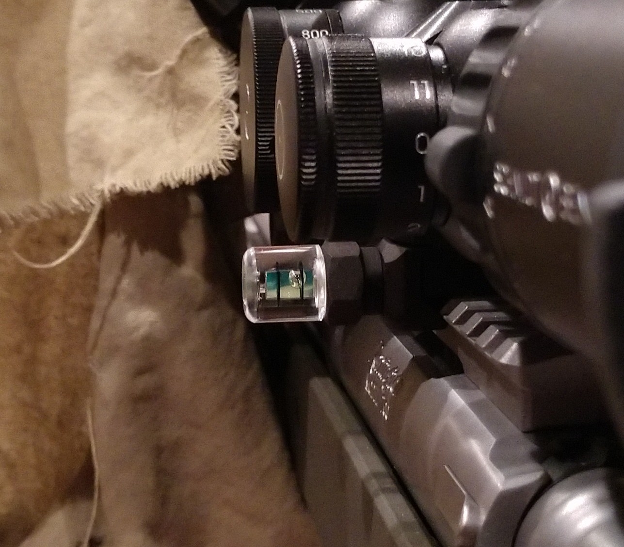

Also, I think you'll find the level in mine just as sensitive as a ceramic vial. Tested with an electronic level it is sensitive to under 1°even when cold.
Think about what this Photo shows you. Realy think about it.
This photo only shows me each level can be different. That is okay. As long as the one bubble you are using has been trued to you and your reticle and it can repeat its Level spot, its a good level. I know you hate them Frank, but some of us need/like them.
I can also do this with 4 different $200 building levels
Reactions: mi223
It's not that hate levels, it's much more nuanced than that ...
I don't like the fact people use them incorrectly
I don't like the fact people are paying over $100 for some
I don't like the fact, all the advocates that say, you NEED a level to successfully engage targets sell levels at inflated prices.
A properly set up and correctly used level is fine in my opinion, but this is akin to finding a unicorn with 99% of their owners.

Oh, c'mon... obviously that rail has some serious warpage going on. Nothing wrong with the levels! :ROFLMAO:
On a (slightly) more serious note, a quick-n-dirty way to check whether your level if okay or fubar is to swap it end for end 180°. If it shows the same amount of deflection in the same direction, then the level should be GTG. Otherwise, pitch / return it and get something better. Little harder to do with the levels we put on our scopes, with the contoured bodies and whatnot, but handy for checking whatever reference level you may be using to square up the gun prior to mounting the scope.

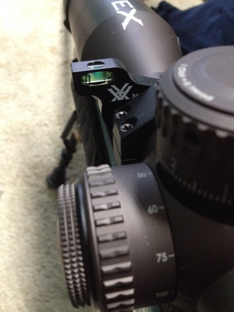

I use a Vortex LoPro. Not overly expensive and easy to install. Got it set so I can see it right over the parallax knob when behind the scope.

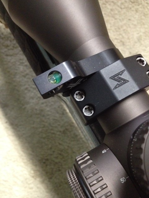

I’ve tested a few of my Spuhr mount built-in levels and they hold very true - unfortunately, to the rail only. Spuhr rings are so thick that there a very few options (if any - haven’t checked in a long time) for some scopes... S&B 5-25’s for instance. No real-estate left on the tube for them. Flatline’s are pretty popular among some users I have noticed.

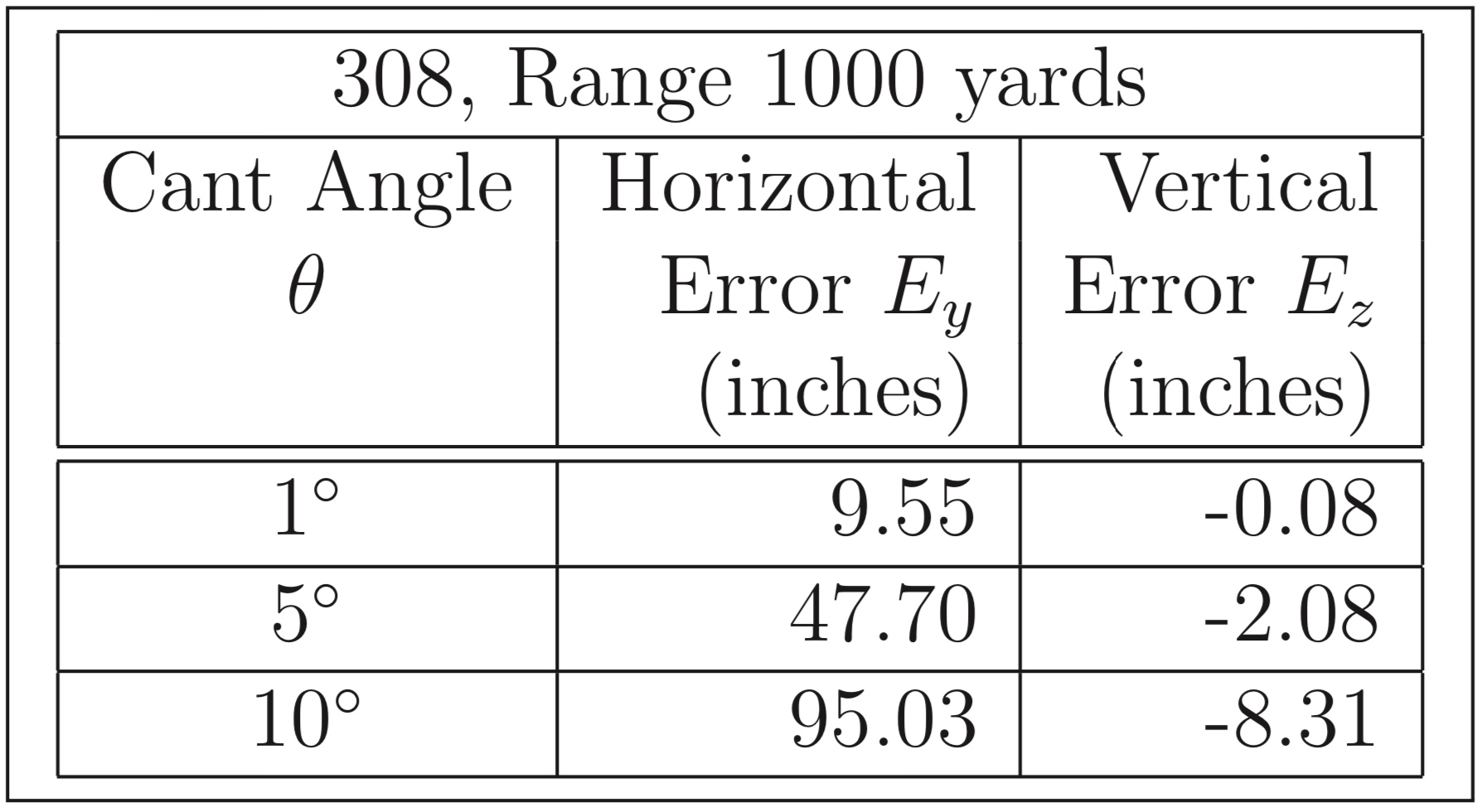

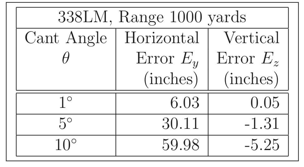

A good document on cant to check out is in the resources section: https://www.snipershide.com/shooting/resources/estimation-of-shot-error-due-to-rifle-cant.22/

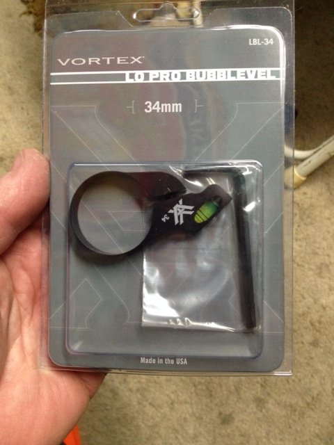

I have the cheaper $30 vortex bubble level on one of my rifles, and two of the $40 vortex lo-pro bubbles on others. I like the look of the lo-pro, but I also like the performance. It acts differently and the way the smaller bubble moves, it seems more precise. I can’t see myself spending more than $40, they both work well.
Damn, just picked one up on Labor Day and missed the deal. Oh well, very happy with your billet level, machining and finish are great. Checked every possible way I could think of and it appears to be about as consistent to the rail as I could possibly ask for. Would definitely recommend.

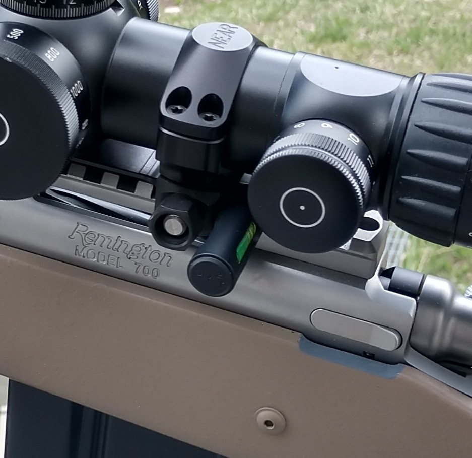

This is my favorite. High precision level vile installed inside a machined clear plastic body that screws onto the cross bolt of the mount. Made for the Near Alpha Mount.

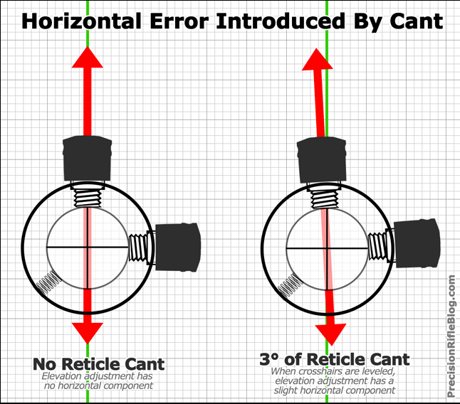

I personally do not use the reticle as a reference but the turret/the mechanical adjustment itself. Otherwise you will get a windage adjustment everytime you adjust for elevation if the reticle itself is canted inside the scope (within its tolerances, which can be up to 1° in my experience). Surely a small error but still.
And one of the issues that some face is that unless you have a stock with an adjustable butt plate you will not hold your rifle perfectly perpedicular to the horizon, almost all of us naturally cant the rifle to fit our shoulder pocket, so if you mount the scope so it is perfectly level to the action/base and you cant the rifle you've now caused the same issue and have a canted reticle. This is why I tend to prefer the scope mounted levels because they can be adjusted to the scope's reticle itself regardless of any cant introduced by the shooter.
You’ve got some bad construction levels if that’s the case. I always check my construction levels by putting them on a level surface and turning the level 180* and make sure it reads the same. Only one of your levels can be correct (or none) if they all read different in the exact same spot. There is only one “level”. It is not subjective or variable.
